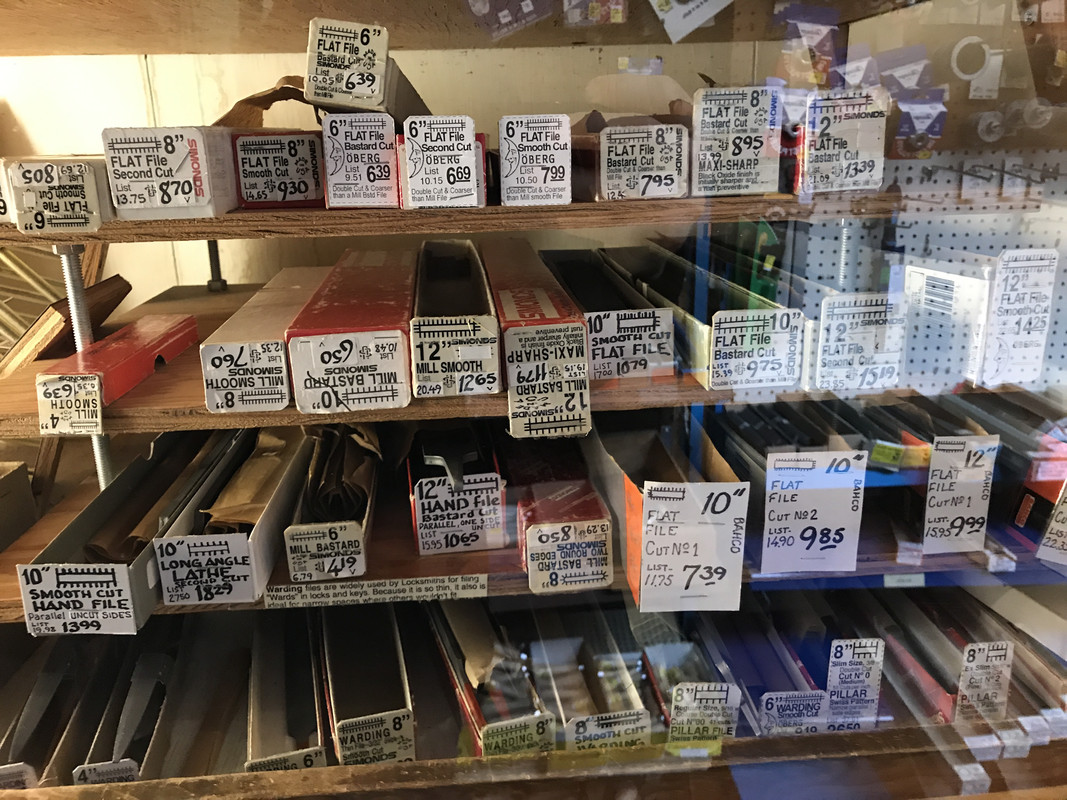

That is a cool file! I wanted to buy a metal file there too but was overwhelmed by the selection and did not know which one to get..?
Still

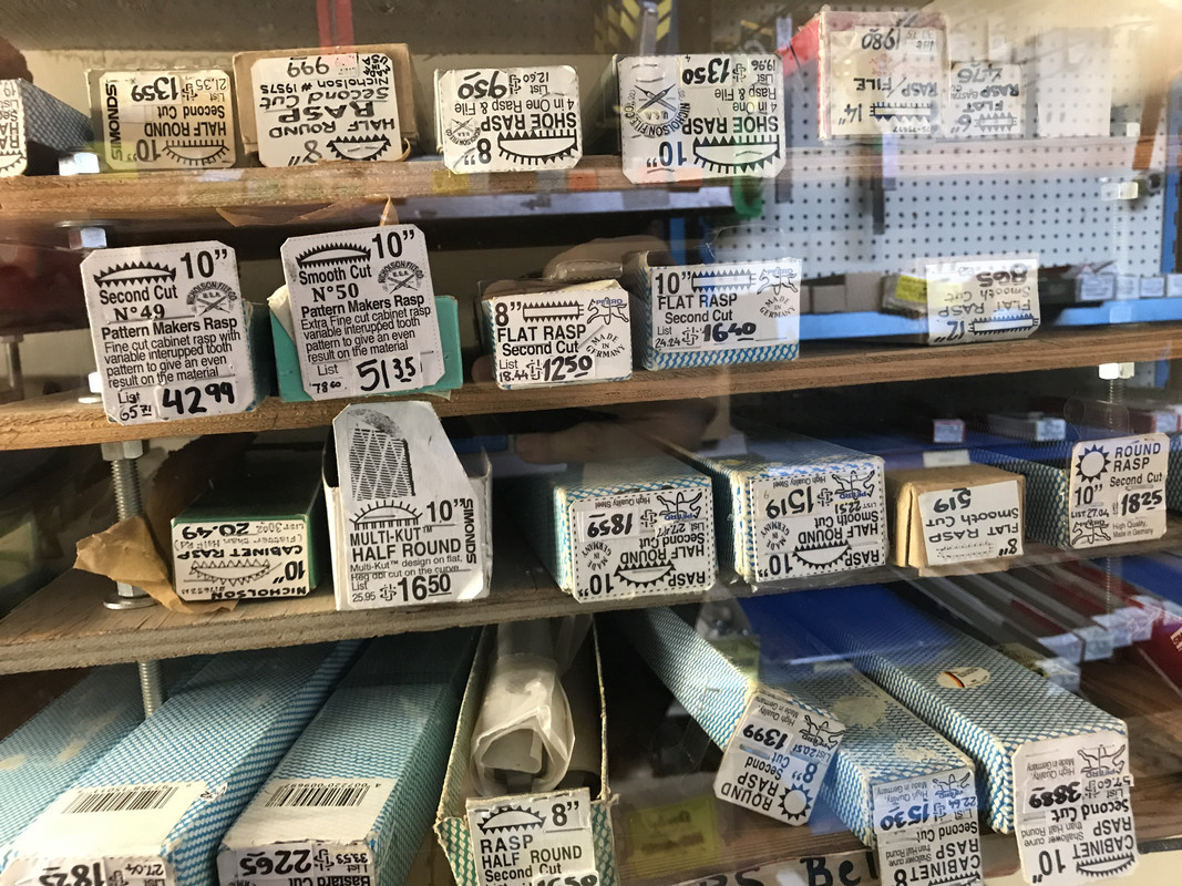

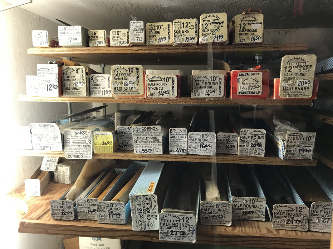

Not sure which one to get.. where did he pull the $55 file from? These all seem cheap, lots of Simond’s...
..oh. I didn’t even look at the lower shelves in that file case?!?
The one I got came from a box on the top shelf in your fourth picture. I just looked through things until I found something with a pretty aggressive tooth pattern. The expensive ones are in the locked case, lower shelf (your fifth picture).

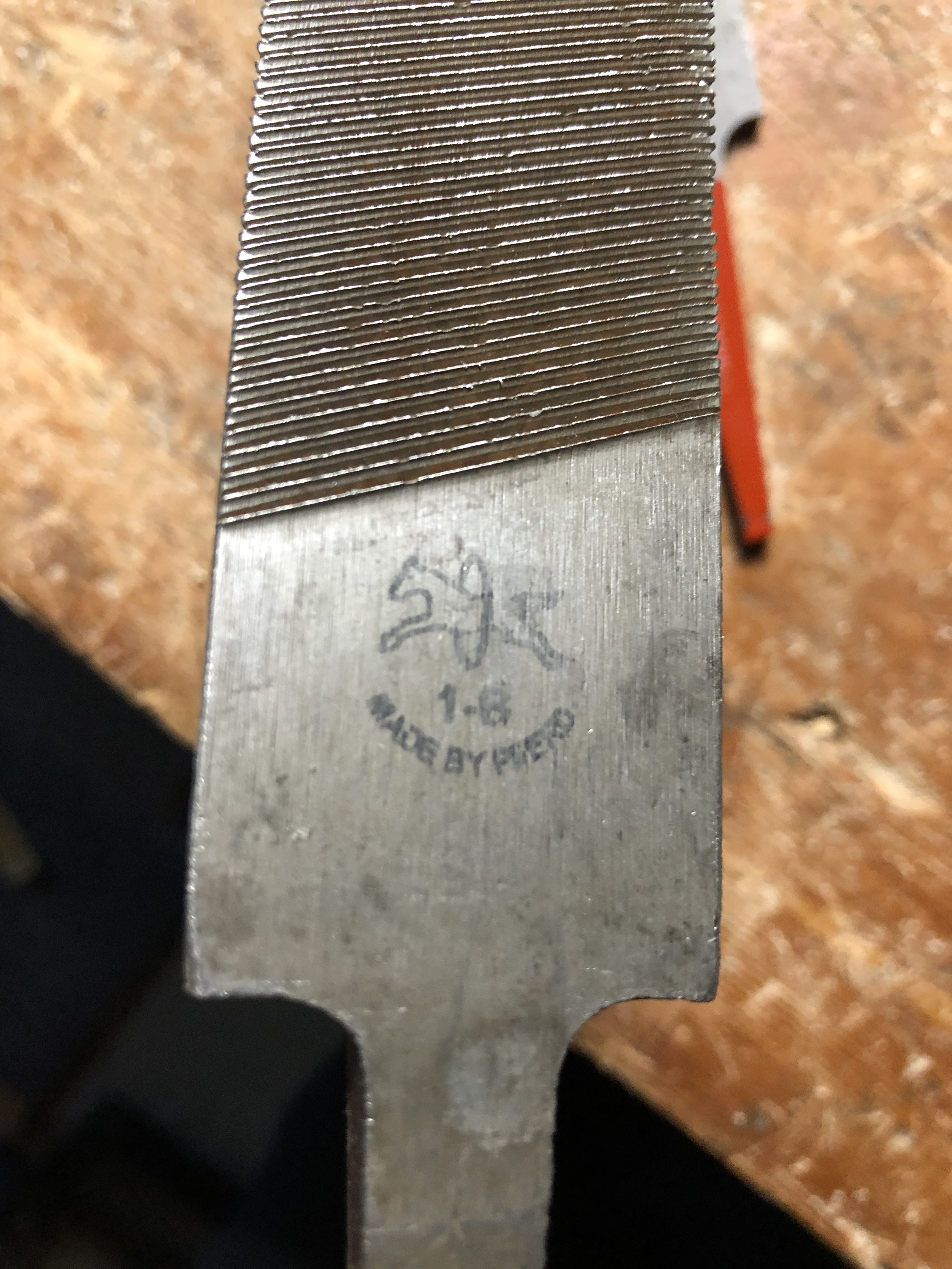

That blue/black handled file hanging is a Pferd utility file, so the $55 one might've been one of their corinox line.
Ahh it was Corinox. Down with the rasps.

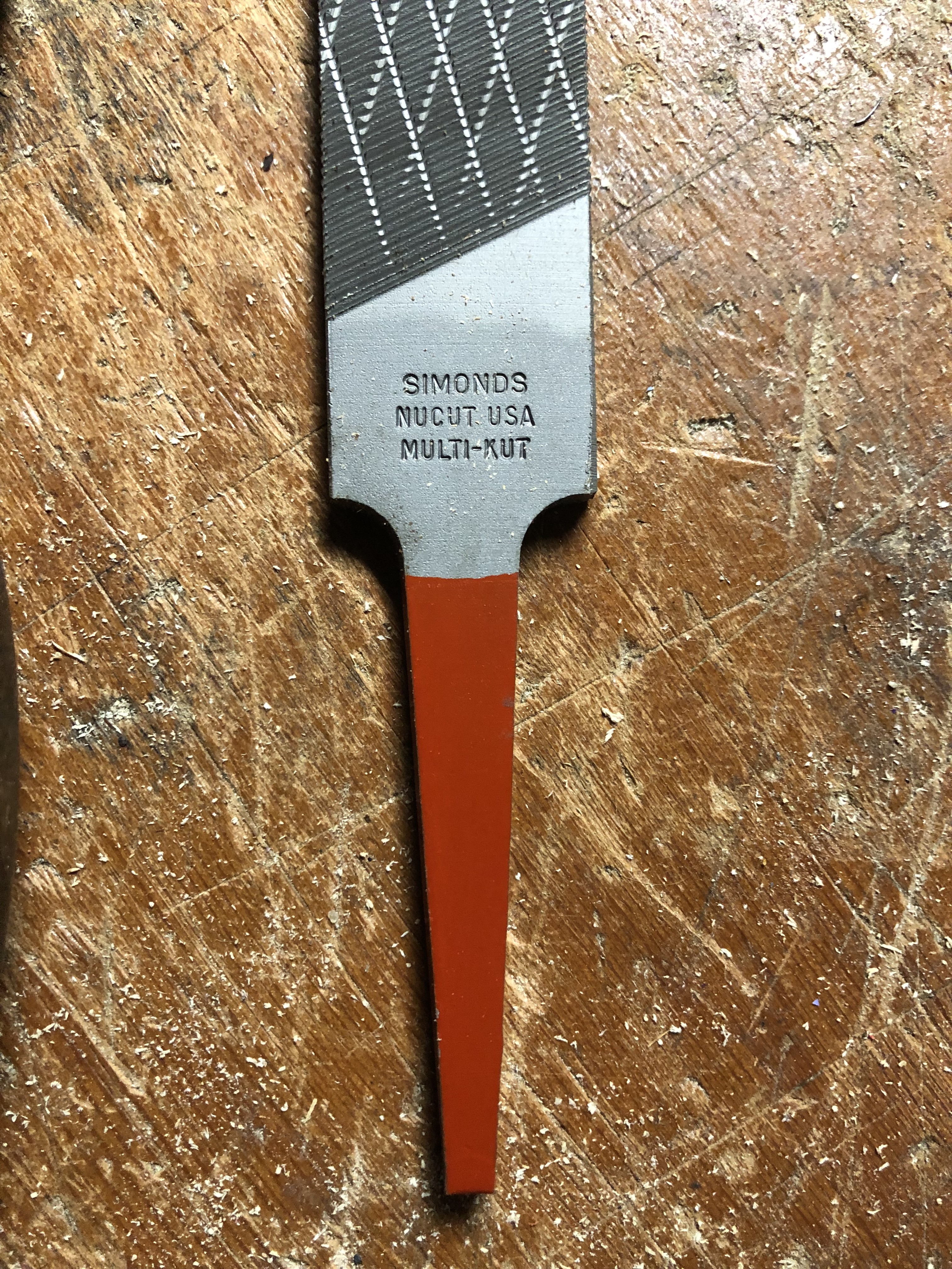

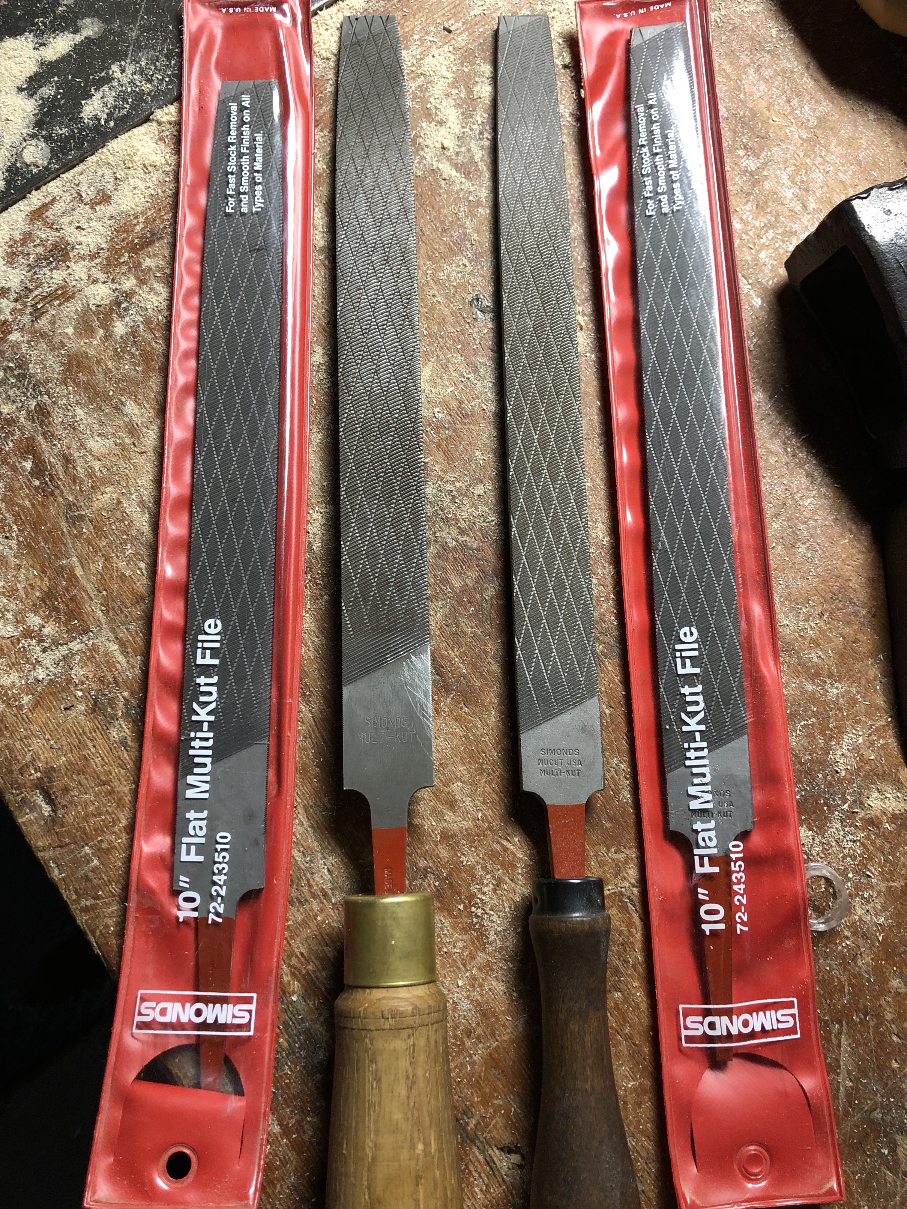

Since we are talking files, I think you need to try the Simonds Nu-Kut – they are amazing but get a look at the file itself. From all outward appearances they look the same but you will want the ones made in the USA. The two on the right are USA made (deeply stamped brand/origin/pattern on the heel) and those seem to last a long time while the two on the left are made in Honduras (lightly stamped brand/pattern on the heel, origin stamped on the tang) seem to wear out faster and skate over the area just worked with the American-made ones.

Also, if someone can id this 14” half-round Pferd pattern, I want another one ;)as it takes off mushrooming-sets and chows out new profiles on worn axes quickly:
I need to try those out! Tell me, it looks like the part numbers are the same? Is the only way to make sure you're getting a USA made to actually have it in hand?
