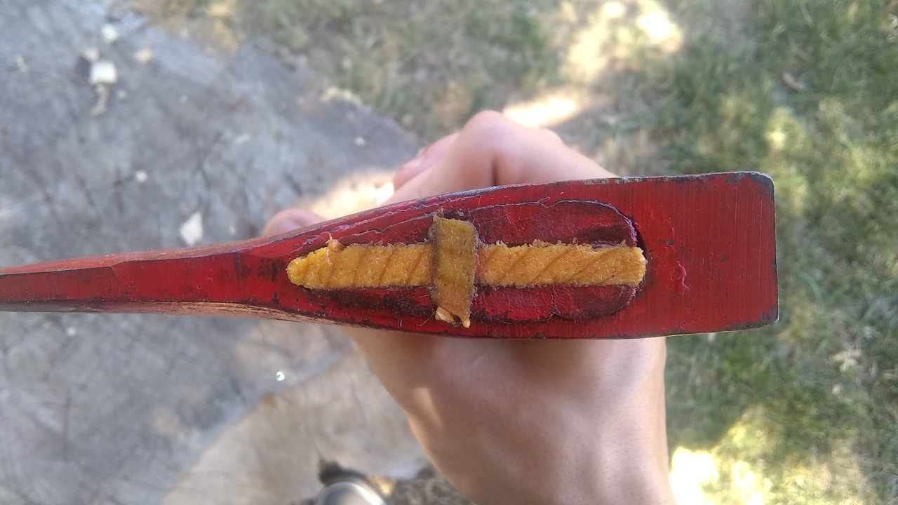

Last night I re-wedged the Woodslasher because it was pretty apparent that the BLO alone wasn't going to be enough, then let the head sit in a tray of BLO overnight.
I had to get creative, because I could not get the wedge in much without driving the head out no matter what I did.
Finally my solution was to stand the axe up on a piece of 2x4 and hold the head tightly down using a piece of rope with a foot loop in each end.
I was able to get the wedge in much further but not as much as I'd like so I chiseled in a spot for a cross wedge.
I'm still not positive that it's as tight as it really needs to be, but I didn't want to get too crazy and really just the fawns foot up.

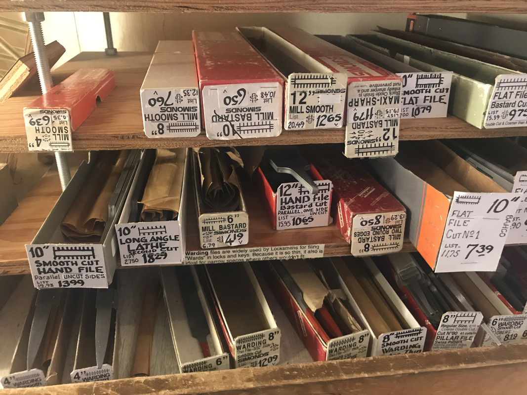

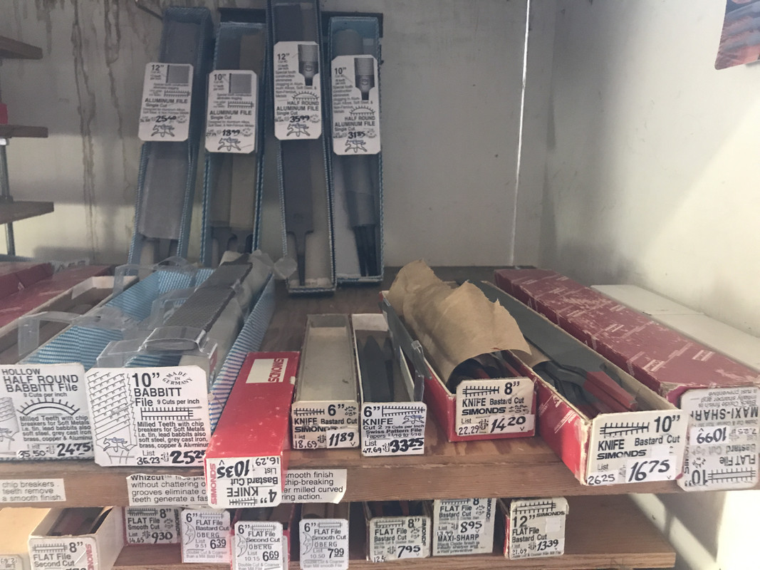

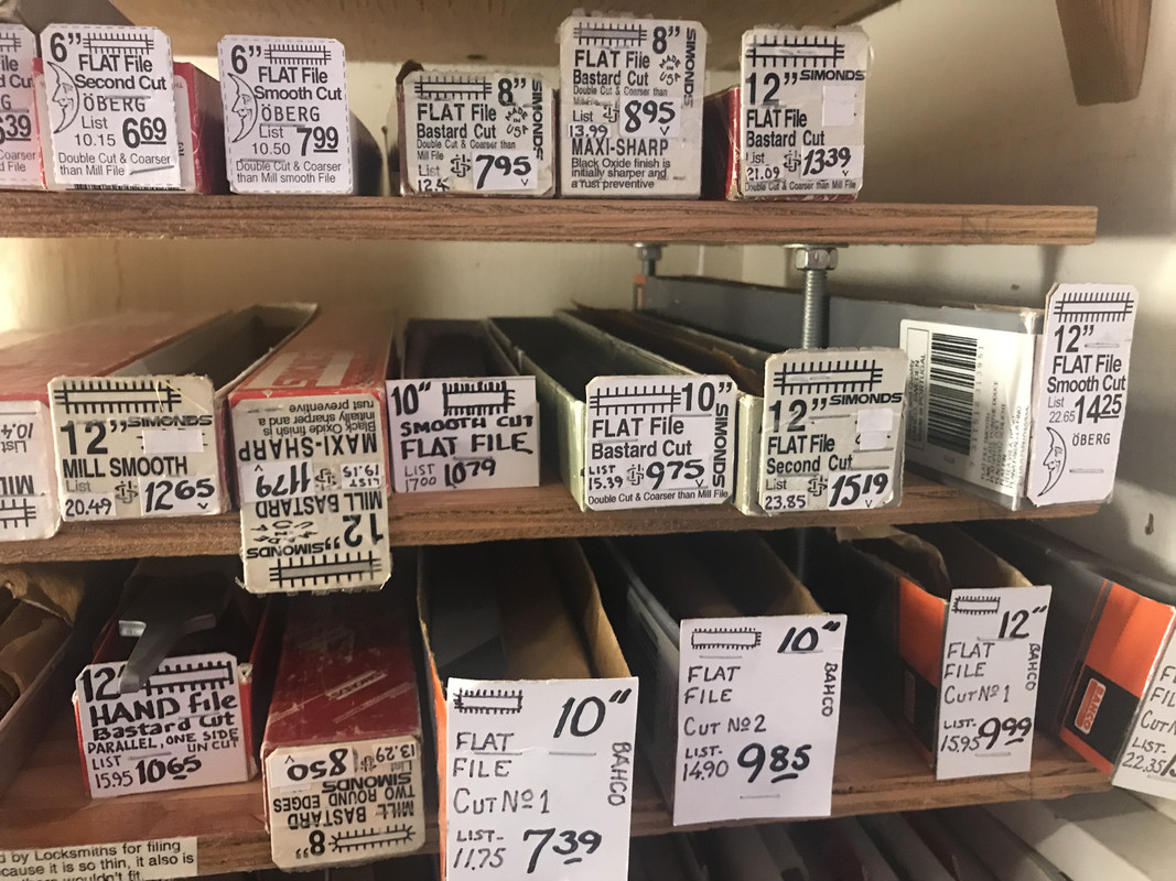

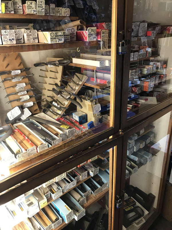

That is a cool file! I wanted to buy a metal file there too but was overwhelmed by the selection and did not know which one to get..?
Still
Not sure which one to get.. where did he pull the $55 file from? These all seem cheap, lots of Simond’s...
..oh. I didn’t even look at the lower shelves in that file case?!?
