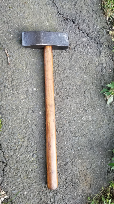

I finally finished this handle for my father's maul the other day and rehung it. He bought it in the 80s when they bought their house and they're heated almost exclusively with wood since then. The maul has done a lot of splitting over the years. A couple years back someone bought him a fiskars splitting axe, and the maul has been relegated to sledge hammer duties ever since. The edge was completely dull so I took it to the bench grinder then the belt sander, with frequent water dips in between passes. I didn't go any further than a smooth file. I used hophornbeam and although it can be a bit of a pain to work with it makes a very strong handle. I like being able to see that there are probably 30-40 growth rings that run from the knob into the eye. The overall length is about 34" and it was wedged with yellow birch.
That is an excellent job! A beautifully made haft and superb choice of wood. I've mentioned it before but my uncle is woodcutter. He's of the type of tough grizzled men that give Maine woodsman their reputation for being hard workers. He broke his leg a few years back and had a metal rod inserted. He broke the damn rod 3 separate times! Haha. Frigging guy! Finally the doctor told him he wouldn't put another in so he had to be careful. So far so good. Anyway the point of that diatribe is that he will only use hophornbeam for axe and maul handles. You can imagine if he does that to his own leg how axe handles fair around him! :confused:

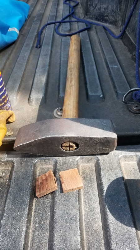

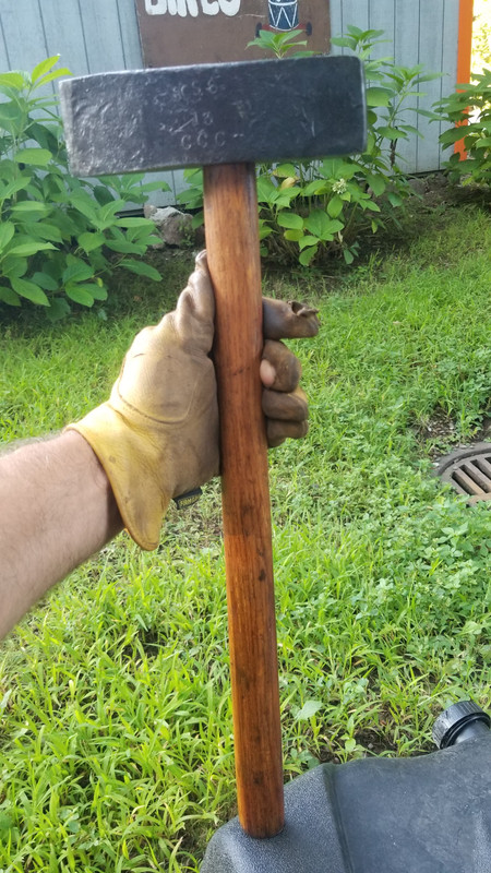

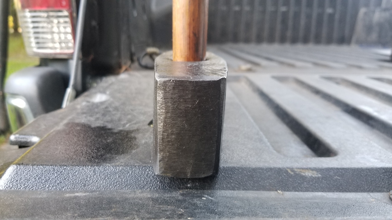

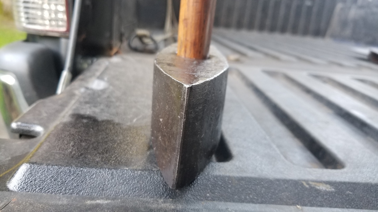

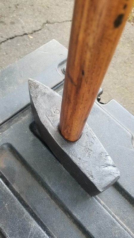

6lb Spalling Hammer

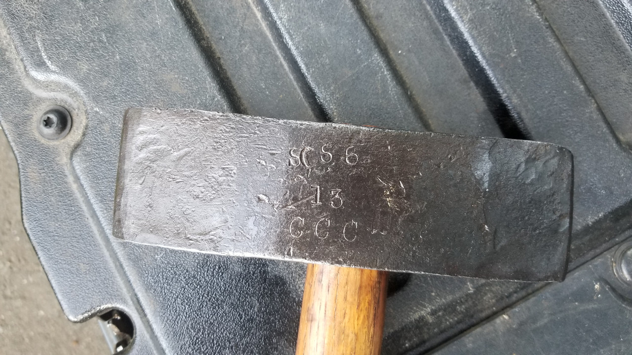

CCC Civilian Conservation Corps No 13
SCS 6

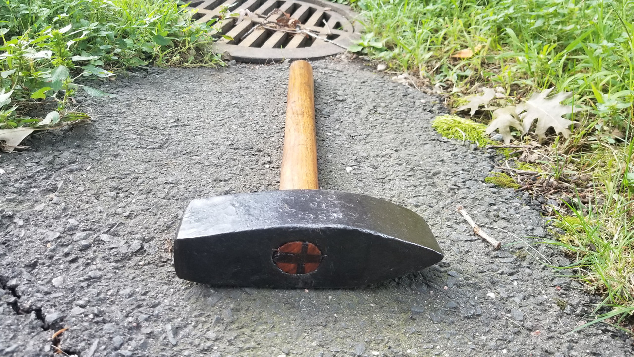

I rehung the Iron City on this 23" hickory i had salvaged prior.
Now @
22 3/4"
6 3/4lbs.
Super additions to my hoard...i mean collection

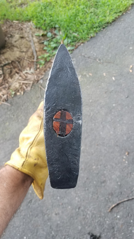

I hung the Connecticut pattern legitimus after work today. Filed and honed it last night. I ended up filing off exactly .5oz of steel so it now weighs #3-11oz.

This yellow birch wedge didn't go in as far as normal. But it's doing its job very well anyway.
Pretty hard to beat a connie for looks in my opinion. This Salem handle co. helve is thin. VERY thin! Fortunately this axe has a slender enough eye to work on it.
All in all I'm pleased with how it turned out. That makes 4 I own in this pattern. I'm afraid that number will just grow and grow and grow.... I hope so!!! ;):D:thumbsup:
