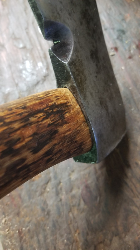

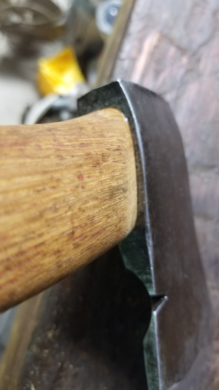

I hung the Connecticut pattern legitimus after work today. Filed and honed it last night. I ended up filing off exactly .5oz of steel so it now weighs #3-11oz.
A couple photos before final hang;

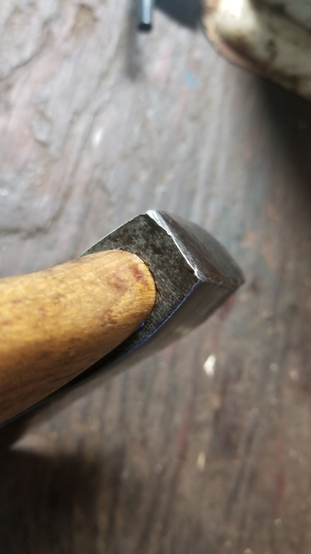

This yellow birch wedge didn't go in as far as normal. But it's doing its job very well anyway.

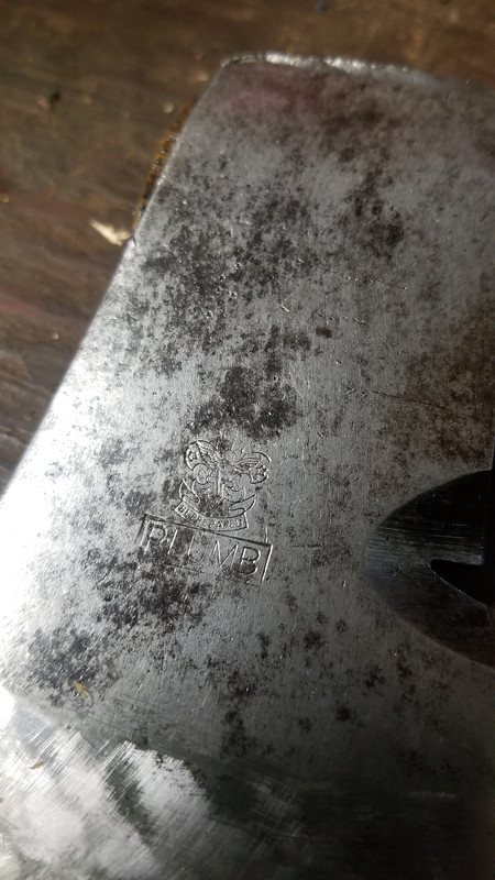

You never let me down when you post and this is no exception.
The crown & hammer with Legitimus underneath so crisp and legible/recognizable.

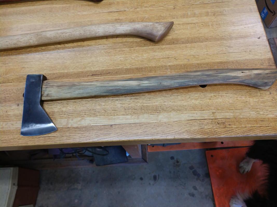

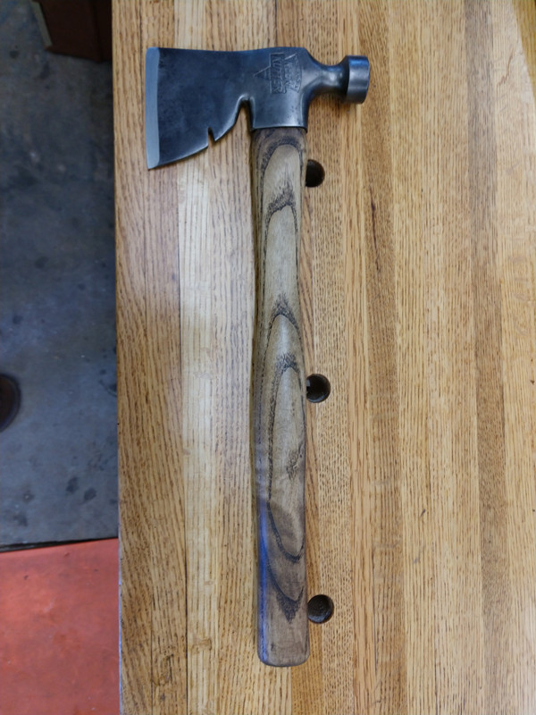

Here are the latest I've put handles in. First is a plumb Rockaway I was lucky enough to get of eBay for $36.

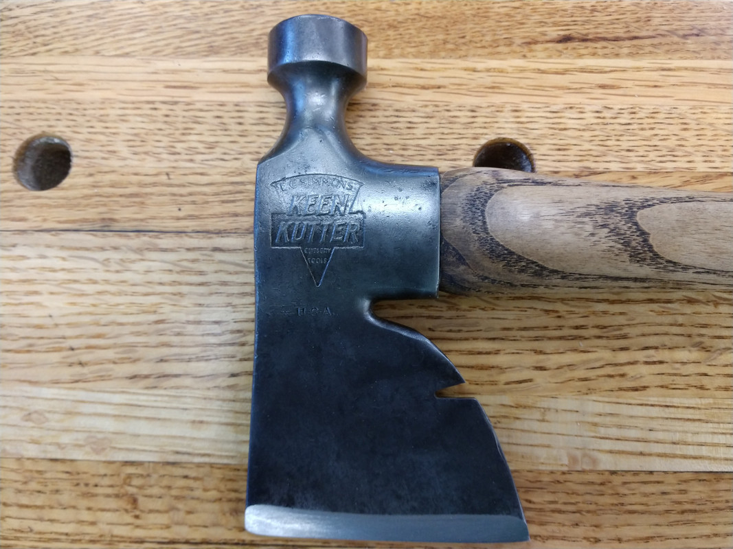

Next is a little keen kutter half hatchet I picked up. This handle proved to be more difficult to get shaped than any of the axe handles I've made. It is made from ash.

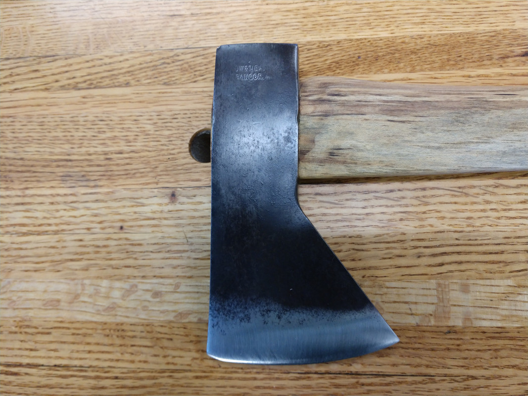

Last one is a Snow & Nealy I put a handle on.
Made a handle for this one that is 25".

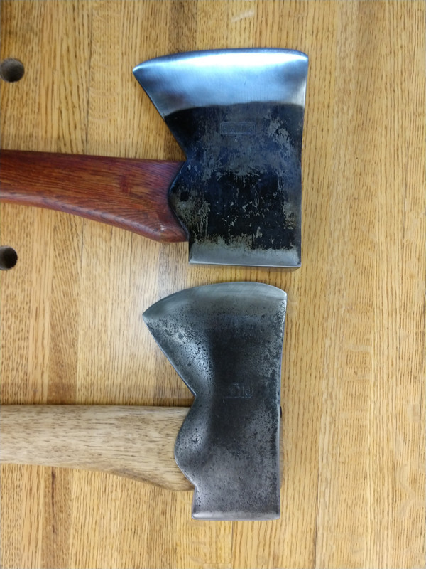

You know, there was recently some discussion surrounding what I thought was a Rockaway and that bottom line from the lug to the heel. Could this be a Jersey with Plumb’s rounded lugs?
Here is a picture of the plumb Rockaway pattern with what I consider a round lug jersey pattern plumb pictured on top. I see the plumb jersey pictured on top listed as a Rockaway all the time. The plumb pictured on bottom is a Rockaway.

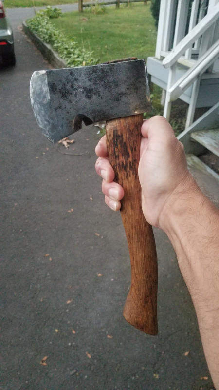

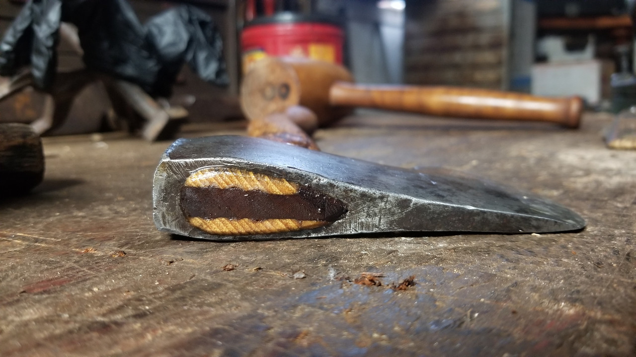

I decided to leave the Van Camp bare steel. And I've been saving this 30" craftsman haft for some time now.

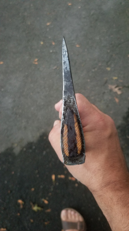

The swell on this one really wanted to splinter. But I saved the pieces and will glue em back on this evening. Excellent grain alignment and very little runout.
Here's a before and after. Some of these craftsman came hung with a thin steel step wedge from the factory. I was able to fill in the entire gap with a little love and my 3lb sledge...
