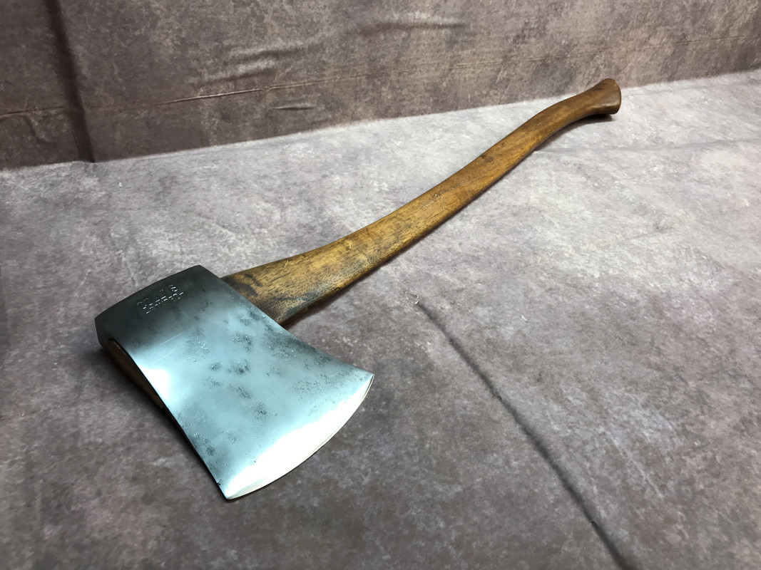

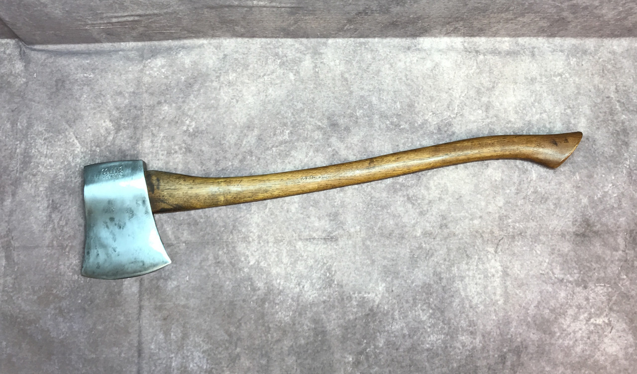

Josh, The Van Camp looks more massive with the haft in place. I really looks wonderful! You know every time you use that axe you are going to want some pork & beans ... right?
Thank you! Yes pork n' beans. Lol.
That thing looks fantastic, what a great grind! Who made them? I'll have to look it up. That's a really beautiful axe.
And thank you as well! Kelly made this one. I'm not sure if VC always used Kelly but this one is. Overlaid bit and a clear temper line as well. That's what made my mind up about whether or not to blue it. I so enjoy seeing the different steels that I decided to leave it alone. Even though it's stamped 3 2 it weighs #3-12.1oz now. Measures 7-1/4" x 5-1/4".

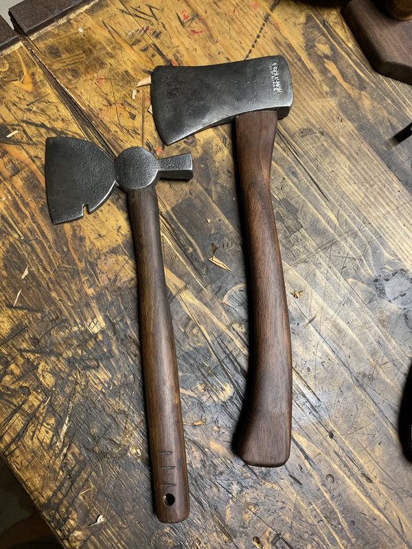

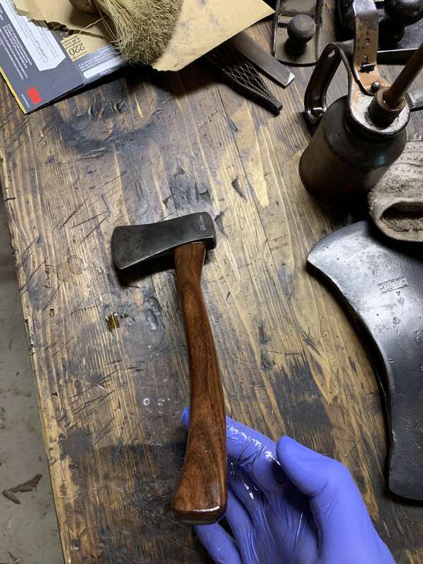

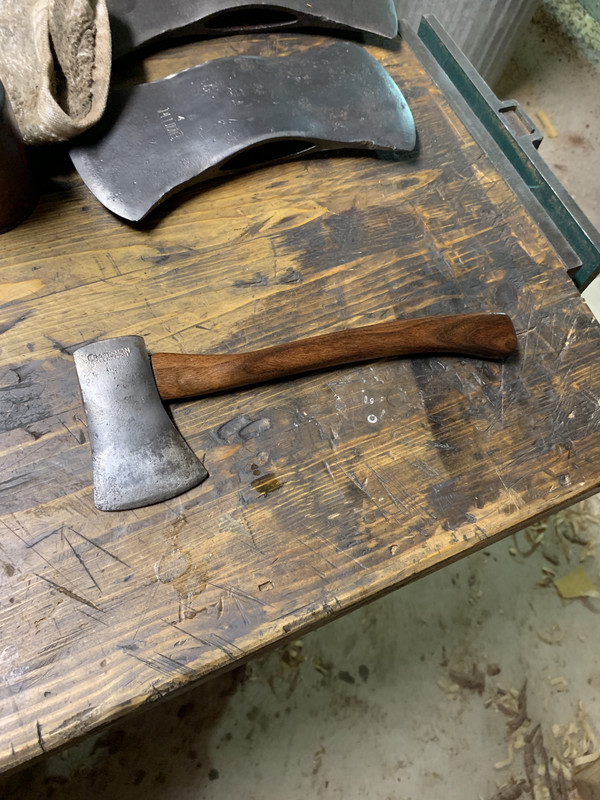

These two axes came from Mr. Meek, who saw my interest in them and generously sent them to me! You can see the before in his “It followed me home” post. He will be receiving a surprise very soon! The craftsman did not have a handle so I used some black walnut to make one. It is not ideal handle material at all but it will be fine for this little guy! Then I wedged it with some white oak. The other small hatchet had a very nice oak handle already so I scraped it oiled it and waxed it after hanging! I love these little guys and they will have a permanent place in my collection! Thank you so much Meek1. I hope you enjoy yours when it comes in!! Thanks for looking!!
Outstanding! You did well by them! They sure cleaned up nice. I love that handle you made for the craftsman!

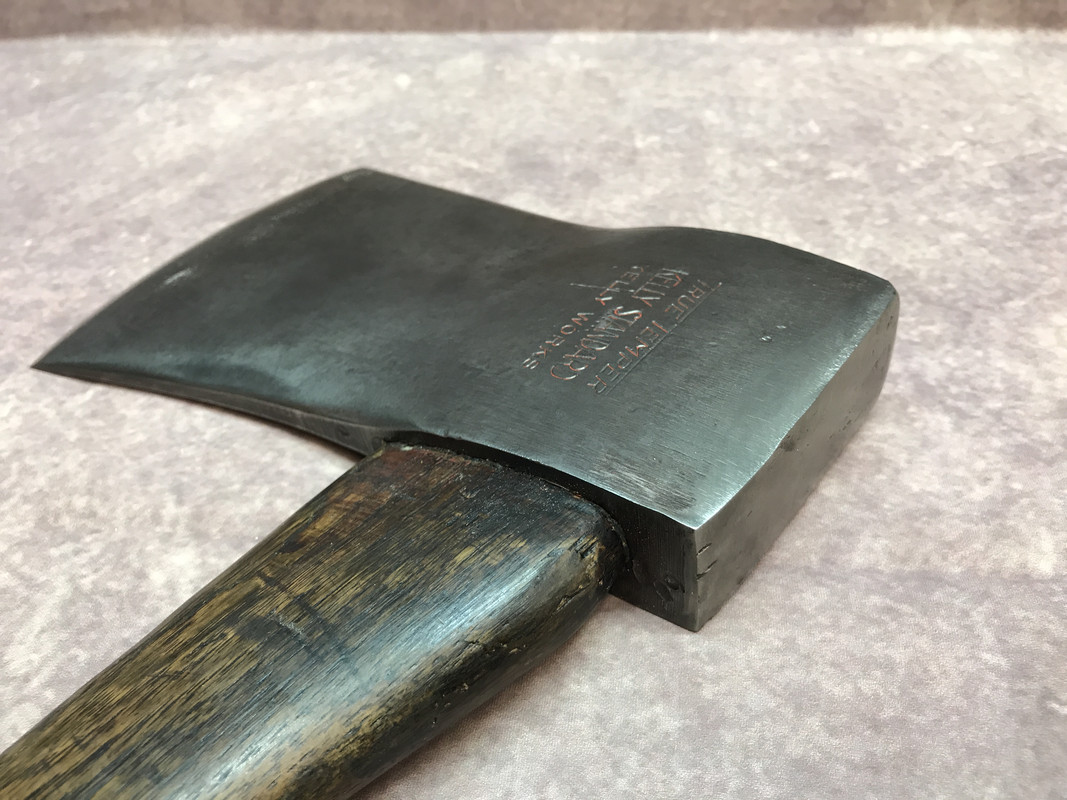

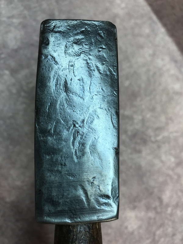

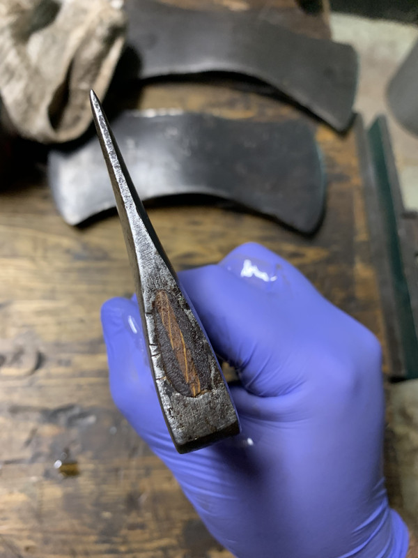

Anyway here's some of the Mann-Knot Klipper hung on a 28" "empire" haft I've been saving for several years awaiting the right head.
3/4" + of contact on the bottom of the eye.
Between the depth I got with the wedge and the contact on the bottom of the eye there is very little inside that eye that doesn't have pressure and contact on the inside. Good stuff! 20190916_170559.jpg

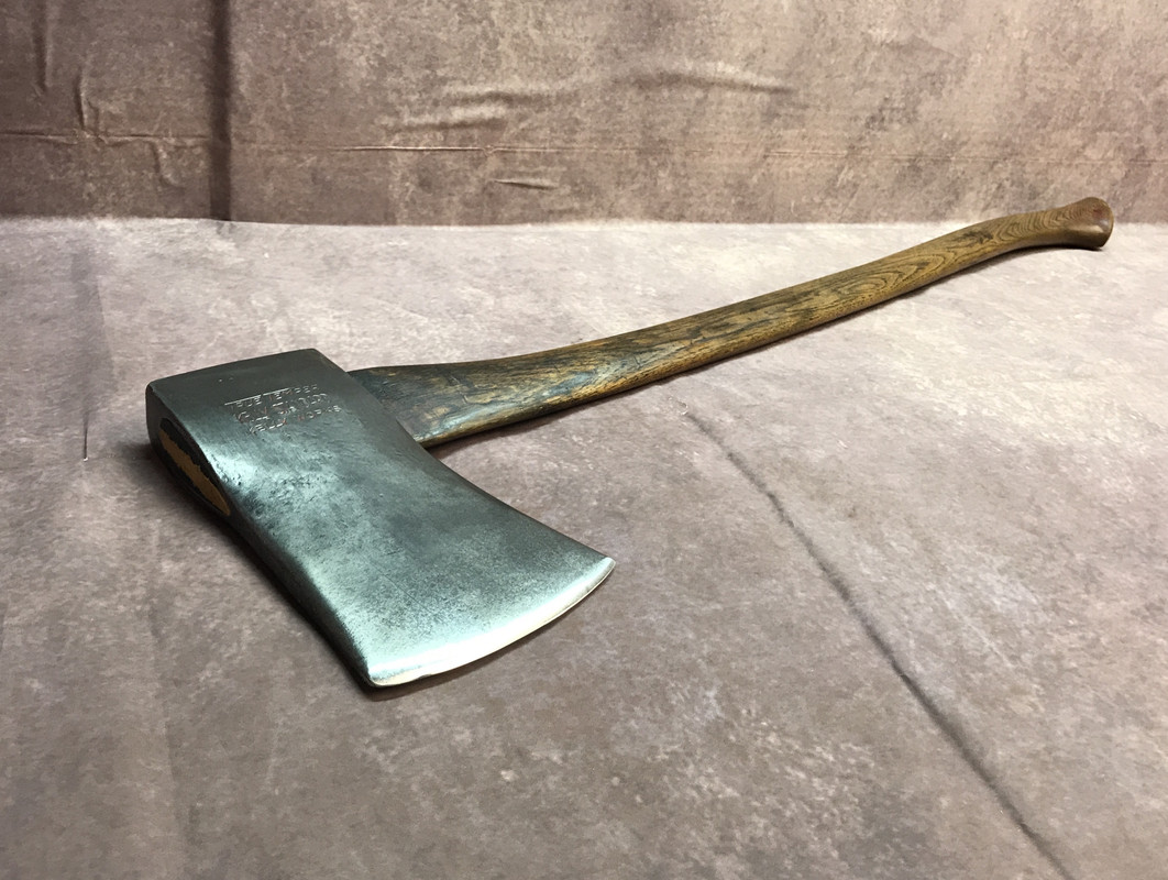

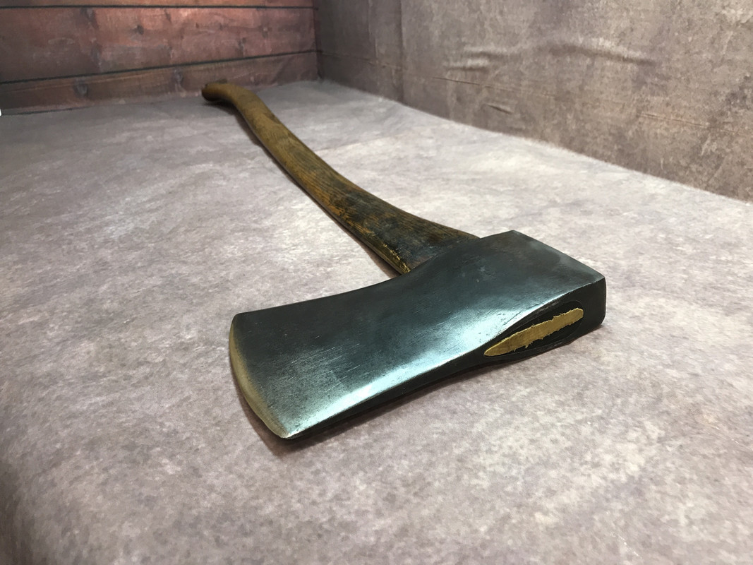

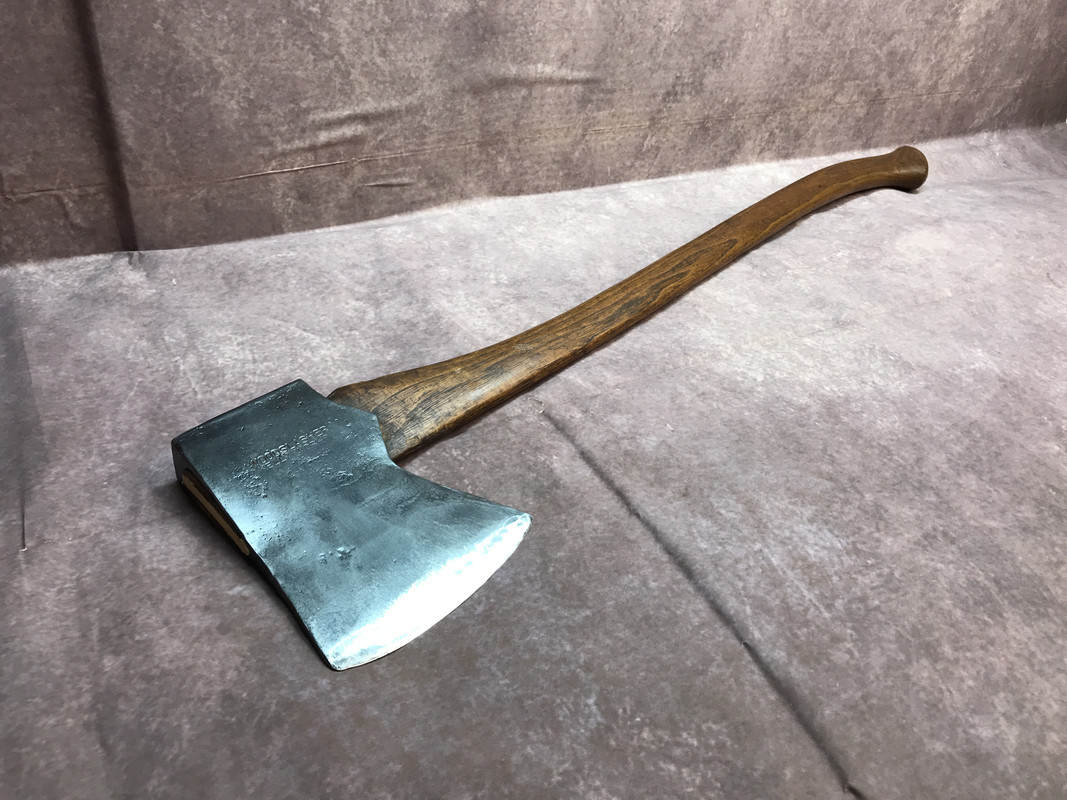

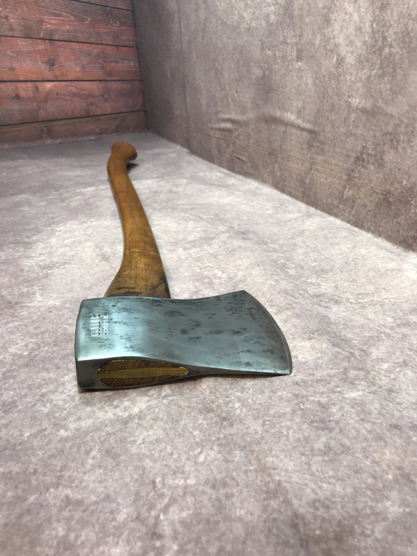

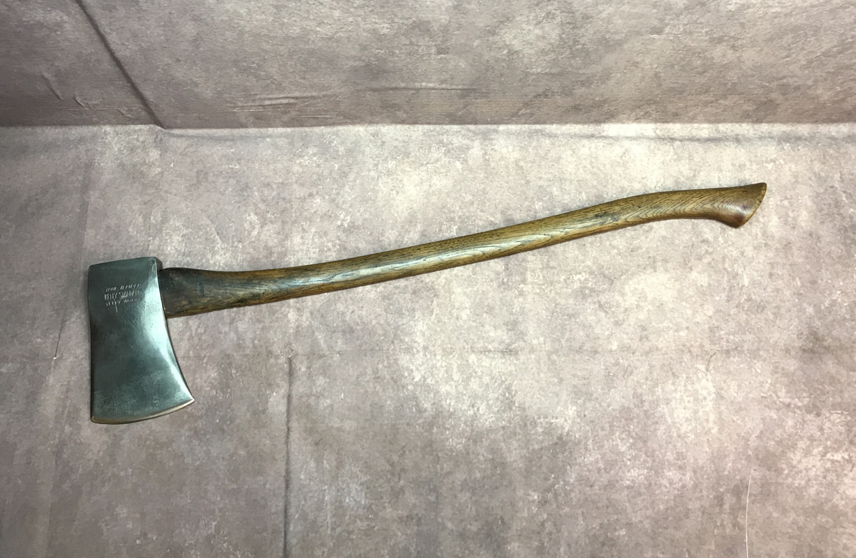

And the normal pics;
The swell on this helve is large for being on a small handle. It's so easy to hang on to.
It measures 6-1/2" x 5-1/8" and weighs #2-15.4oz. Thanks for looking!

Heck no, I like all the pictures. It lets me know how it is suppose to look. Once again you have done an excellent job! Thank you for sharing!

To answer your question, when it comes to photographs ... the more the merrier! I am impressed with your photographs Josh, amazing depth of field even on your close up shots! Which causes me to wonder what camera you are using? As for the axe handle work, I would say you have the the hang of it. Pun intended. You can't go wrong with a name like Knot Clipper ... ooops ... Knot Klipper!

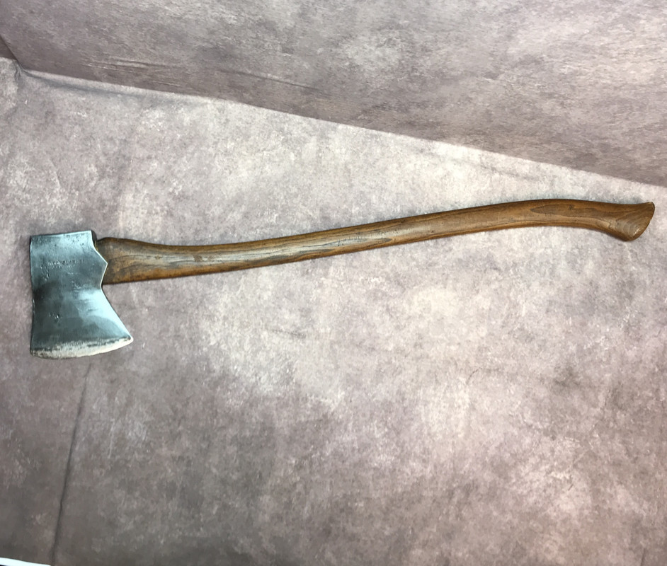

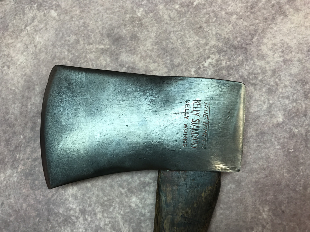

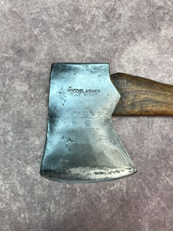

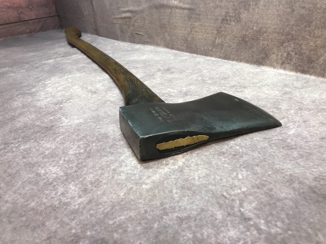

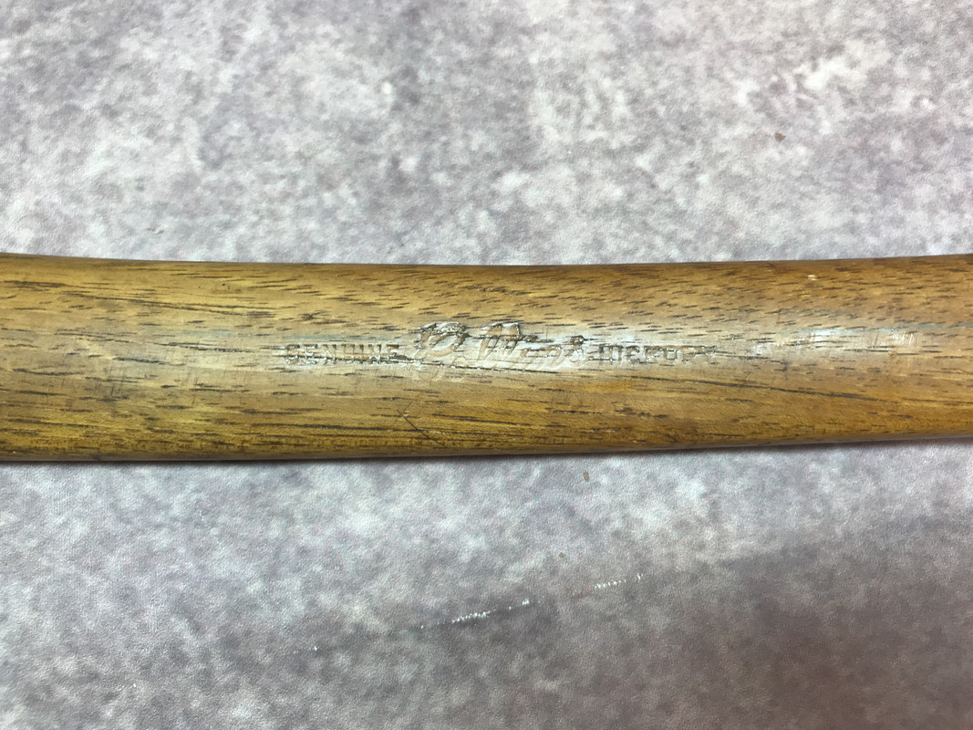

Finally found time to reuniting some heads and hafts that were sitting around the shop.

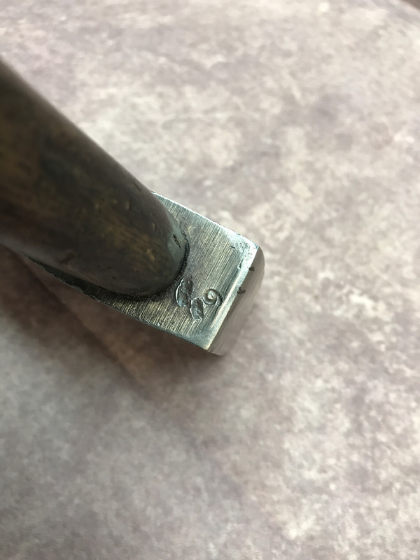

This Collins-Bonded was painted black when I got it. But there were no surprises underneath the paint and it cleaned up great. I didn’t do anything to the original stick.
Didn’t want to wipe out the 3 stamp cleaning up the poll too much.
