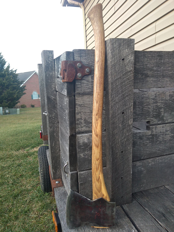

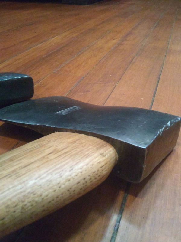

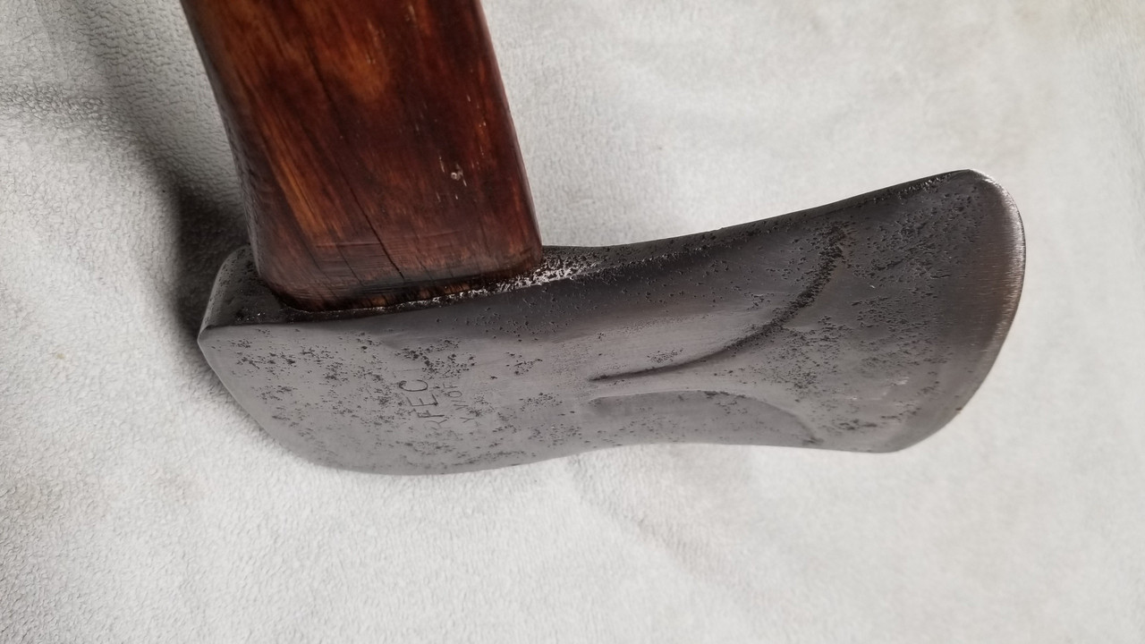

I finally got around to hanging this Vaughn tropical axe I recieved from a trade with F FLINT77 . Hung with a yellow birch wedge on a 29" Hartwell brothers "utility" haft. I filed one bit keen to 22° and the other to around 27.5°. Both nice and convex and polished.
Here's the keen bit;
And the stunt bit;
Started masks for it last evening;
I'm very happy with the axe! They seem to be pretty rare. Can't find any others nor any info on them. I recall seeing an ad before but I can't for the life of me find it again! Would one of you be kind enough to post an ad for this axe if you've got it somewhere? Thanks guys! Take care!
Looks awesome man! Can't wait to see it with the black mask, it will really pop. Nice job! Hope you find some more for comparison!

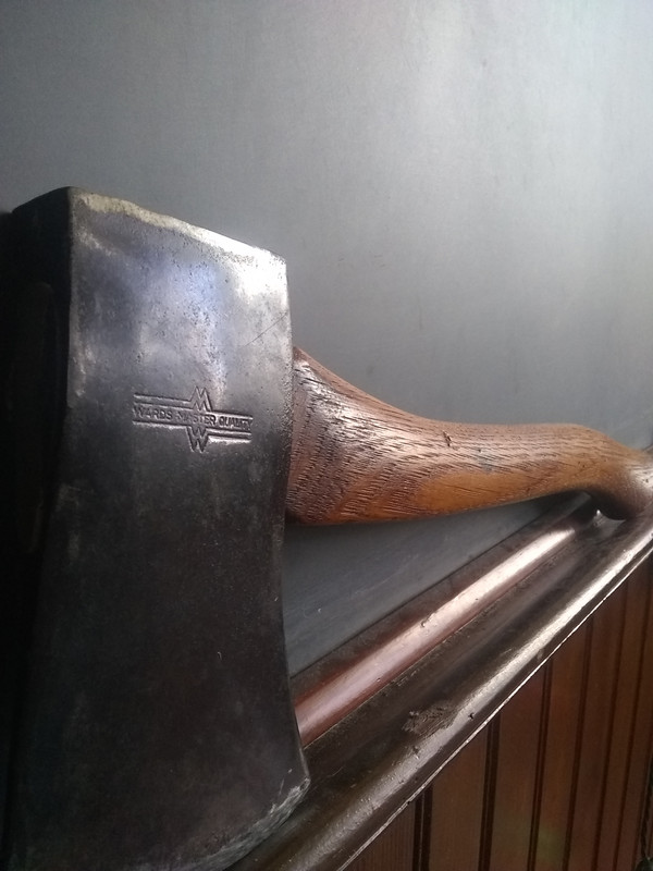

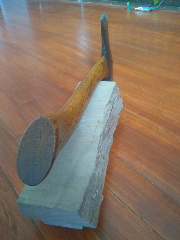

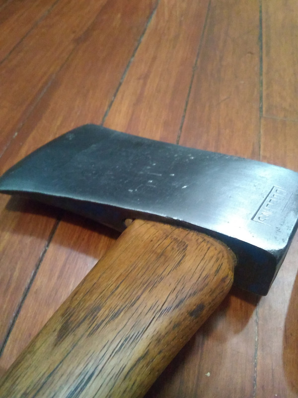

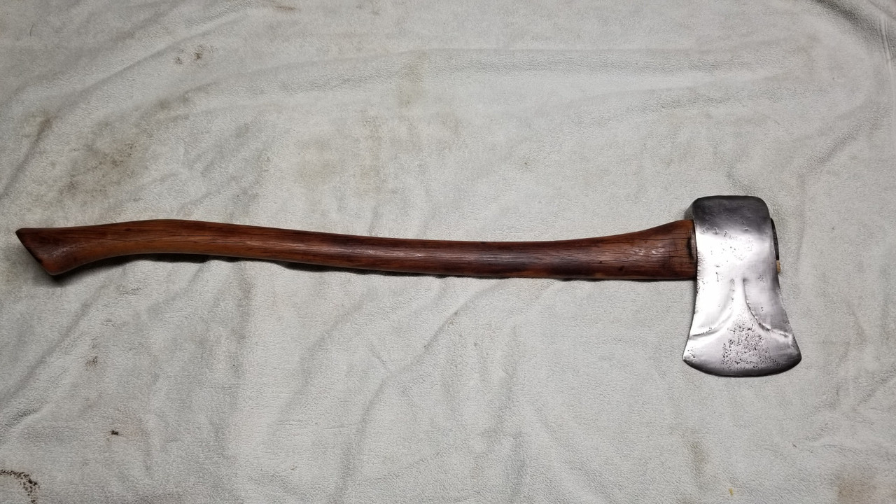

Finished this Wards Master Quality yesterday finally. I picked it up at an auction a few weeks ago. It's a beast! 2 lb. 10oz total, at 17.5" OAL. If the handle wouldn't have been in such wonderful condition I'd have hung it on a 26-28" haft. But I LOVE this handle which appears original to me. It's in really good condition. I used some steel wool to pop the grain, and gave it some coats of BLO followed by a couple coats of a citrus beeswax. Rehung with a poplar wedge, and used just a little wood filler inside the tongue where a metal wedge had done some damage. I'm happy with the results. Still need to do a final honing on the bit. No filing needed on this one! Here are some poser pics.

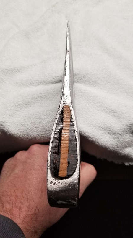

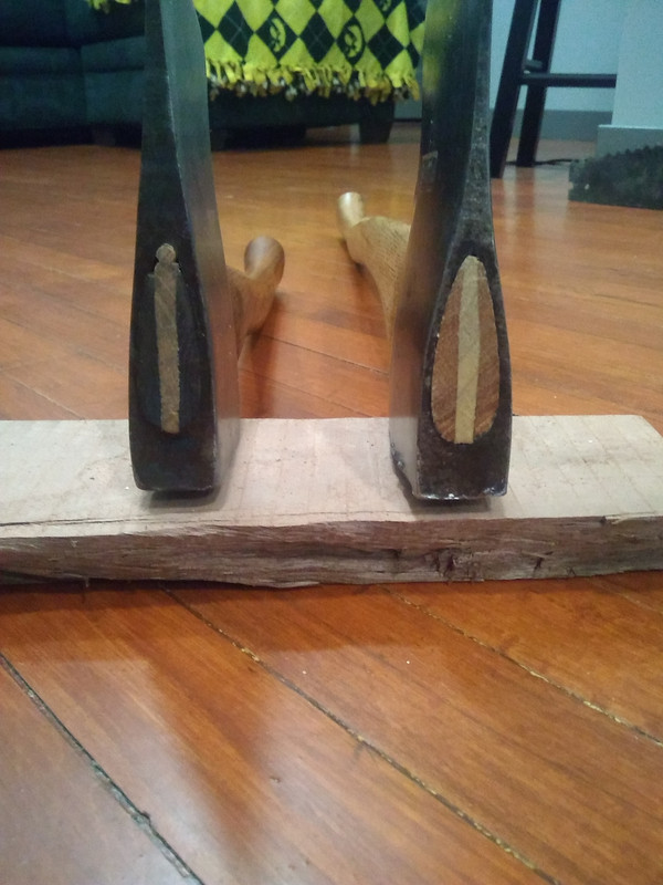

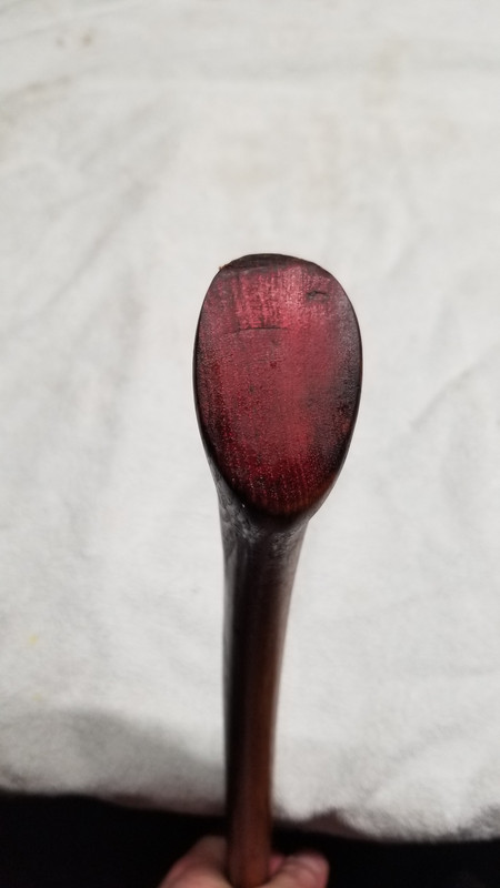

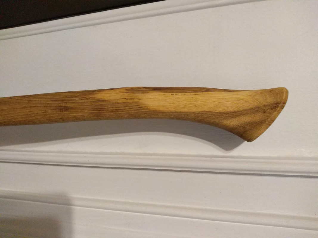

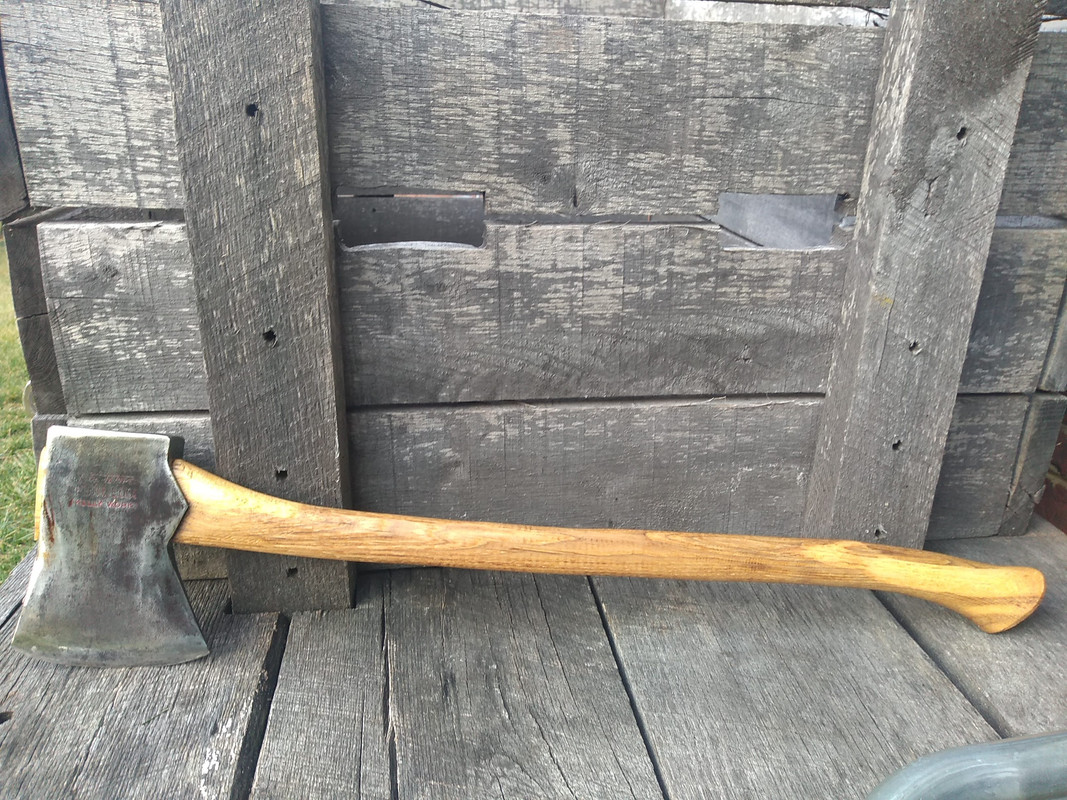

ReHung my 4lb Flint Edge Jersey today. The original hang was with a house handle with a weirdly constricted grip and tiny swell, so I pulled the head and rehung it on a decent 32" link handle. Shaved it down fairly slim, hung the head on pretty low and solid and spent some time getting the grip/swell right. Got it all coated with my Tung/Citrus/Tar mix and now drying in the living room which my wife loves (NOT!!). The wood in this handle has a good amount to color to it, but there are some light splotches in it as well. Final length 31", total weight 4lbs 13oz.
Sexy AF! Really nice looking pair man!
Seeing that utility trailer gives me pangs for that Homestead/Adirondack axe I missed out on! Lol. Can't get 'em all!
Great job with your hang though. Jerseys are great looking axes. Especially when hung right!
Dang, your link handles look way nicer than the ones I have found. Nice job on the swell! That 4 lbs head looks massive. Great job!!

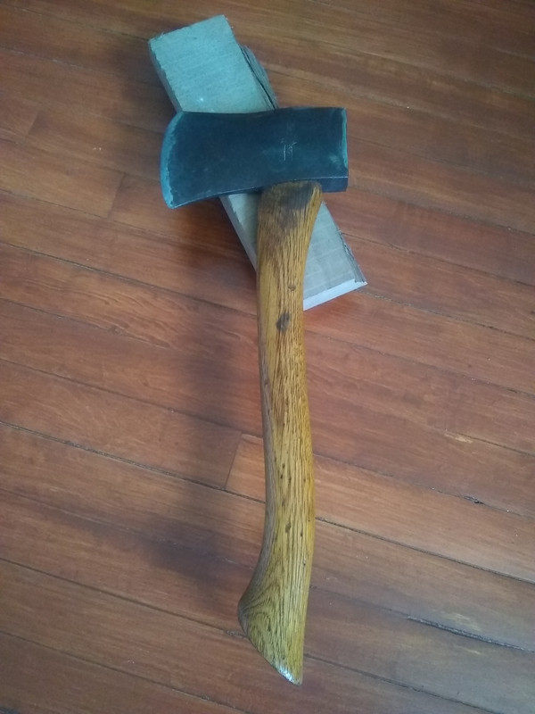

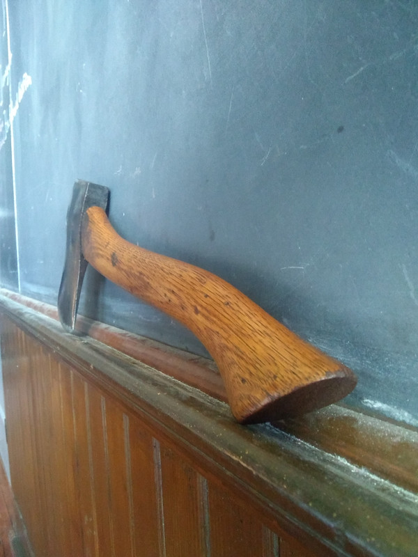

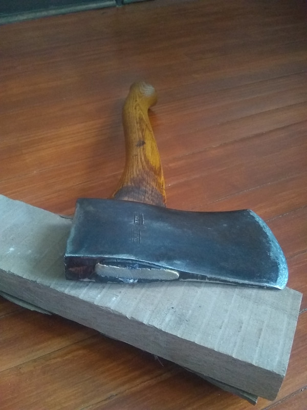

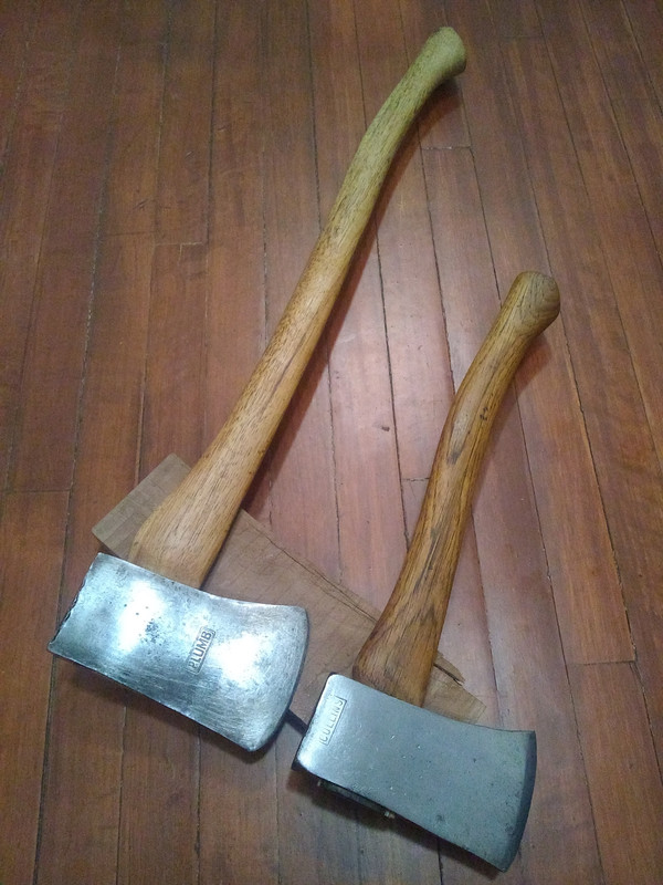

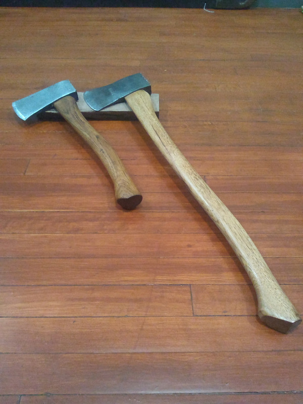

Got 2 projects finished up today. Collins 1-3/4lb hatchet on original handle (17" OAL), and a 2-1/4lb Plumb on the handle it was on when I got it, had a sticker on it, older looking, no bar code, some company out of Ohio I couldn't quite make out the name (27.5" OAL). Super happy with how the Plumb turned out, and the Collins I feel I could have spent more time shaping the dowel I used to soak up the gap in the front. Both are fully seated on bottom of eye, nice and tight, nice and straight. I think I'm starting to get the "hang" of this! At any rate, I'm addicted and loving every minute of it!
