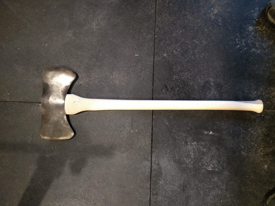

Just spent 2 hours working on a double bit handle. Got it from house and it was super super fat. literally like a handle blank. I spent forever filing and sanding on it until I got it slimmed down pretty good, and then started to hang the head, but somehow got the handle stuck in the head and can't get it out. :( I've never gotten a handle stuck in the head before.
this is my first double bit hang attempt and it sucked. I'm depressed. the whole garage is covered in saw dust, my shoulder hurts, and the handle is stuck most of the way in the head and I can't get it to budge. :( :(

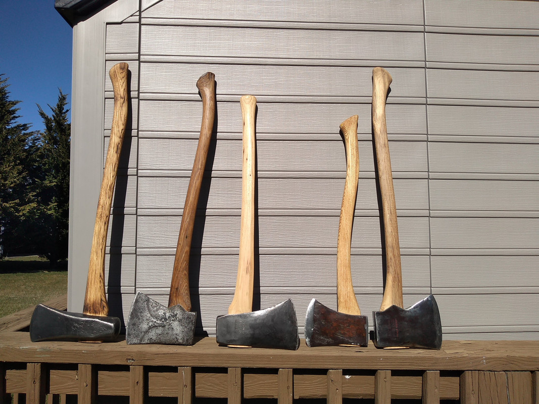

Edit; I just realized the other axe that got stuck is actually in that first picture! Haha. I had them both sitting in that rack drying out.

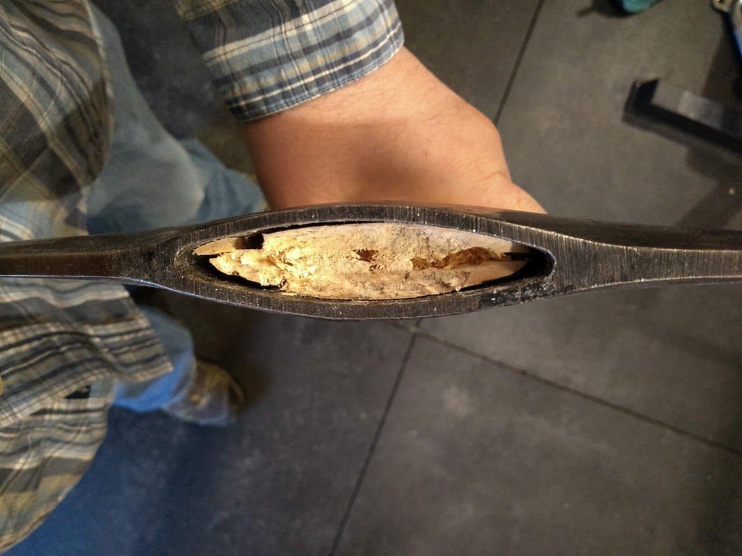

Thanks man, yeah it's funny because I just posted on another topic about how successful I've been at removing heads, etc. The inside of the eye isn't rusty, but it does seem really rough. I'm not sure how to proceed. I don't want to ruin the handle, though I may have already. I've crushed the crap out of the top of the tongue and even tried to drill the kerf back open to try to relieve some pressure. I don't want to destroy the handle because I put a lot of work into it.
tongue is a mess now :(
here it is, half on/half off. its in axe purgatory :(

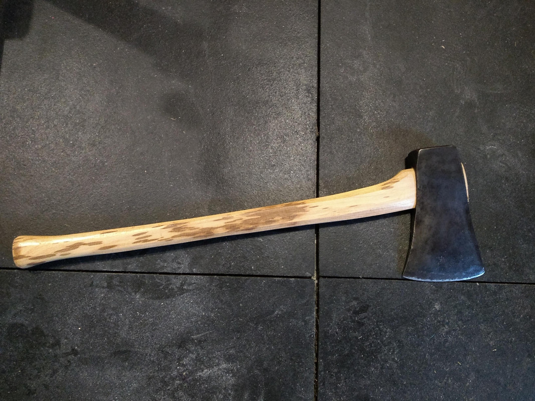

I've had this 5lb Flint Edge Rafting head for a little while, and finally got a 28" straight handle for it. Again, from House, and spent quite a long while thinning it down. I octagonalized this one - except for the grip of course.
It turned out really well, and I really like this axe. Feels really good. Can't wait to put it to work next time I go out with the chainsaw.

That's a handsome bunch of axes you got there! :eek::D. Some real lookers!

Yes, I have a Hickory drift I made out of an old handle. I use it every time I hang a head, but it wouldn't budge this one. I also used a large bolt as a drift but even it wouldn't budge the handle, it just crushed the wood down
