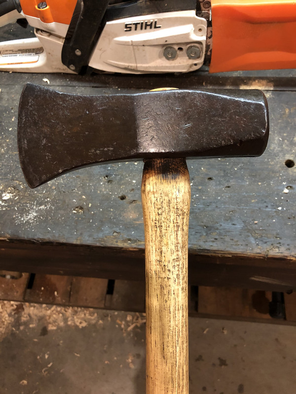

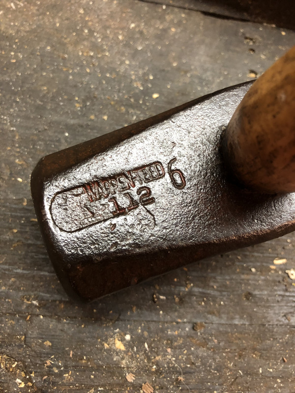

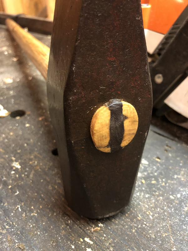

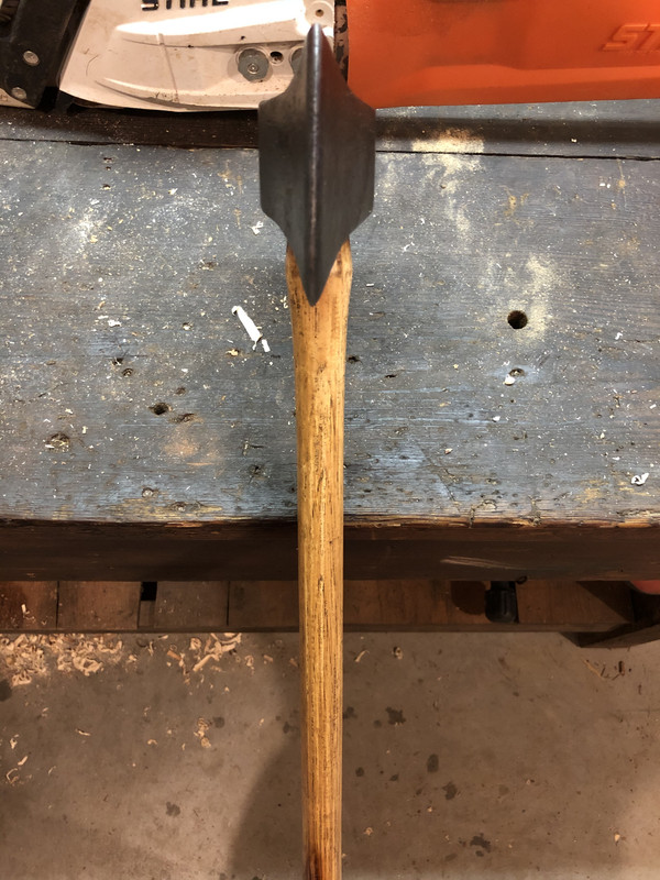

Went into town today went to the big blue store to get some things and went over to look at the Fiskars x27 a little more closely. Luckily they didn’t have any so I wasn’t tempted. I then checked a couple feed stores for a sledge handle and couldn’t find one of those either. How’s a guy supposed to split any wood. I decided I would remove the handle from my 10lb sledge that I never use and swap it over to my maul that had the cracked handle.
It’s a Warrenteed 112 I’ve had forever and is the best splitting profile I own. I was in a rush to get it hung and like an idiot put it on upside down and did not glue the wedge in. Luckily the wedge backed out after splitting several rounds so I was able to take it out and flip the head over and glue the wedge in this time. Hopefully this one will last several years.

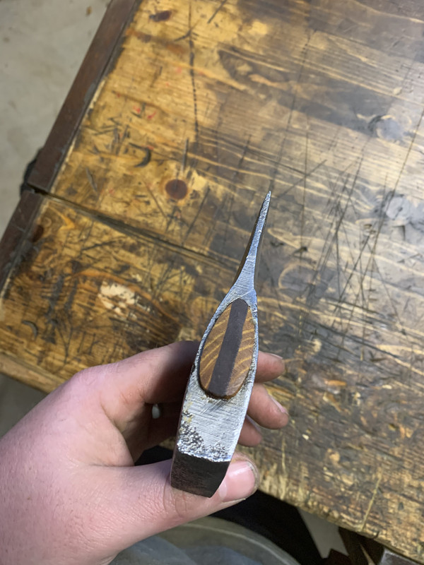

Hung this 4lb yankee pattern today. Thought I'd share one as it's been awhile! I don't know the maker but the steel felt excellent under my files. M.H.co 08 cast steel 4lb. Also has a Z stamped low midpoint onto the cheek. Anybody recognize that?
I found a decent Ames TT haft from HD to hang it on.
Weighs 4lb .9oz after filing and honing.
Paper (white) birch wedge. I didn't prep the tongue well enough so it slid forward on me a bit but it's all good.
Even though I don't know who made it I can vouch for the quality. It's a damn fine and old axe. Construction is consistent with the (19)'08 stamp next to the makers mark. Thanks for checking it out guys!

That's a good looking axe! I can't believe that's an HD handle. You must have worked some magic on it. They look good together. Great hang as always!

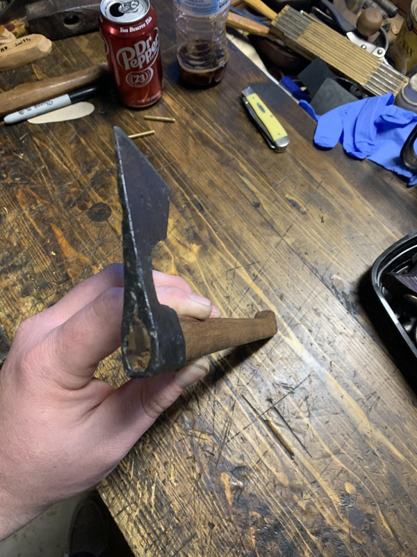

This is the prototype handle. I used white oak. I’m thinking it’s a little long. I couldn’t find many examples of axes exactly like this one. None actually with what seemed to be close to an original handle. And the base of the eye is shaped like a rectangle then it tapers up to a triangle type of shape lol. It was a hard hang for sure.
here is a comparison to a full size hatchet.
Please let me know what you think. Shorter? Curved? Stick with a straight handle? Thanks!

I think a straight helve looks really good on it! I bet it would look really awesome if it were straight right down until where your lower hand grips it but have it turn slightly forward. Same direction as the bit.(obviously). It's a really neat looking little axe. Very, very cool!
