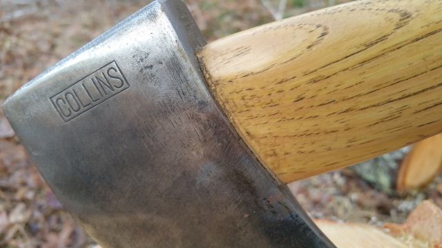

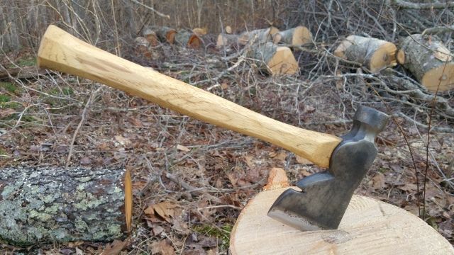

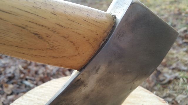

A Collins boys axe I hung on a HH that was thick as a baseball bat. I think I removed nearly a third of the material.

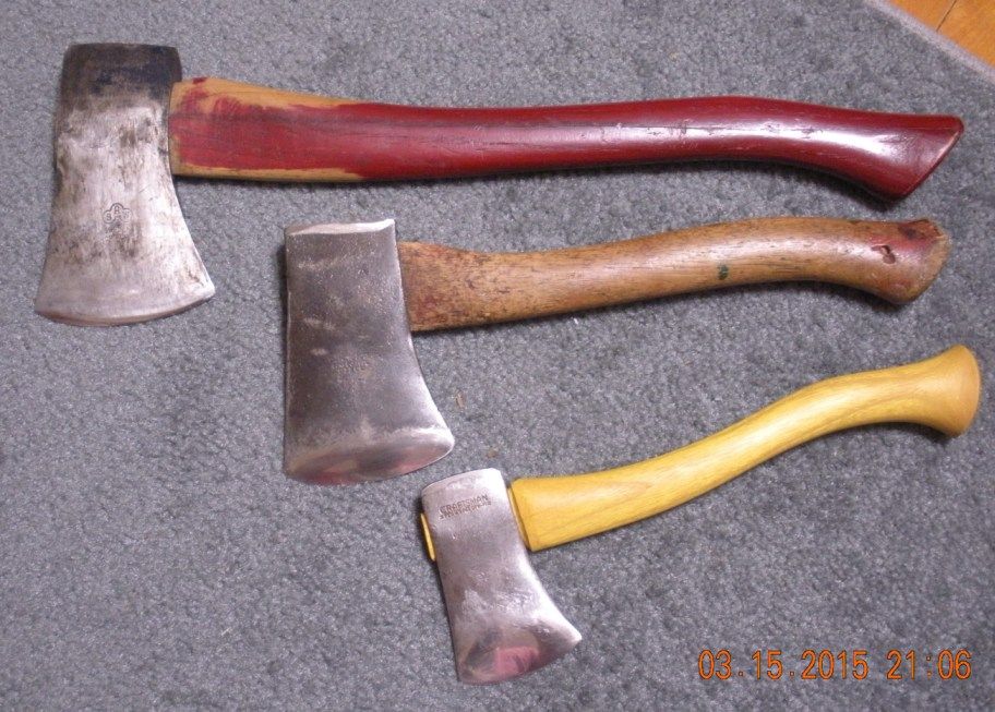

I finally finished up that mini Craftsman pocket axe. There really isn't much eye to work with on these, but I tried to make the handle big enough to actually get a grip on it. I had to do some serious reprofiling on the edge as well, since it was so thick to start with.
I think I have all my bases covered now in the hatchet category. I can choose from several sizes to suit the situation.
That's the mini Craftsman on bottom of course, then an old Shapleigh Hardware Diamond Edge camp sized hatchet, and a hefty Wetterlings hatchet that I re hafted many years ago.
Quinton,
You are an artist! You too, possum. I like the looks, even if I prefer a straight handle to use!

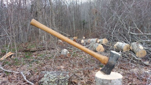

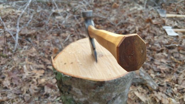

A permabond Plumb that had waaay to short of a haft for the weight of the head. I rehung it on an 18" Link haft that I octagonalized, and put a little belly in to favor the blade side.
quinton, killer, both of them. Such nice grain on that hatchet and nice work drawing the pattern, a keeper no question about it.

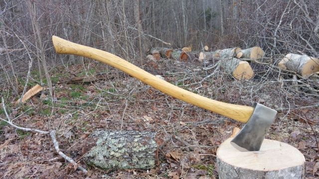

The first double bit axe I ever hung. It's a True Temper Flint Edge. I made that haft from a Pignut stave 27 years ago! The axe was given to me back in the 80's by its original owner. The original owner is a family friend who gave me the head when I questioned him about it when I saw it laying haftless in a corner of his garage. He told me It was issued to him in 1937 when he joined the CCC's. He's still kickin' and in his 90's, and asks about the axe every time I see him..

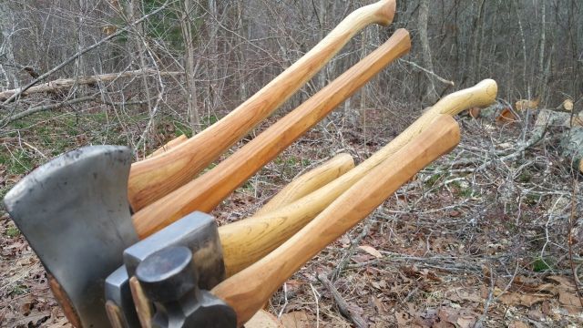

Group view of the wedging on the winter projects I have posted, all are cherry except for my son's Plumb on the far left.
