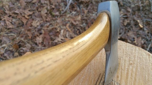

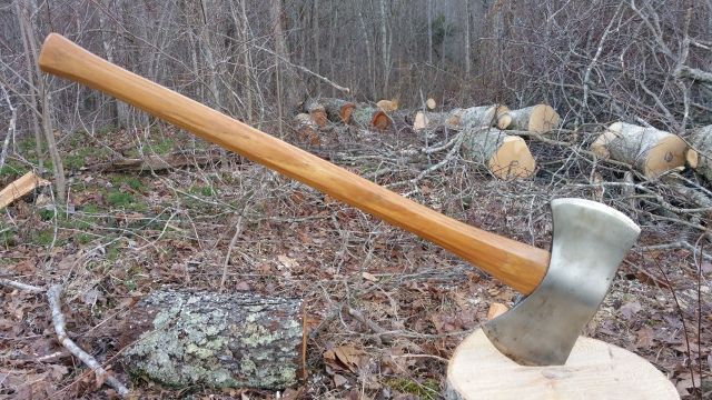

Mann Edge True American Boys Axe
Hung on a 28" boys axe handle from House Handle. I'm fairly happy with how this one turned out. It feels great in hand.
The last picture is my attempt to show how curvy the handle is. This is surprisingly difficult to capture in a picture. I can only imagine what COTS's handles look like in person.
That's just a great job Hacked. It looks awesome, no sharp transitions in the shoulders, no shoulder on the haft that will take a beating in splitting wood. Nice and thin with a very nice shaped fawns foot. Excellent grain. Its not your first rodeo.
The head looks good also. I have had some real good experiences with Mann axes.
Thanks for sharing your work! Top shelf stuff.

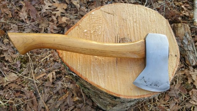

A Tru-Test hatchet that was badly beaten on the underside at some point. I reprofiled the head, and hung it on a haft I made from a Shagbark stave a few months ago. The haft is a hybrid, octagonalized transitioning to round in the grip. It was a gift I made for my son.
No name, ridged eye cruiser I picked up a flea market a few months back. It was badly pitted, so I resurfaced it an hung it back on the 26" haft that was on it when purchased. The haft was very old, but was unusable the way I bought it due to a severe bow. I steamed the haft once removed from the head, and straightened it by clamping. It remained straight, so I octagonalized it and rehung the head back on to the old wood.
Did you pattern that off of a vintage hatchet haft? I've got an old Ward's hatchet with a near-identical handle. Beautiful, comfortable, and functional. Great hang, man.
LOVE it. Kudos.
Thanks! Actually, the haft was made by feel. I started removing material until it suited my hand and eyes. The fawns foot is exactly 1 1/2" wide.. It felt so good, I actually traced a pattern of it before I hung the head!
quinton, killer, both of them. Such nice grain on that hatchet and nice work drawing the pattern, a keeper no question about it.
