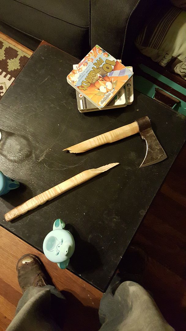

So.. i never saw that grain while working the wood
.. every visible grain was running the length of the haft.. apparently there were two grains that were diagonal and twisting... the entire 19 hour project I never saw them I'm kind of angry... so much work broken in 1 blow through a 2x4..
It happens to the best of us! Live and learn is the name of the game when making axe handles. If I remember right this has happened to me twice, so I don't learn to well.
That's a shame. I feel for you. We've all had a project go awry after much work. It always sucks. Take a shot or pound a cold one and soldier on. You still gained the experience of doing it. And let's face it - it looked terrific before it cracked.
Thanks.. i stained the broken one with some dark walnut... it looked amazing!! I'll try again... but I got my first Union job now... so I won't have time.. im gonna mail the broken one and the rest of my curly maple to my father who is a Wood worker. He's way more tooled up than I am.. he's got everything. He made a kayak that actually floats..

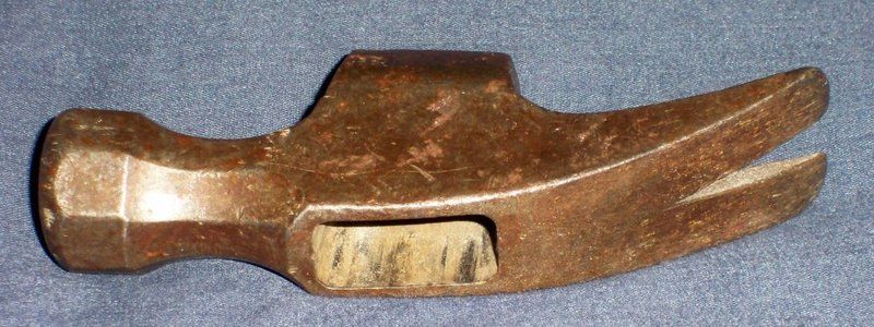

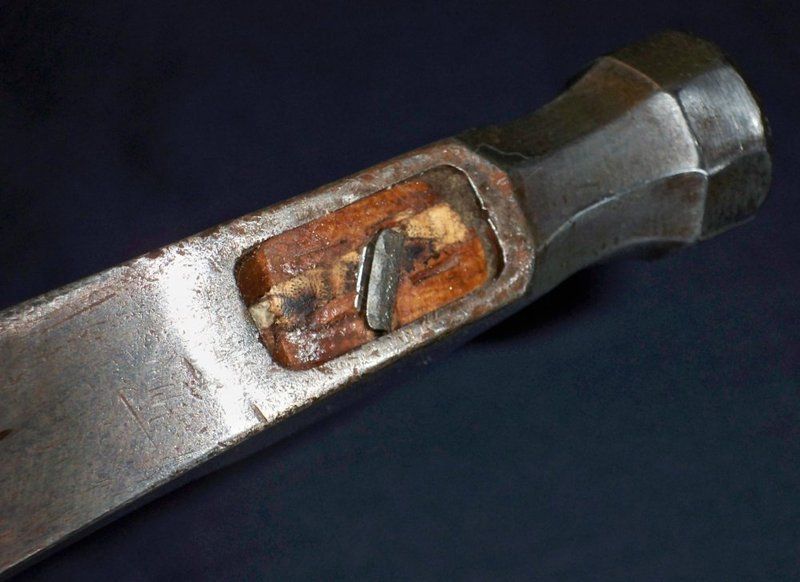

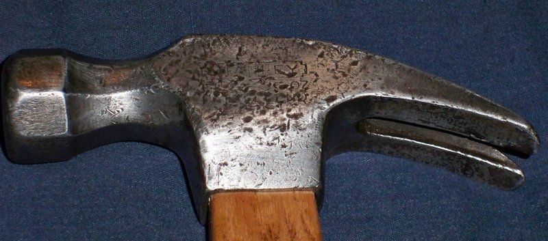

Okay folks. This is my first rehanging project. Let me know how I did.
This is what I started with.
And this is what I ended up with.

Amazing how difficult it can be to take pictures of octagonal handles joshiecole, but the work looks fully functional. I like that oak wedge and it looks well done - and that's what really matters. Charlie K, that handle is nice! I also vote well done. Did you do the lanyard tube? Or is that just how the pic makes it look? That hammer is ready to go back to work.

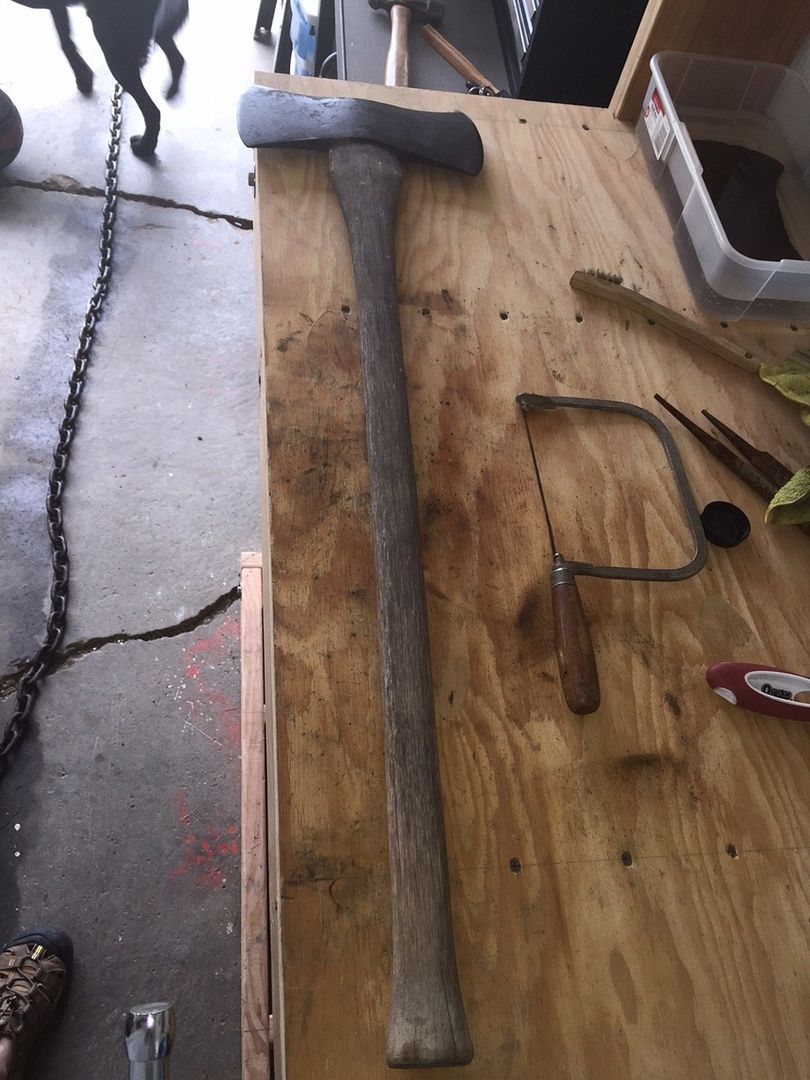

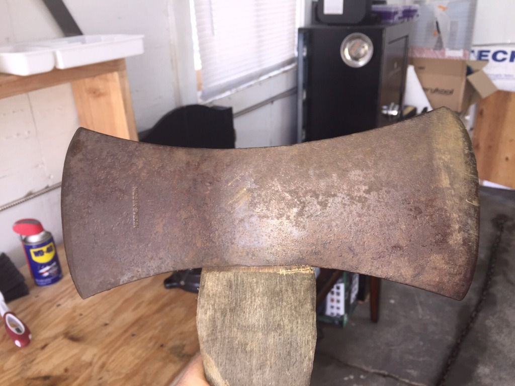

Speaking of not being able to capture octagonal handles. This is my project from today.
NE_OLDYANK1 by city_ofthe_south, on Flickr
NE_OLDYANK_knob by city_ofthe_south, on Flickr

I'd bet it took the better part of an hour to make that haft and hang that axe.:) Nice work!
