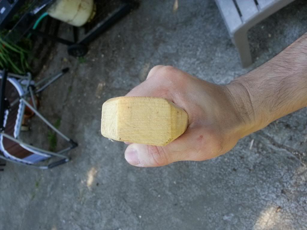

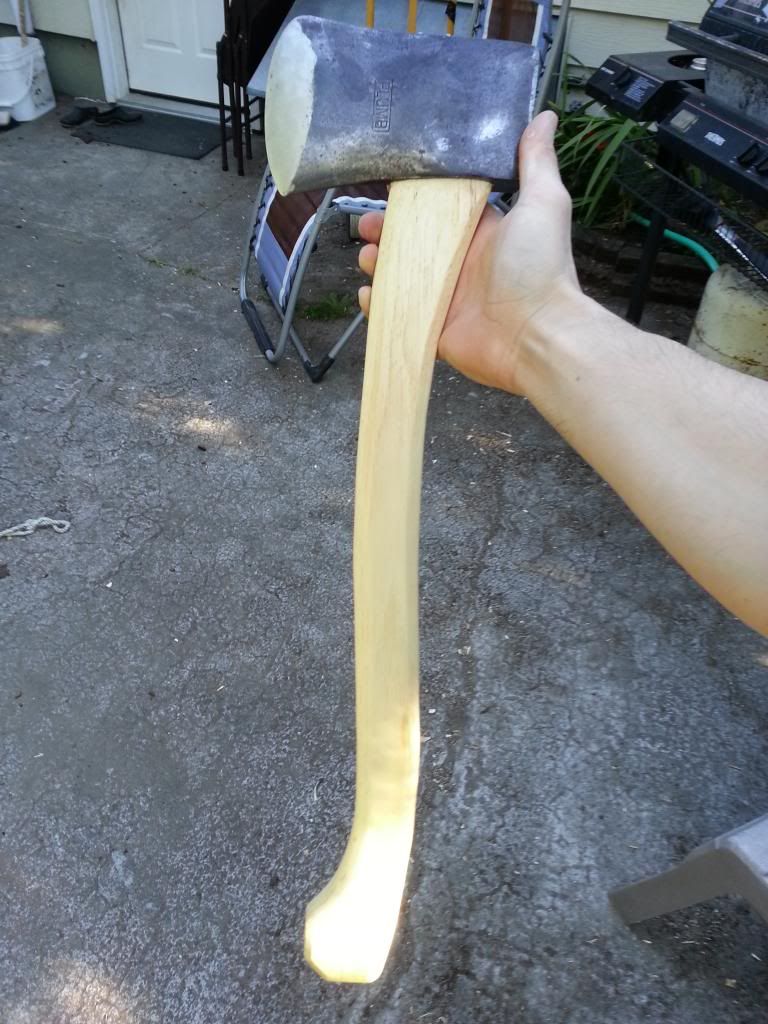

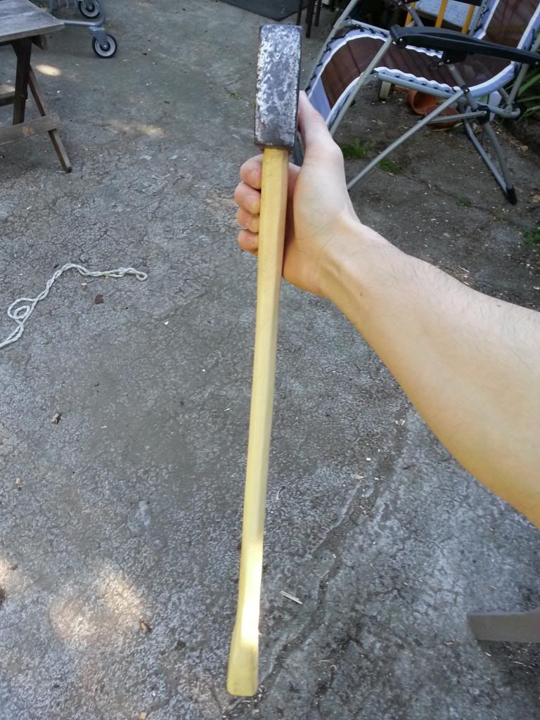

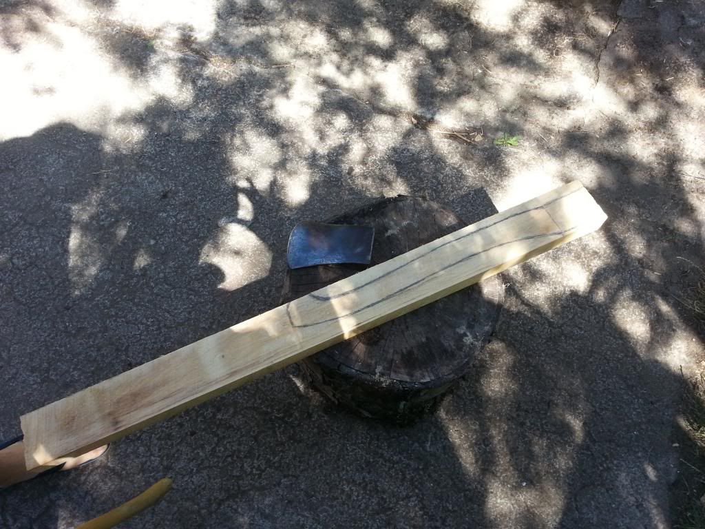

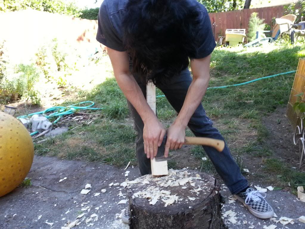

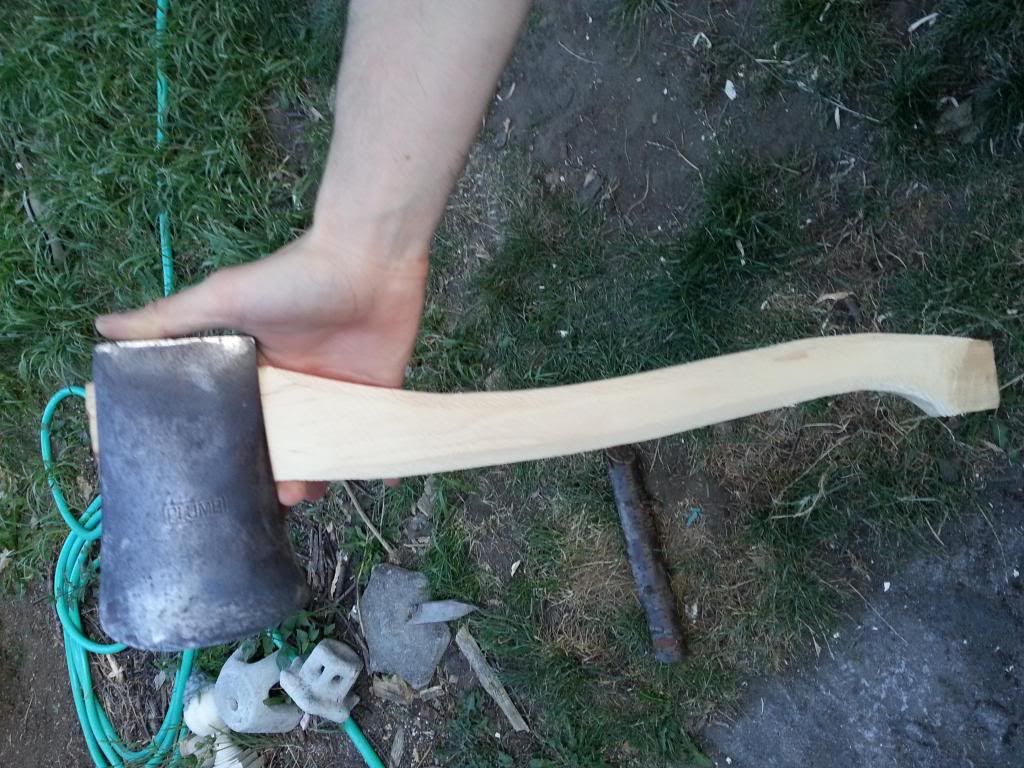

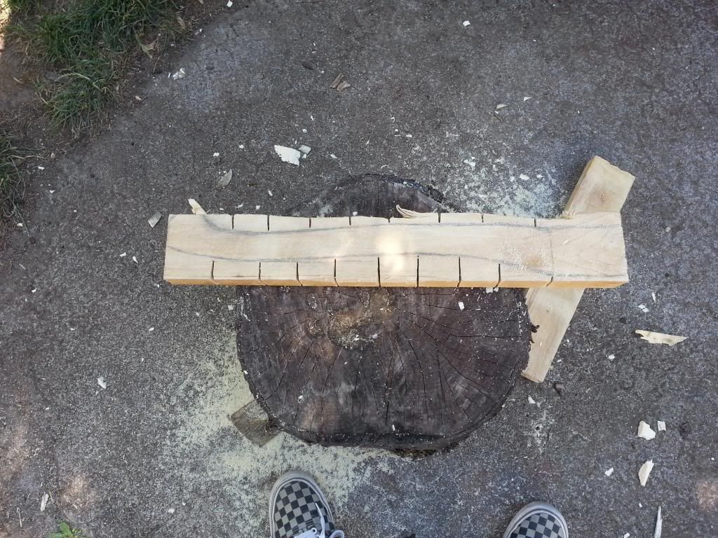

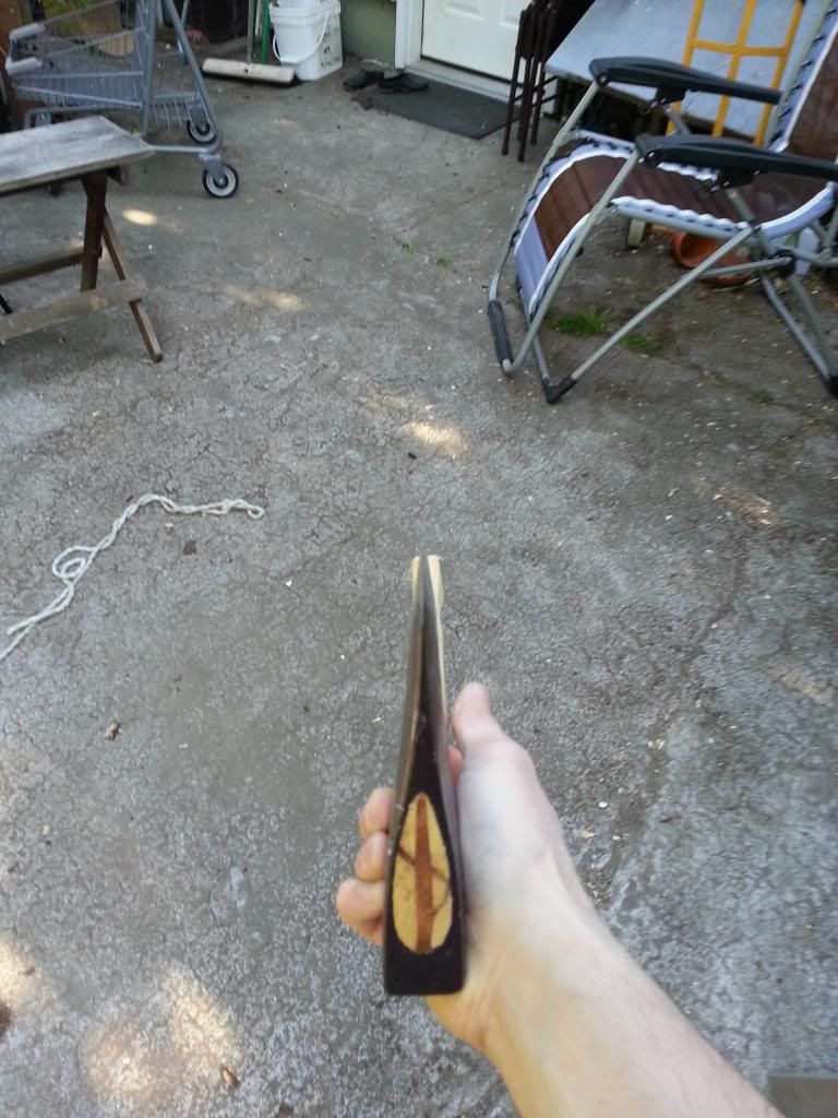

2.25 lb Plumb on a 21.5" slim curved octagonal I carved from one of the hickory blanks I got in recently. Girlfriend happened to be over yesterday and took the odd picture as I worked:

Seriously- what wood did you use for the wedge and how much did you shape the handle before hanging it?
Nice job killer! Like that Plumb.
Yeah - I think it was originally a boy's axe head (maybe 2.5 lb), but enough of the edge had been filed away over the years to make it look silly on a 28". Believe I got it for $10 or $15 because it looked rather used and might not have had much good metal left. File testing it though, it seemed to have a decent 1-1.5" or so left of well-tempered metal. I had to remove a lot off the cheeks to compensate for the geometry, but now it seems solid. Plumbs are pretty dang nice and generally quite affordable (a lot cheaper than equivalent vintage axes with more famous stampings)

As to the questions, I used seasoned cherrywood for the wedge - you can see the remaining stump to the tree it came from in the background. Cherrywood has been working pretty well for me - it's hardwood yet still compresses a bit even when dry. The Keen Kutter Jersey pictured is also wedged with the stuff (without a metal crosswedge) and hasn't seen any loosening despite having been used for some splitting and chopping tasks.
Oh and I did all the initial shaping with my 3 lb 28" Keen Kutter, the majority of the carving with my GB wildlife hatchet (only really used a knife for the tight curves at the handle and behind the shoulder) then hung it in this state:
It wasn't until after I hung and wedged it that I rasped down a few high spots and sanded with 100 grit for the final pics above.
