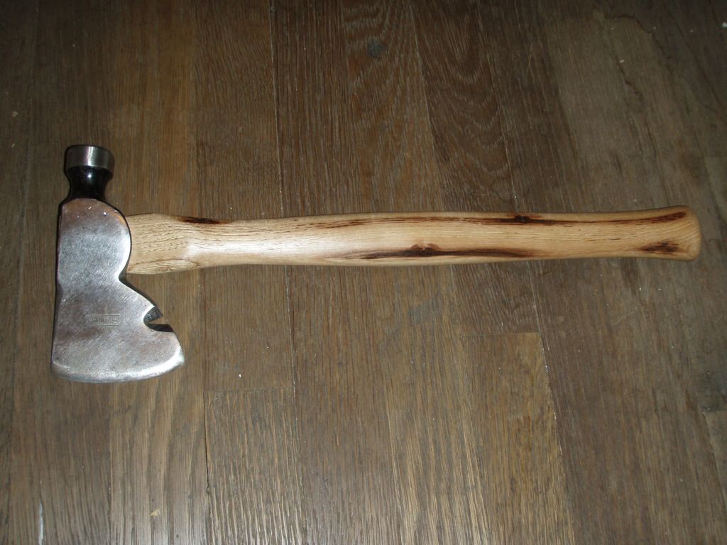

Vaughan Sportsman's Axe on a roll your own 15" Osage handle.

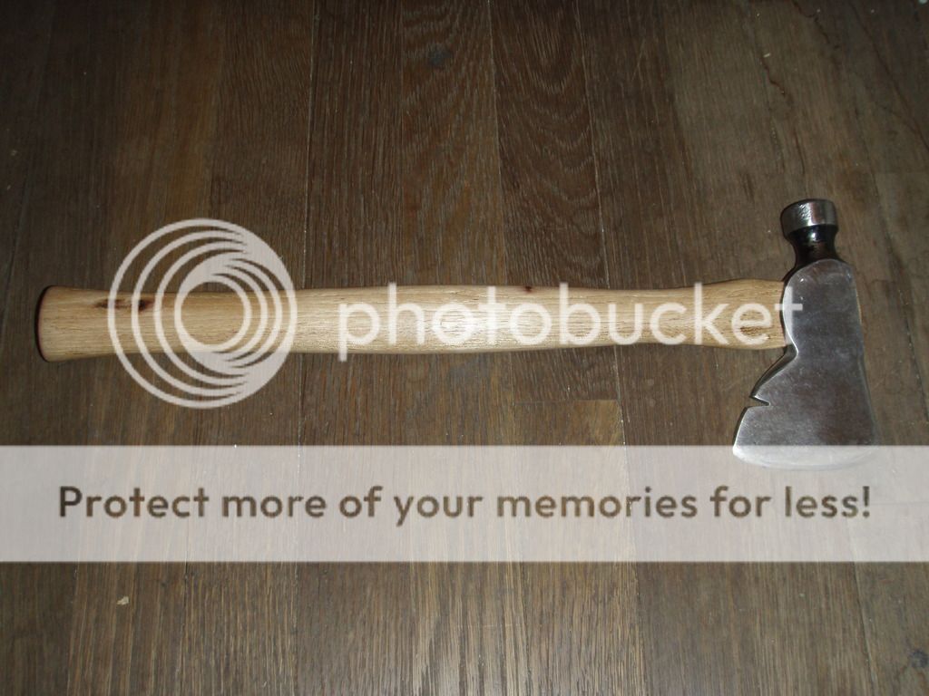

I've only used Osage twice, a hatchet handle and a picture frame. Here is the handle just after it was finished and hung. I think about four years ago.
[/IMG]
Here it is today
I don't mind that the handle darkened and lost the grain contrast. I didn't make it for looks. I just knew it was a tough wood and thought it would make a good tool handle.
Do knife makers have a solution for this? I wouldn't be happy with knife scales that lost the look of the fresh Osage.
Cherry is another wood that undergoes major color change just from exposure to UV over time. I'm not sure there's anything that can be done about it.
http://www.wood-database.com/wood-articles/preventing-color-changes-in-exotic-woods/
I didn't realize that the wood changes like that with age. It does seem like a good one for tool handles regardless. I've got a stash of locust firewood and I may hang a hammer with a piece. That stuff is dense!

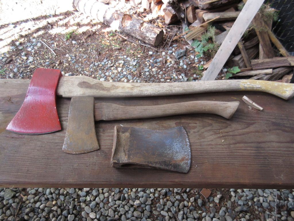

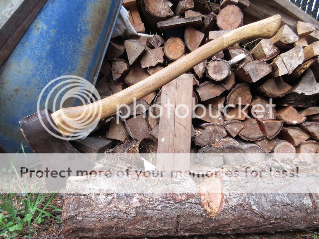

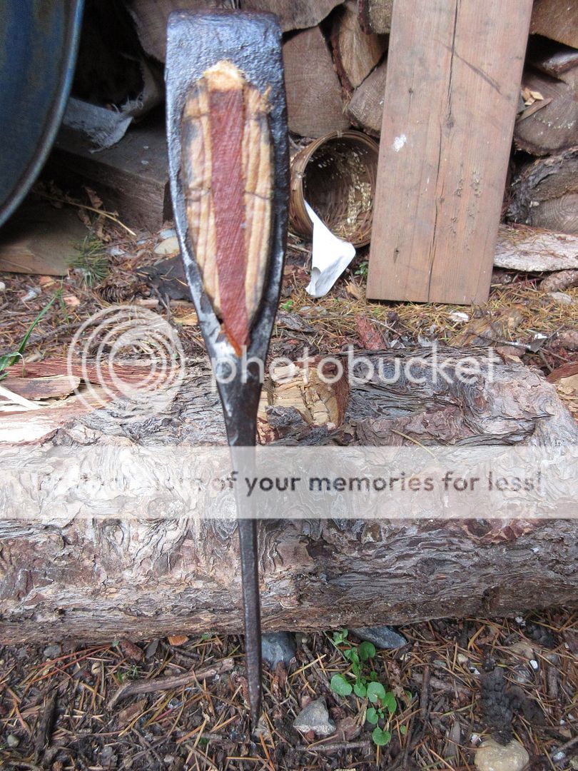

Finish working on the Itis today, took it back about an inch and 1/2 on its original haft which made it 26 1/2" long now. Made a wedge out of Pacific Yew, we'll see how that stands up though not sure if I will be using this axe at all. Have not sharpen it so still has the grinding wheel edge on it and only has three coats of BLO.
Before:
Now:

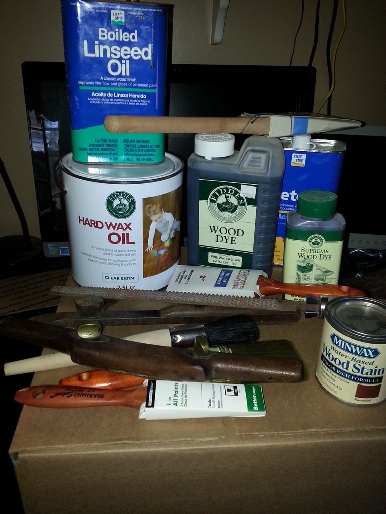

I got it, along with everything else for $26. I'm excited about the dye and hard oil. I have never heard of it before, but all of these cans/bottles are %90+ full. The hard oil can has a $115 price tag on it. I paid $1. There is also a very sharp Nicholson rasp and a Bridgeport box tool. A great score on everything.
Interesting. I'm not familiar with hard wax oil but it looks like a great product. I'm anxious to hear your review of it and see some hafts finished with it. I have the feeling I'll be impressed.
I have no idea what is so appealing about re-hanging tool heads. I just need a fix every once in a while. :)
