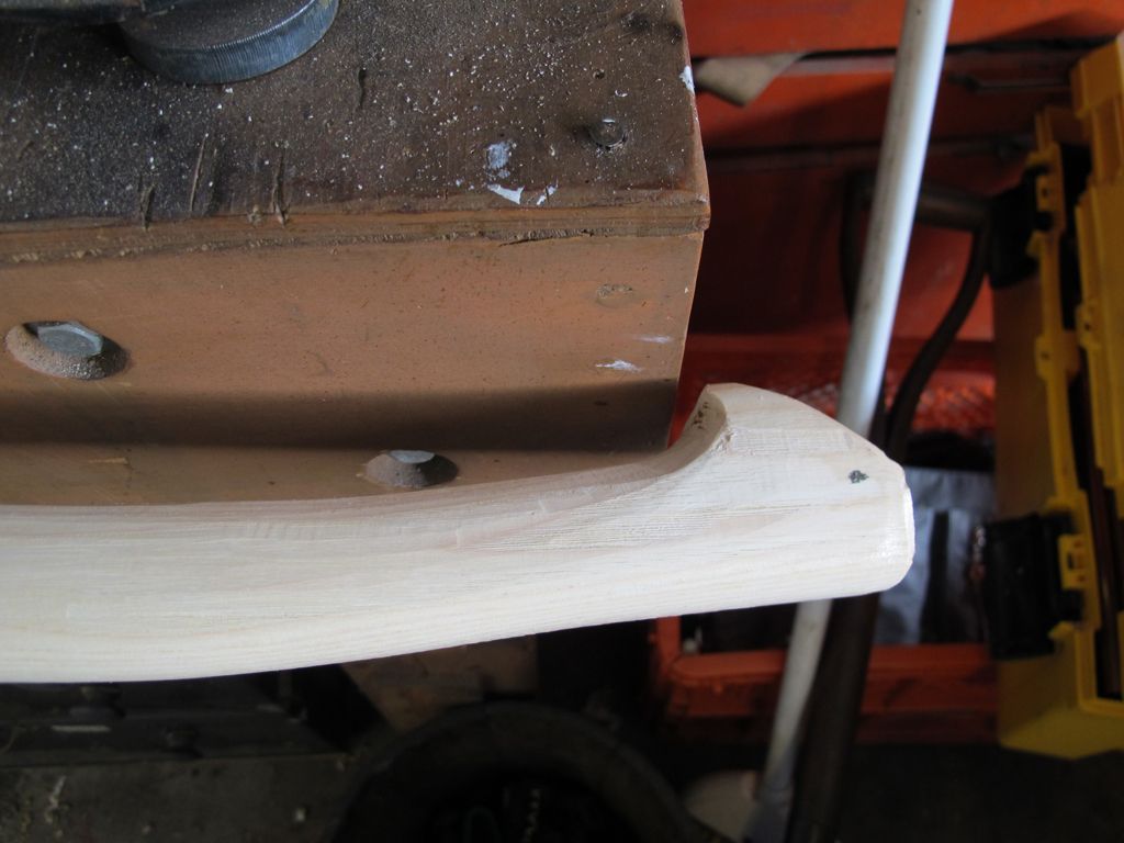

Looks great...I know what you mean about the shoulder thinning as I did that recently with a Sager.

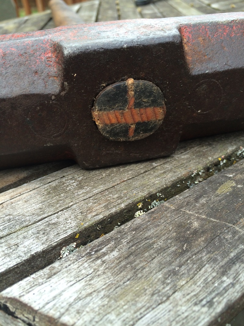

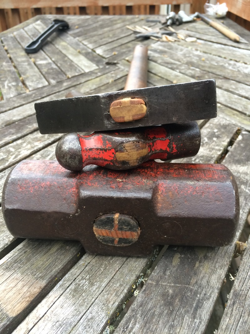

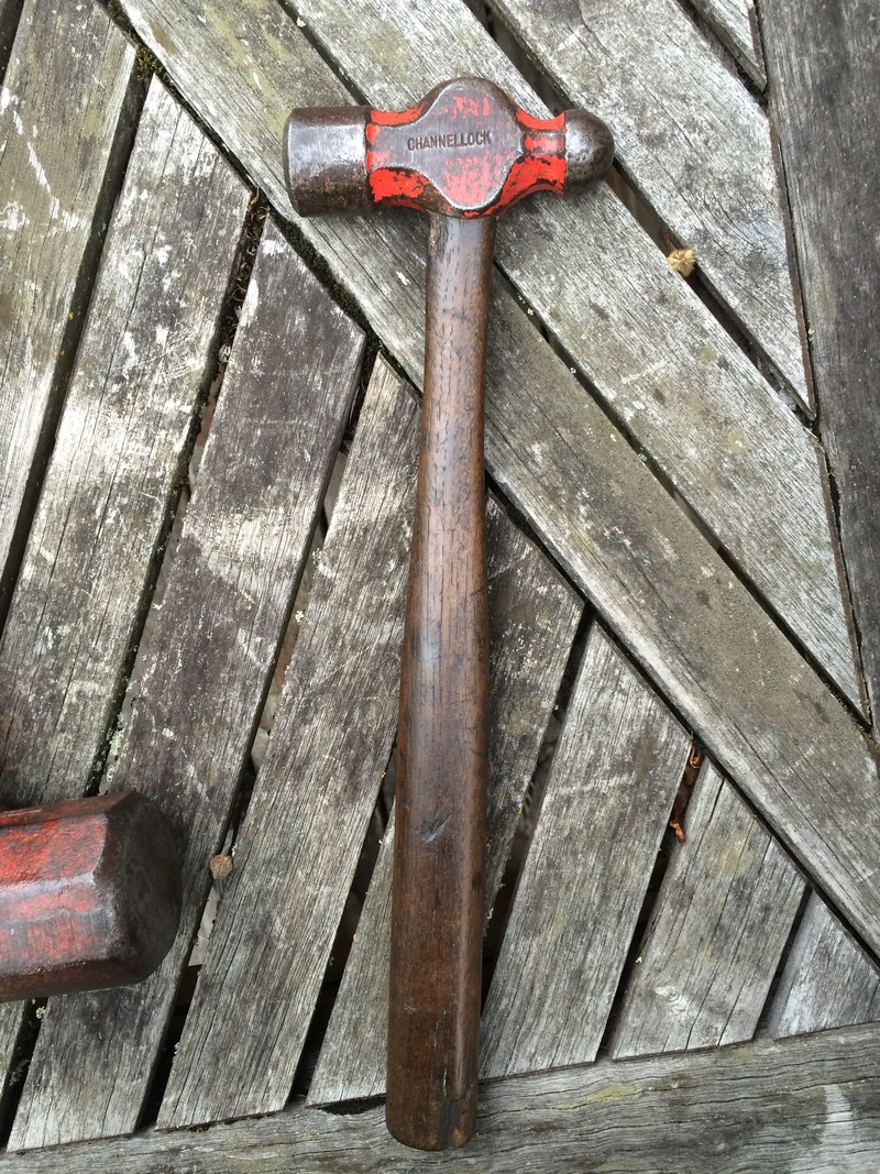

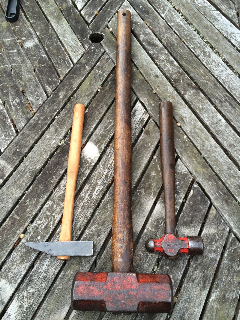

3 Hammers.
Left to right: Niagara Tool Machine and Tool, WECO 8lb Sledge, and a ChannelLock ball pein hammer.
WECO Sledge
Channellock ball peen

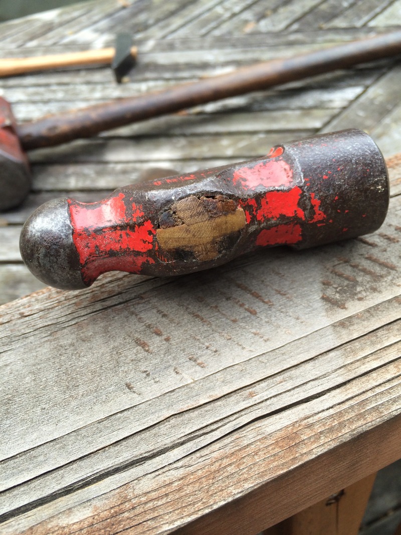

The handle was useable but the last owner drove a metal wedge into it and essentially removed enough wood that a crosswedge seemed like the only way to keep it on there.

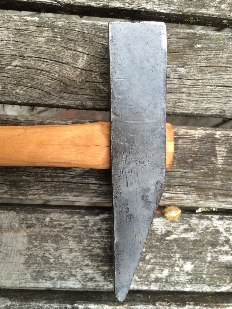

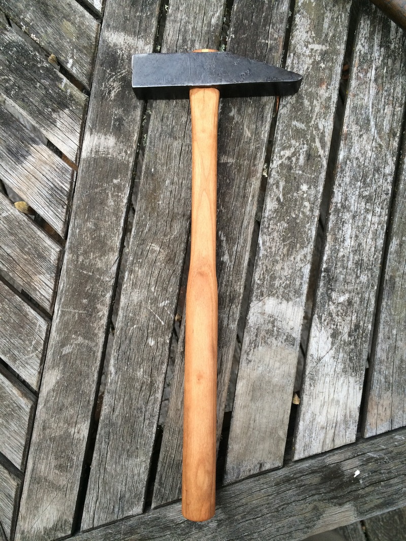

Niagara hammer
The handle is made out of a nice piece of cherry wood. I had it left over from making a wood vise handle.
It’s pretty but I did split it some with the cross wedge – last strike with my mallet too.
Good stuff. I have two of those Channellock ballpeins, one is 2.5lbs the other is 3lbs- the biggest ballpein that I have personally seen. I love it.

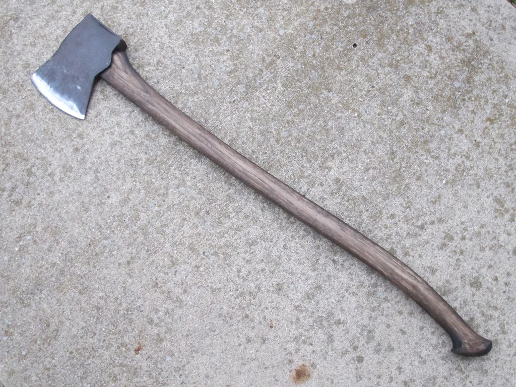

Smith that is a great looking axe. I like the swell on it - that takes a little time to do right.
Nice lines, sharp bit, great Jersey!

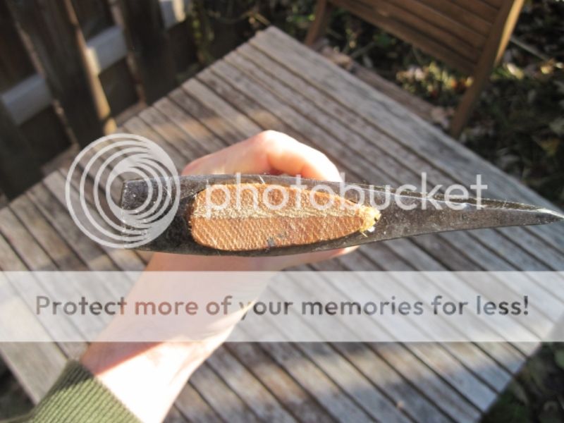

Supplee-Biddle 4 lber on a 32" hickory haft, my Uncle brought me some up when he was visiting from Florida, pretty different from what I'm used to shaping into a handle.
DarthTaco - that looks great! Did you shape it from raw wood?
Lots of tempered bit on that one. Good picture as well. :thumbup:
Yep! My Uncle brought up a stave or two of Hickory from Florida, it doesn't grow here in Maine...at all. It's a bummer. Took my time and was careful and the end result isn't that bad!
