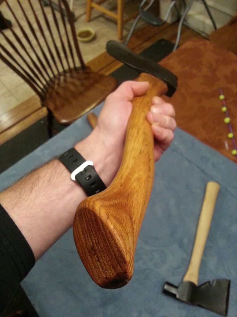

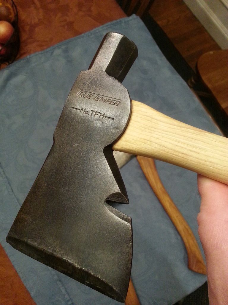

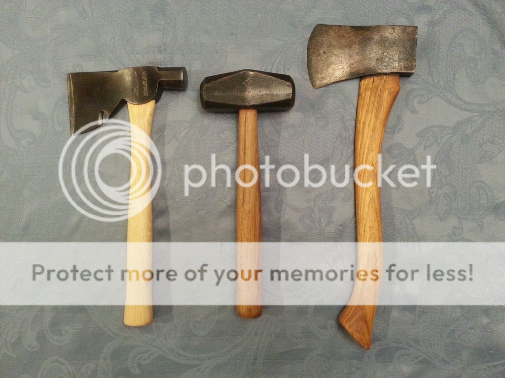

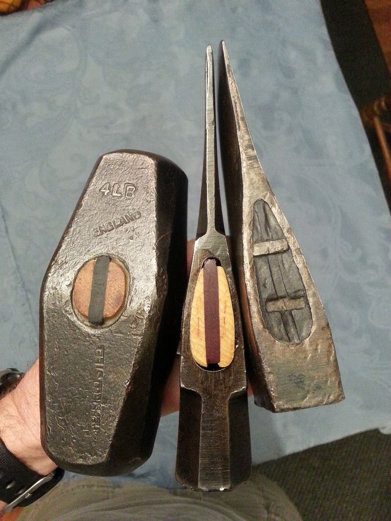

I like all of these. The hammer is a 4lb head marked England Sheffield Steel on a 13" reshaped piece of old sledge handle treated with BLO/beeswax. The True Temper half hatchet is on a brand new (ahem, see the area of worm holes?!?) House Handle treated with natural Watco Danish oil, for fun I used a bloodwood (satine) wedge. This turned out so nice that the imperfect handle really bothers me. My favorite is an unmarked large hatchet on it's original 17.5" handle. This is the one nice handle from my last group in "Followed me home". I just wire wheeled the head, then lightly rasped and sanded the surface of the wood before the standard Blo/beeswax treatment. The handle is tight and excellent.

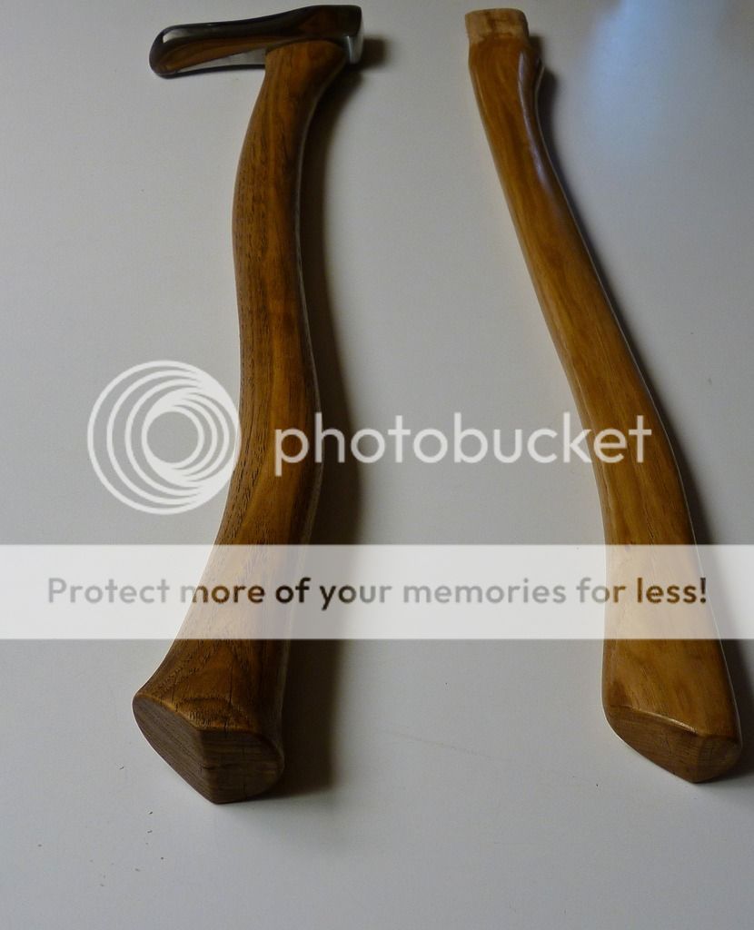

My dad gave me this axe 45 years ago and it was beat up then. I carried it in my pickup until 9 years ago and decided to restore it in memory of my dad. Didn't know your not supposed to destroy the patina, but it was really beat up with red paint for patina so I did the clean and polish thing. Put a cheap hardware handle in it 9 years ago not knowing anything about a proper hanging job. A few months ago, I picked up a House brand boys handle for it, thinned and shaped it to my liking and here's the result. There's a cedar pattern in one of the pictures, but that's for another day.[/IMG]

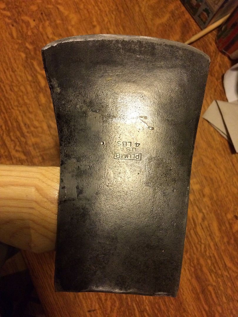

Ultrahesh, that Plumb looks like a bruiser.
