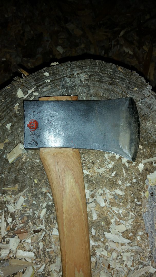

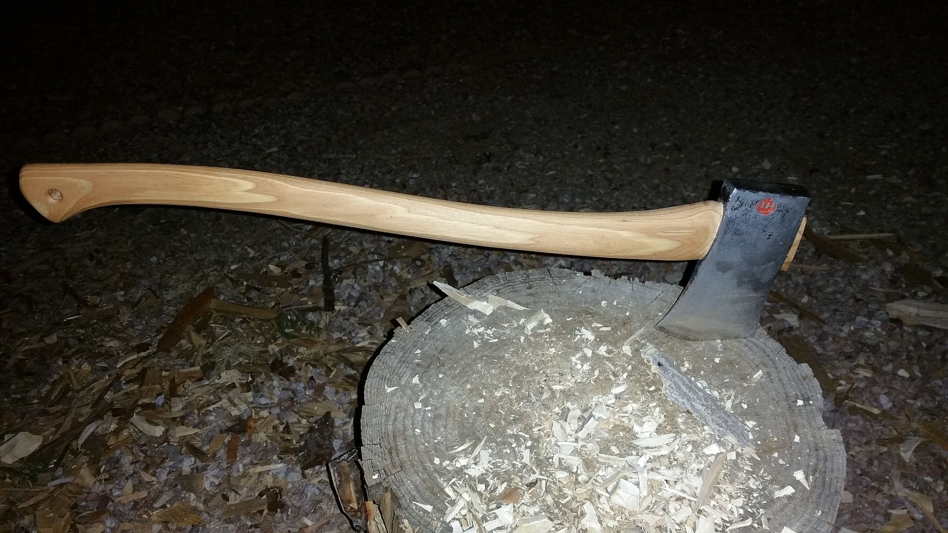

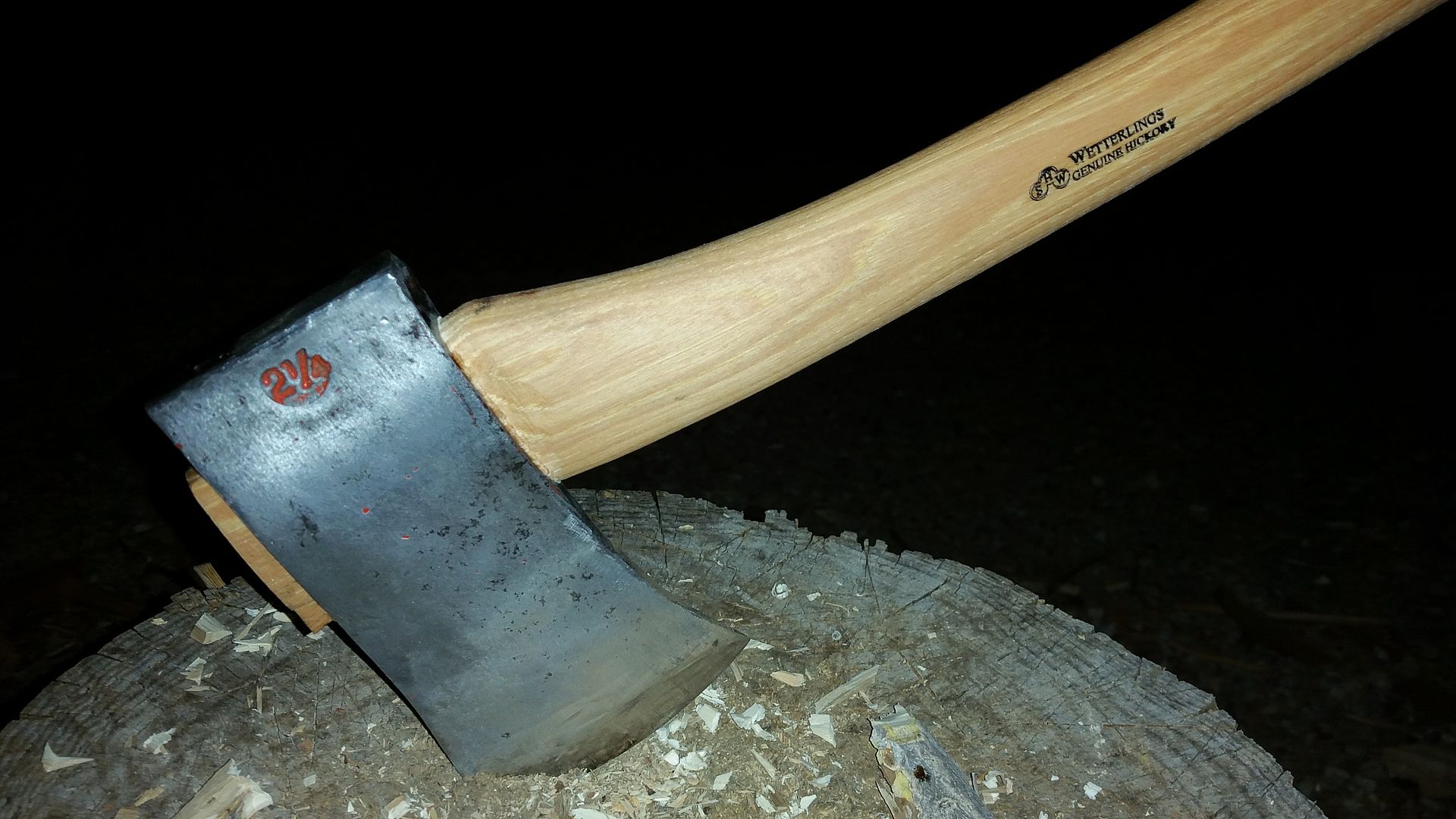

A Kelly Woodslasher hatchet I've been working on for a little while. I still need to pop in a wedge and add a few coats of BLO but I'm fairly excited about this one.
Looking good, post up pics after you wedge and get a few coats of blo on it please sir. I like the hatchet handles that have some heartwood in them.

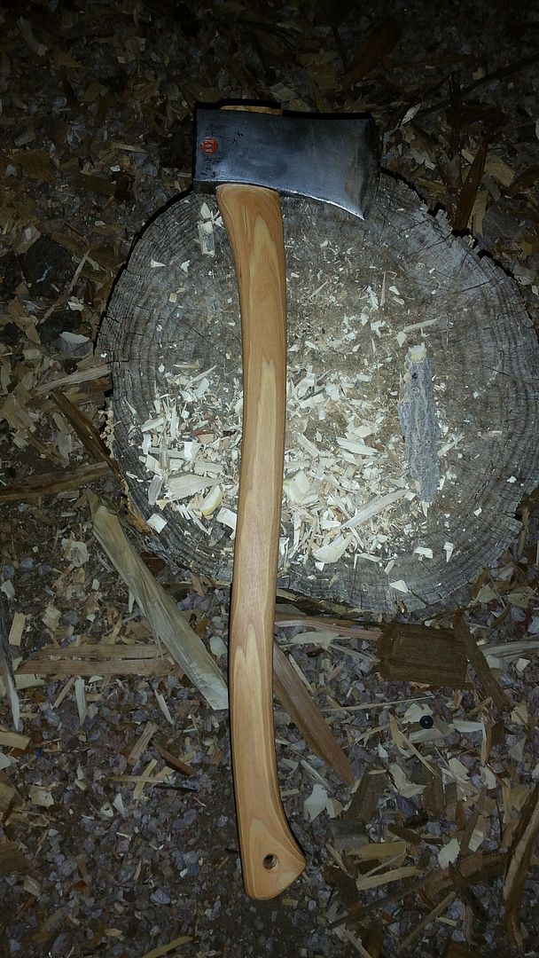

jerseys_plumb_kelly by city_ofthe_south, on FlickrYeah alcohol based leather dye ... thin it with alcohol if necessary (probably worth trying). I've had handles where the leather dye would come off on my hands, so I think it has something to do with the wood. However, I only use a tiny bit of dye and usually I apply it with a rag which is also soaked in BLO. I think that maybe you get a little better carrying effect, but regardless, nothing seems to penetrate Hickory well, at least not when you just rub some on the surface. I typically finish my handles down to 0000 steel wool before I dye them and they get more BLO over the dye until they won't take the oil anymore - theorizing that the oil is possibly sealing over the color, or helping to carry it in far enough not to come off. But most likely if you're really sweating or the handle gets wet, you'll get some color on your hands.
My Plumb Jersey has the most dye I've ever used on a handle, that is, the whole thing was covered in enough dye to get the full color from it. And it still looks like this. It's worth noting that I have some go-to axes, and some I like to look at, so I'm not going to say I've used it as much as others. For whatever it's worth.
Last thing is, I use vinegar sludge (vinegaroon) first. It can actually be made to be a pretty dark dye, but it raises the grain a little. I rub the vinegaroon on first, wipe it off, then steel wool the handle until it's slick, then apply leather dye wherever I think looks good, then BLO until it's taken all it wants. So because I get some effect from the vinegaroon, I use very little (I mean a few drops maybe) leather dye, just to bring the color back. So it's not as if I am full on dying my handles (except the Plumb of course). This is the technique used on the other Jersey in this picture. This is an axe I use everyday, and I've never had color transfer from it.

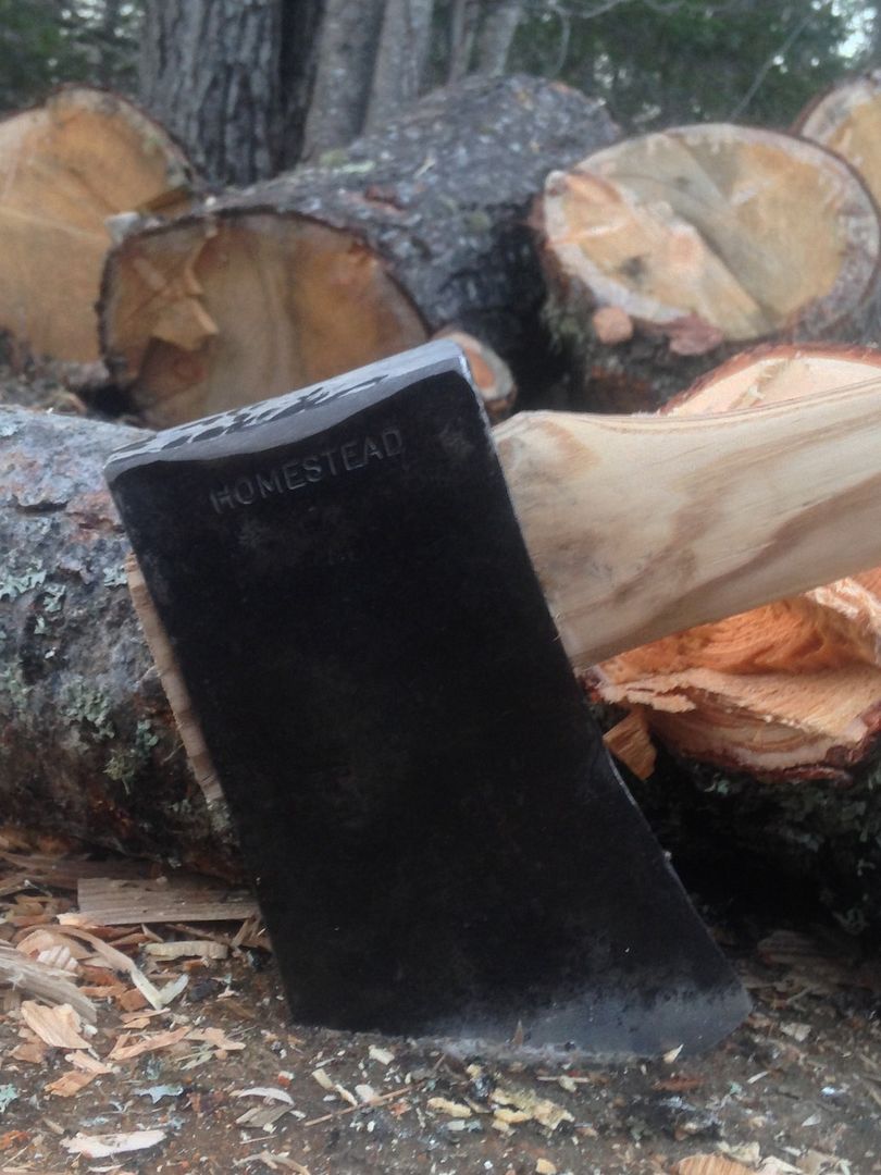

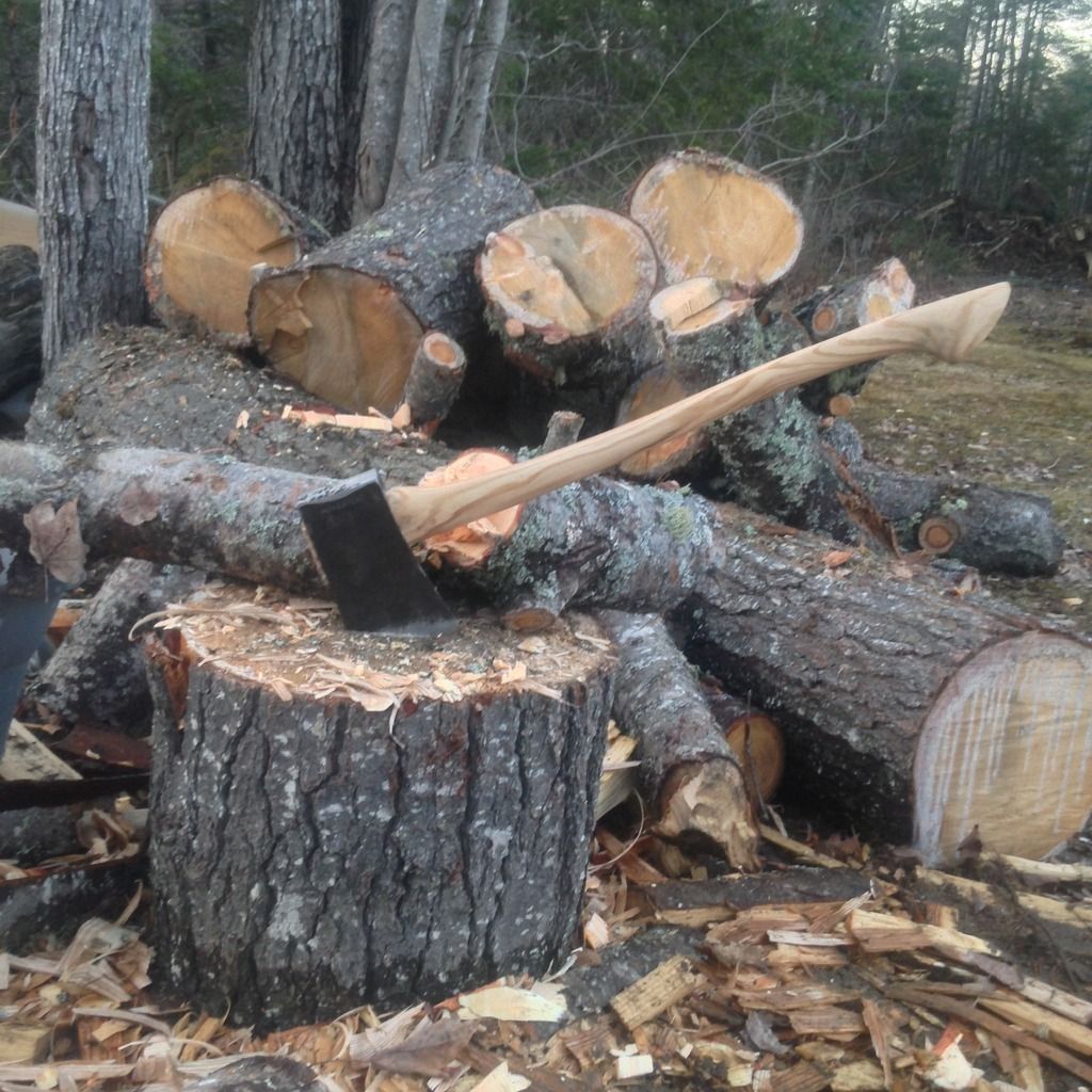

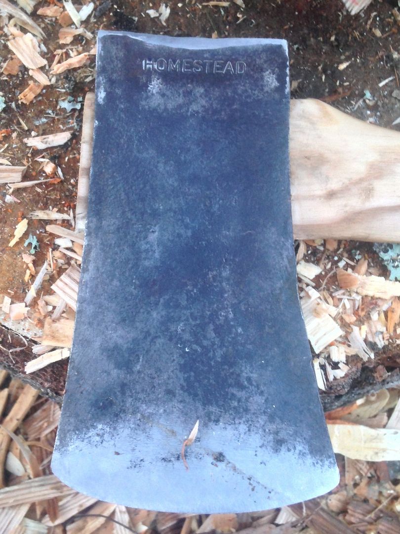

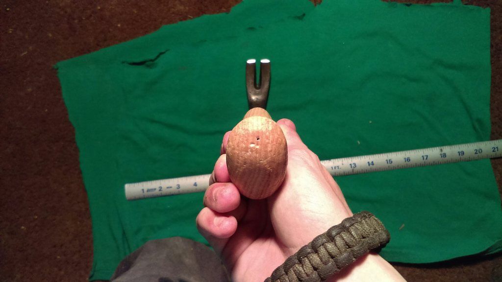

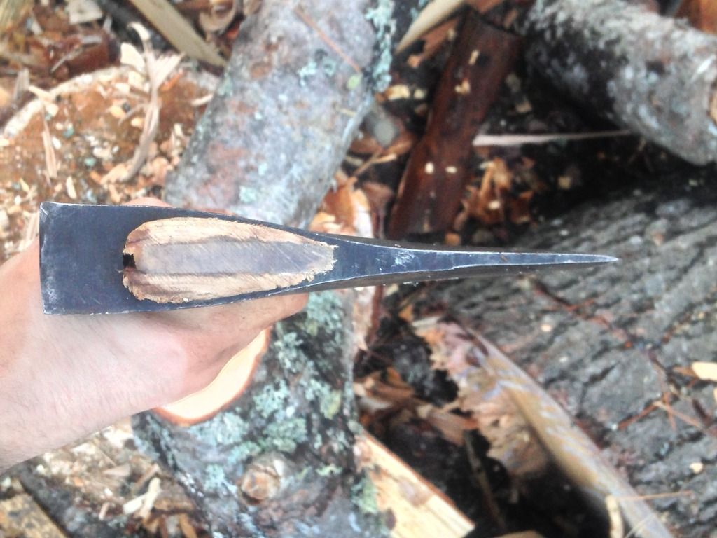

3.5 lb Homestead on a 27 1/4" carved ash handle, has a little gap in the back of the wedge that needs to be filled in. It's my little big monster!
Nice looking axe DarthTaco - especially that "Foal's foot". That won't fly out of your hands easily.

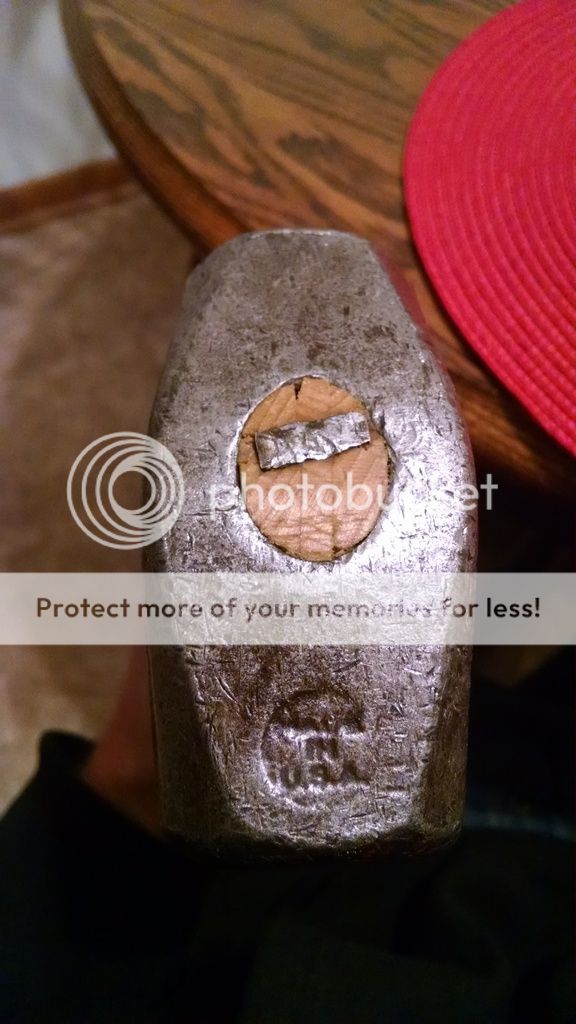

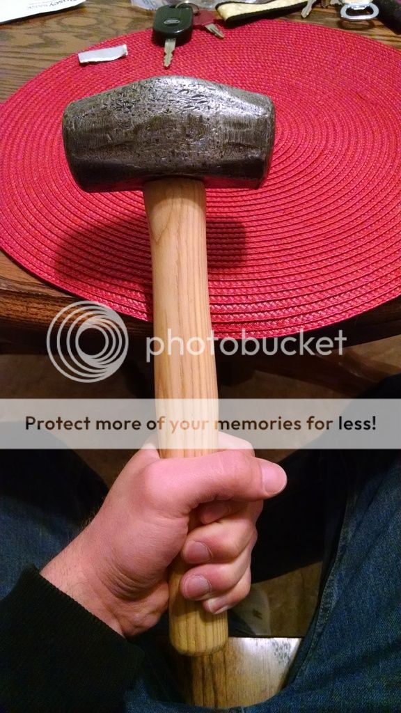

I made a handle and hung a trusty ol' hammer for a guy at work the other day. I'd never hung one of those before. the eye was smallest about 2/3 of the way towards the top, then flared out on both top and bottom, but more on the top. I initially drove the wood wedge in and there was still some decent gaps, but the step wedge seemed to fix it. I wish I had a pic of the old handle, he used the hell out of this thing.
