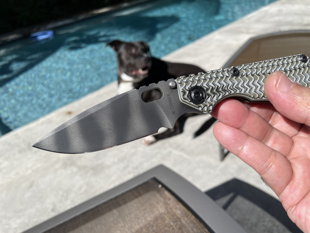

Man's best friend, and a dog. ;)
Got my first Strider knife the other day. Quite enjoying it, but the factory edge was ... something that comes out the rear end of that dog up there. Factory angle was 18° on one side and 30° on the other. Scuse me? Pretty dull, too. Would not reliably slice catalogue paper. 20cv steel which I measured at 60 hrc.

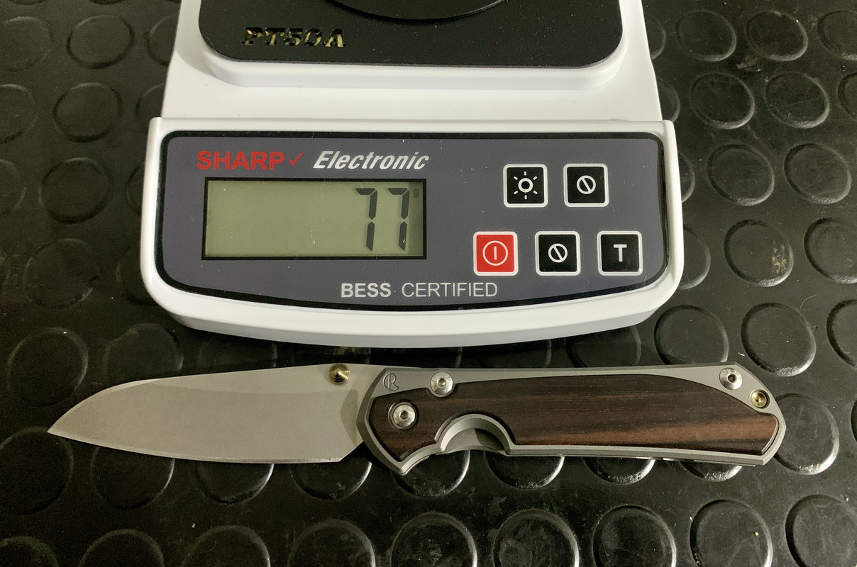

So, put it on Tormek for the usual treatment: 600 CBN + 1000 CBN + honing on WS with leather belts, 1 micron, Tormek PA-70 compound. I did 17 dps for now. Wanted to see how wide it got before going lower. Still managed a BESS score of 85g, so I might just keep it at 17.
I did a Case Slimline Trapper last night because I thought it would be a layup. I wrapped the blade up in kapton tape to keep the scratches down and wrapped masking tape to protect other areas of the knife. Used a magnetic table on my K03, which makes figuring the angle tricky because the blade did not lie square on the table. I like to use 1/2" stones on small blades, so I profiled with a 1/2" 150 grit Boride TS stone. The factory grind was so uneven that the left side bevel ended up twice as thick as the right side. The heel of the left side had a big low spot, and I decided it wasn't worth it to get out so I switched to Venev Ursa stones and did edge trailing strokes from 150-800 grit. Turned out decently sharp. I should have used clamps on this blade because there is enough flat real estate just above the bolster.
