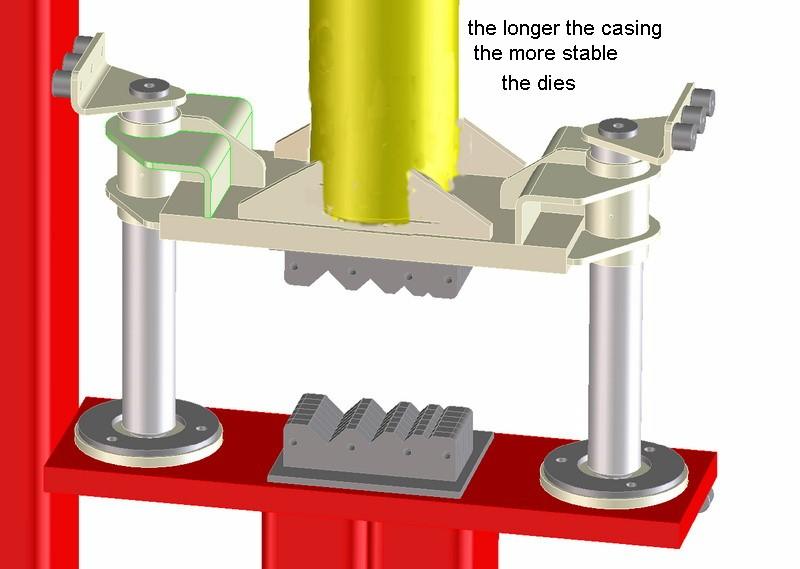

looking nice Mike..
I like the position of upper piston pad-eye pin, looking at the cyl base bumper
being close to the plate.
I have a line drawing of one of two I want to pick from to build
though it is different than yours, I did make some additions and additions
to it from your Ideas.
I'm liking the colm idea to bring in the welds, though still not sure why you want them so long..
I'd like it if you would look over my design and have at it..
my die plate stabilizing will work well I think for the lack of money needed for it.
I like Ron's (Bowie) idea about having things up at face level or close , so my piston
is at the bottom BUT still the lower die plate will not move up with the piston..
this should make you wonder?? until I get it posted.
The tube main frame I'm hoping will be the oil tank, if it will hold enough volume if not it will cut down on the size
of a tank needed and still aid in cooling.. sorry this is some what OT.
thanks Mike this all leads to a better mouse trap for sure..

Lets see what you have? I couldnt tell from the modified photo what you were thinking when you turned the cylinder upside down. Can you post a line drawing to clarify?
Im hoping all these ideas will get everyone thinking along a different path and hopefully something great will come of it.
DAN
"I'm liking the colm idea to bring in the welds, though still not sure why you want them so long.. "
It transfers the load down to the ground. Same principle as putting an Anvil on a stump. If you put the anvil in the middle of your dinning room table and hit it compared to setting it on a stump and hiting it. The stump transfers the load to the ground. (Thanks for that analogy Brian G.)
This thread is great.
About placing motor and pump outside: Is there any problem or loss as hoses get longer? IOW, does the length of hose from the powerpack to the actual cylinder affect performance?
Thanks,
John Frankl
I wonder if you could replace the bottom plate with a plate thats welded to the sides and that the piston bolts into? Got to be something simple to add side to side support.
the cly body bottom plate (part of the cly) now that I can see the type of cly you have, your cly is a fully rebuild-able cly
and it would be a problem doing as I mentioned..but for the other type you'd have just have to remove the pad-eyes and then you can use it the way I pictured, in turn this
would give you surface aria supported by the cly walls.
unlike the articulating pin and clevis joint. the rod being top side adds leverage to the cly body for said support..
as you can see it would help greatly support the die in all tilt directions

Lets work on the side to side support issue. Do you think that it will wobble and create a weak bolt area Michael? What can be a simple solution? There has to something easy ;) What about just a huge collar of some sort that will be welded to the sides and the piston just sits in it like a big bushing?
I am all for making this as simple as possible and you collar idea is i good one.
I didnt want to weld on the cylinder because of the seals inside. I dont want to ruin a $230 cylinder. My train of thought was simular to yours. I believe the collar is a great idea, Brian. I went with 2 of them outside of the cylinder. Good idea putting some supports on the cylinder per your first post. If the bolts werent there i could fab a round bracket that would wrap the body of the cyl and attach to the outside tubes. I wasnt sure if it was possible to disasemble the bolts on the outside of the cylinder, attach a support and reinstall the bolts. I dont know if that would damage the cylinder.

My personal opinion based on absolutely no technical info and only a gut feel:
I don't like the idea of "trapping" the cylinder. I wouldn't want to create anything that could potentially mess with the overall linearity of the casing/ram for fear of creating a minutely uneven seal wear.
The pivot point at the lower clevis pin would still remain. My recommendations have surrounded either reducing the clevis pivot (my whacky idea I mentioned earlier, best discarded), or making the slide more rigid. This would all be moot except for the combination squaring dies, which will definitely want to skew things.
IMO, Michael, the only thing that could happen is the combo dies are just too much and you'll have to revert to one-square per die. By tightening tolerances and increasing tube length you have addressed this and the final analysis will be in the actual use. One way to help this will be the aforementioned use of removable stop blocks on the off-side if it becomes an issue.
You seem to be considering separating tank and pump from the frame. Something to pay heed to is if PlainOlBill comes back about whether he's still got his remote pump/tank hard piped. I remember when he first did that it resonated his whole building and actually made it worse. I can't remember if he insulated that effectively or had to go to flexible tubing. These suckers do whine and if mine wasn't outside under the carport and was enclosed it'd be very aggravating with a long day's work. If Bill doesn't come back on this I'll pester his old arse with a phone call. Been a week since I annoyed him, anyhow....
Indian George has his hydraulics on quick-disconnects so he can even remove the pumping system to the garage or wherever for service and leave the frame where it sits.
Another little hint is make the switch very accessible as you approach the press. Most guys will turn their press off between heats to cut down both the noise and the pump time to keep the system temp down. Naturally, one always has the 2300F billet in hand when they turn around to go to the press, so the switch needs to be easy to get at. I wanted to put one of those "emergency-off mushroom-head" switches on mine but it was too expensive. For $36 I got a 220V industrial strength rocker style like a house switch and cut the protective side ears off.
What is this wacky idea of yours? Lets not discard it untill everyone has a chance to make fun of you first.:D
I tried drawing that 3 times and I realized I haven't progressed one bit since I drew Flash Gordon spaceships on long register tape as a kid. :(
My idea was to possibly incorporate a long clevis pin and weld in two more "ears" for the pin to go through on either side of the existing "ear" and clevis. Drill the center hole closer to the plate by 1/8" and it would load the two outer ears first. Now you'd have three points, it's loaded out over the edges of the dies, and the pivotng would be reduced.
Now, the only thing you gotta figure out is what the hell I mean by an "ear". Gotta remember I'm a chemlab geek.......

I think i know what you mean, that might help with the left to right wobble a little but what about front to back stability? Maybe you could weld some of that enantioselective chromatographic substrate on the clevis? That stuff sounds rigid.;)

humm..I am starting to see what Dans saying now....
the downward force still has an upward and a decreased outward force that needs to be delt with. IS that it Dan?
Imagine the press jumping up from the downward force I guess? Just reaching here :D
I don't think you need anything further than the longer tubes and tighter tolerances you've already incorporated. I think making the slide rigid and not the cylinder is the wise approach.
To be honest I've had no ideas about front-to-back other than what I read here: 4 tubes. I don't personally think it's going to prove necessary.
The only other thoughts I have goes back to Bowie's slide design. That would defeat the purpose of you're not wanting to totally copy his design out of respect for him. That's one of the reasons I was happy to help you; you wanted it different enough it didn't look like you copped one of my best friend's work. Given they both have an H-frame and there aren't many other configs, most else is different. I admire that. :)
