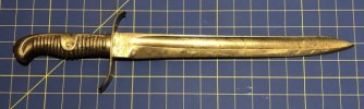

THE ROYAL JORDANIAN ARMY KNIFE Inscri11THE ROYAL JORDANIAN ARMY KNIFE Both_t10
