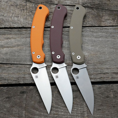

What kind of folder do you carry?
Very nice. These Aluminum scales ?
Thank you, and sorry I missed your question Roland. Yes they are aluminum with Cerakote.
