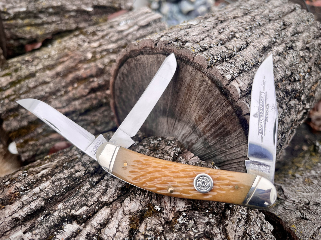

The Premium Stockman though, could use a bit of toning down. I've been thinking about dying it for a couple years, but haven't decided on Rit or the Fiebings leather dye. I'm not in a big hurry. :)
I used the dark brown Fiebings leather dye. Cleaned it first with acetone and heated it up in a 200 degree oven for about five minutes a couple of times. It just keeps getting darker each time. I thought that I would give it a few days to set in or fully dry, then I'll swab on another coat or two.
How about potassium permanganate?
I have never gotten results that I like with PP. It usually just changes the color a little bit. Maybe I haven't used it correctly. Any tips on ratio to mix, etc. ?

That turned out nice ! One of a kind ! 👍😍 Did you dye it yourself ?
Nice! I’m also interested in how you dyed it.
Ditto, that looks great!
I was contemplating yesterday with all the dye talk about doing mine in a nice shade of green...
Do you care to share how you went about doing the dye job or any tips?
Thanks guys! I more or less followed the steps laid out in one of the threads on here named “dyeing bone” I believe. I used RIT dark green dye for natural materials, but I’ve seen the synthetic work just the same. I filled a sauce pan with enough water to cover the knife standin on its spine. I pulled the blades out n taped em. Im not sure if that was necessary or not. I put the whole bottle of die in with a bit of salt n a few drops of dawn dish soap. I was not scientific with how much of either I put in. Brought it to a simmer, mixed it lightly n left it sittin til I got the saturation of color I was lookin for. Turned off the heat n let it cool a couple then pulled it out n let it air cool. Rinsed it thoroughly, polished n oiled up the blades n joints. I found the walk to be a lil bit sluggish at first but I flushed with water a couple times n re oiled a few times really workin the blades n the next mornin the walk n talk was back to how it was outta the tube. I am really satisfied with how it came out.
