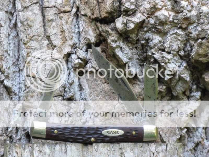

Taking after Doug Add, I decided to have a go at dyeing a Case stockman which came to me with particularly unpleasant bone.
I suppose it looks good enough here,
But on further inspection the dye job is inconsistent and there are several outright white spots. Either way I don't believe it lives up to Case's label of "Dark red bone" which so attracted me to try one in the first place. This will not do!
2tsp of RIT dark brown and 2 cups of water, 15 minutes simmering, and a quick rinse and relube yields some satisfactory results.
Compared to some other generations of Case red/chestnut bone (both from the factory.) I'm quite pleased.
And no, this knife did not come from Case with two clip blades ;)
Good job, I might just keep my watermelon bone sowbelly stockman and try the same thing.
