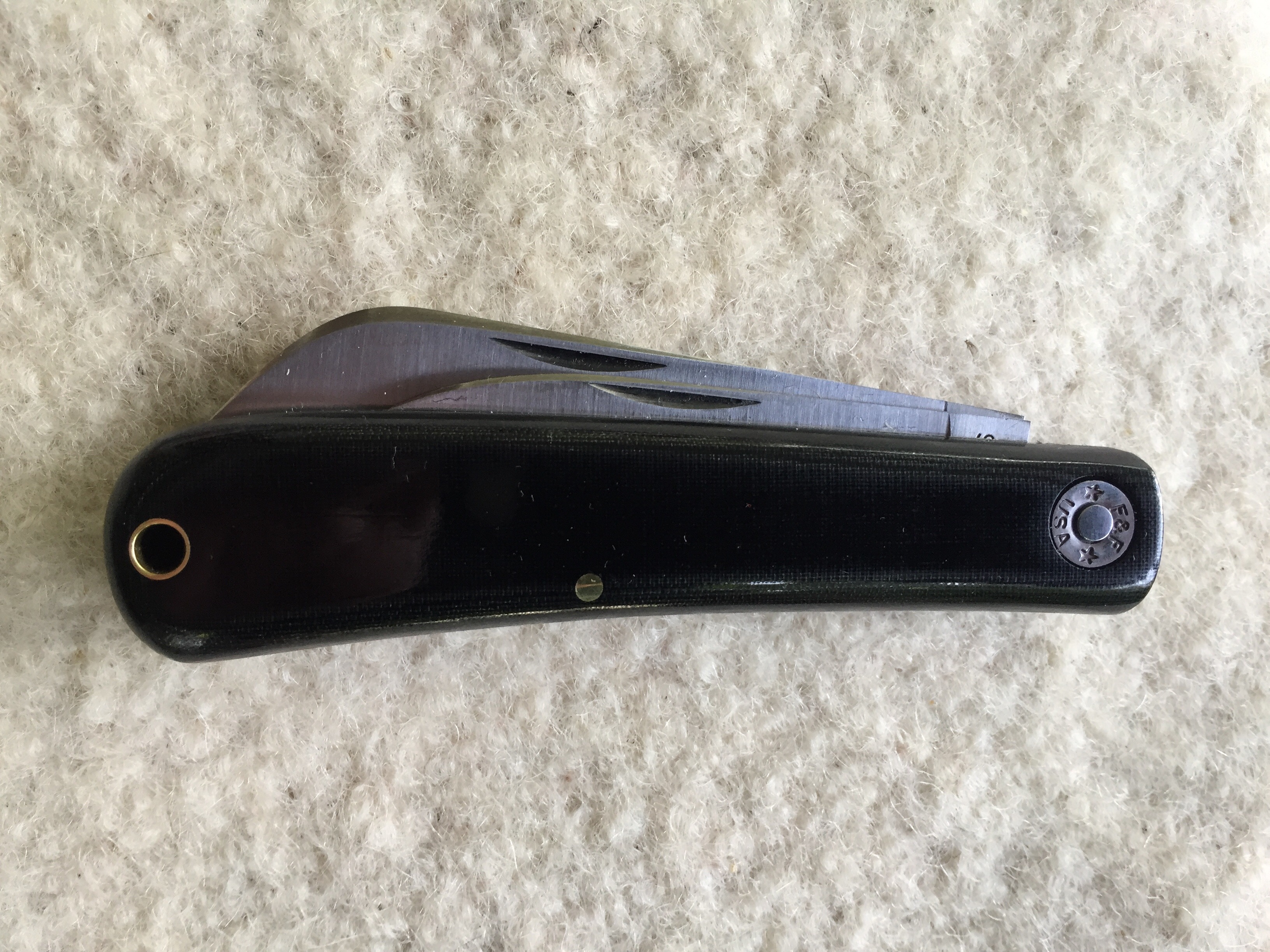

After doing a little trading for this 66, I was offered a 56 I couldn't refuse! I've been looking forward to both these patterns for some time now.
72 in stag. After liking the 72 in micarta I decided I should try the stag and see which one I liked best.
The loser may be on the selling block along with a few others to raise funds for the 77 Barlow.
