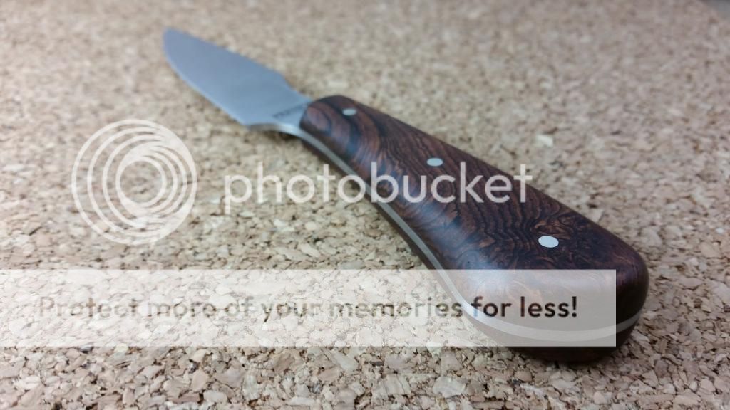

Desert Ironwood

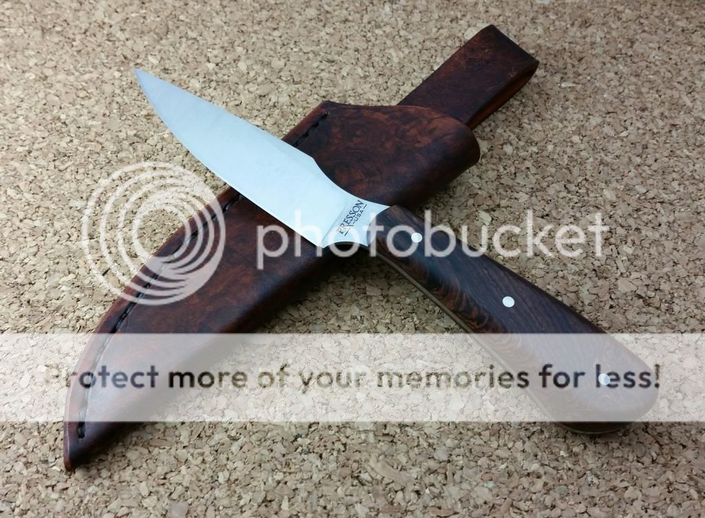

First one off the bench for 2015
A nice skinner in 1/8" AEB-L with a Rockwell of 60.
Blade full flat grind and is 4" to the plunge and 1.25" wide at the ricasso. It has a nice machine satin finish.
Handle is Gabon Ebony with red and black liners and has a nice aggressive tapered tang.
I made the Loveless bolts for the handle with Nickle Silver and brass bolts.
OAL is 8.75"
Thanks for looking

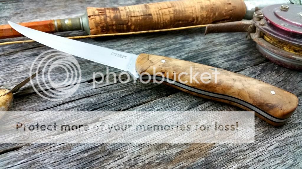

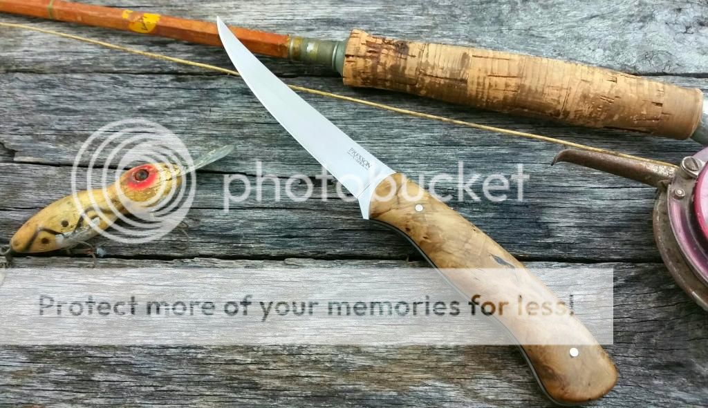

Three kitchen cleavers in process, already hardened at 58RC, Bohler N695 (440C)
Pablo

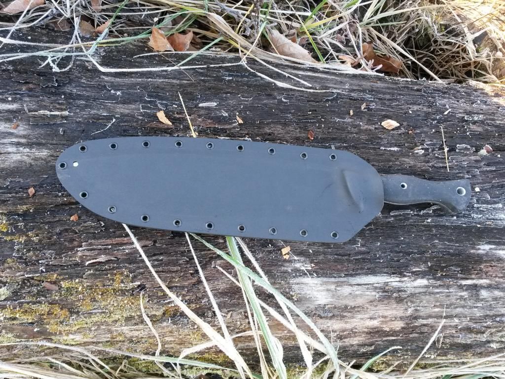

Finished up this 52100 Bolo chopper for a customer recently. Its a complete monster. Came out a little under 3/16th thick with a 13.5 inch blade.

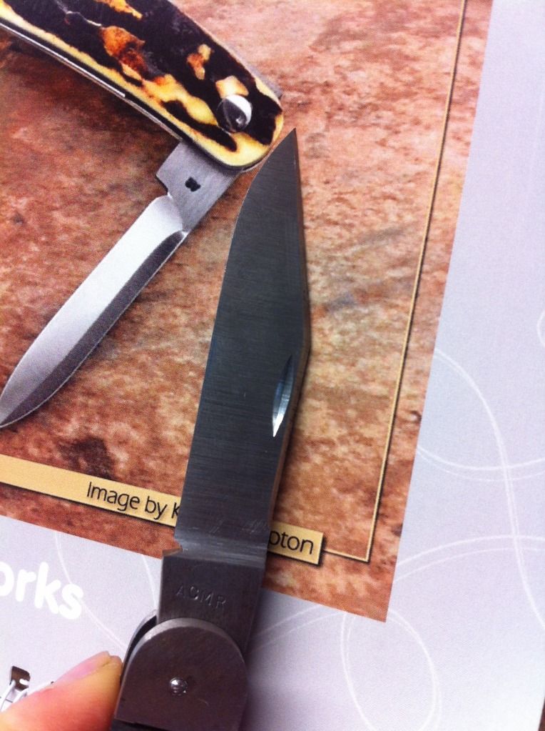

aslink, I just caught a look at your shop tools and work. I believe your folder work will go well. I hope to be able to help guide you all the way through. Frank.

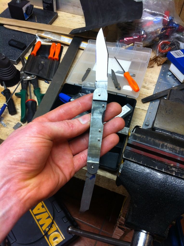

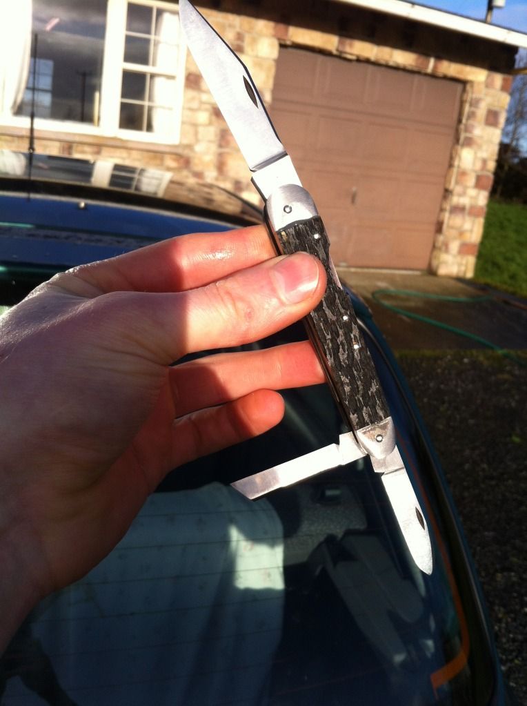

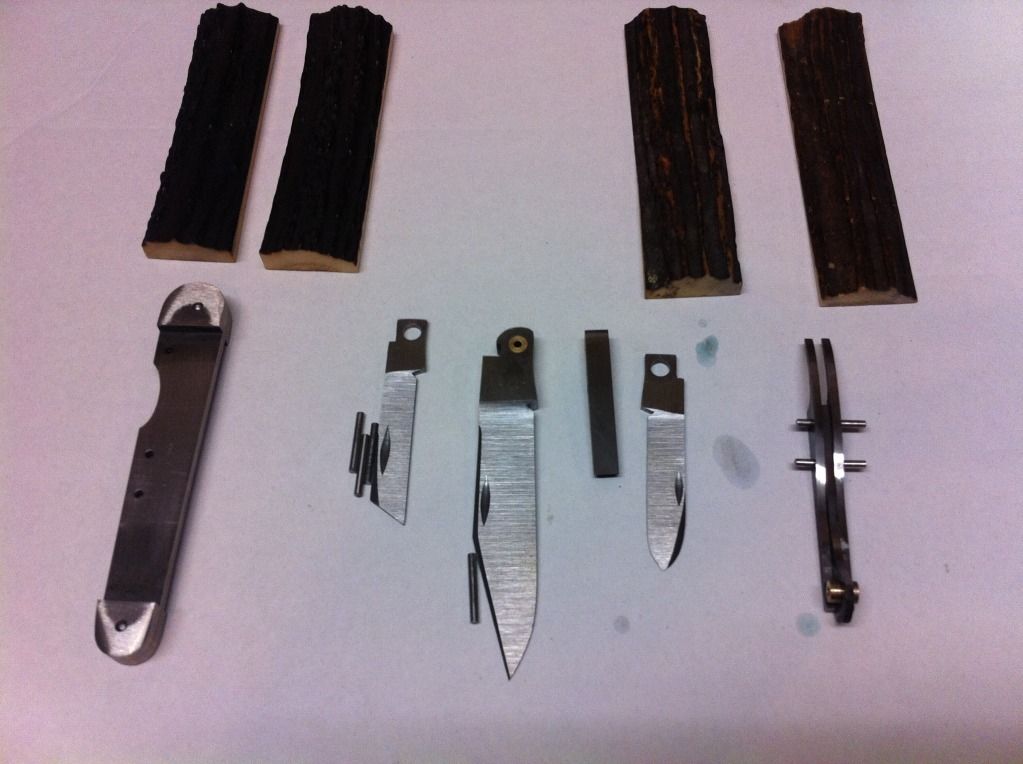

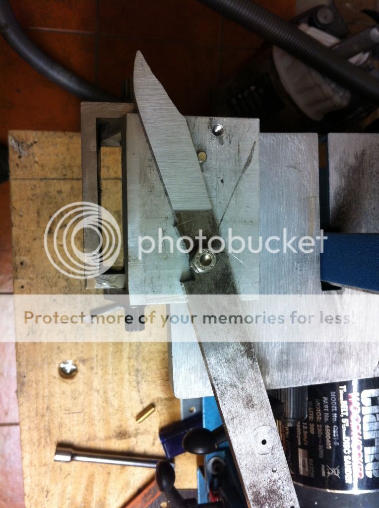

well as usual my own shop is rather more like my kitchen...it is in fact! anyway here is whats going on in my kitchen lol
dry run after roughing the scales, I will assemble the knife some time in the next few weeks hopefully!
