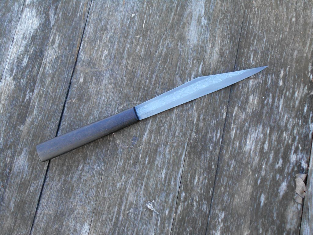

A little while back I posted a picture of a forge and venture type burner I built. I have been playing with it. It seems to work well, the question was whether it would make welding temps. Several days ago I thought about that once too many times and put together a small billet (4x1x7/8) of 1080 and 15n20. Having no press or power hammer, well you know how that goes. So this is the result of an 8 layer, dry welded billet from my forge. I am happy with the result, but need more and bigger tooling! Jess

That looks pretty cool! I haven't seen much damascus with that few of layers.

nice way to end the year Don... the lines at the ricasso area are absolutely awesome. i can't find the right word for the way it flows, but the contrast with the rounded inside and that clean plunge line are outstanding.
Thanks Dan & RR, I may have started on another addiction. Jess

I usually think damascus steel looks very tacky, BUT that looks brilliant. Actually it's the single best looking layered/damascus I've ever seen. ;)
Please can you do a photo heavy work in progress on the whole process for us?
Jesse, I am a 64 year old knife maker who only makes knives by stock reduction as I have no blacksmithing skills. I buy pieces of Damascus to make knives sometimes and most of the Damascus has many layers. Your blade is beautiful and interesting. Very different and very cool. You should think about making some more. It will make a great knife. Thanks for sharing. Larry
"octomascus"
I think this knife found a new name, thank you. Guys thanks for the kind words! Samon and Larry, this is doable by most everyone. I will be 64 in April so age isn't a factor. This is my first attempt. My lack of hammer control was evident. If you have access to a forge with welding temps and an anvil you can do this. This was a dry weld (no flux), all of the scale and oxidation was ground from the steel before tacking the billet together. After that it's just like you have read in all of the Damascus posts on this forum. One important thing, when the billet cools to the point you cannot feel the metal move when you hit it with the hammer, re heat it. I found it easy to feel the difference between hot and too cool. I will make more. But you should try it! Jess

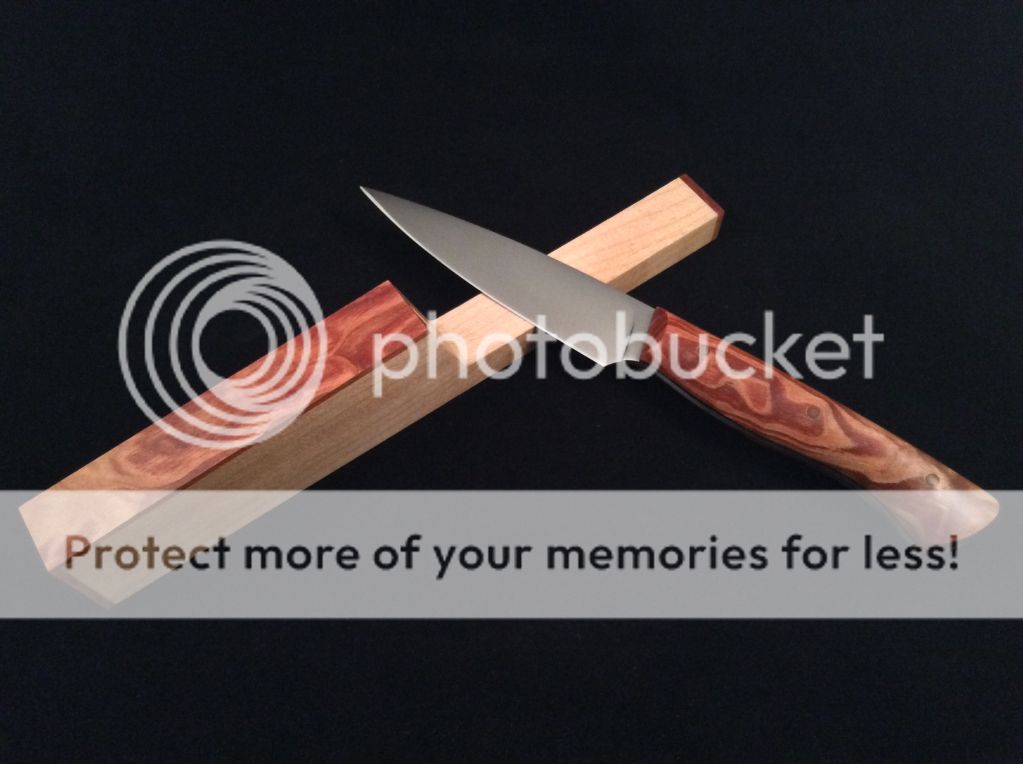

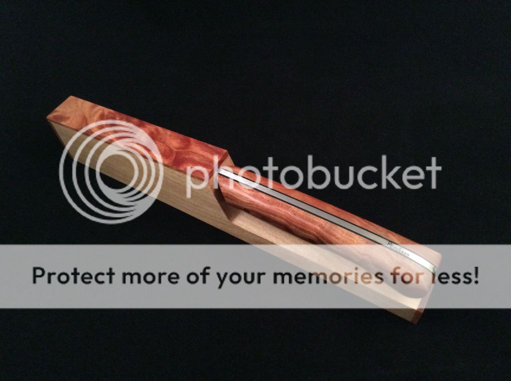

Finished up this paring knife for my sister. It's 3/32 52100 with stabilized figured pacific maple. The knife block is accented with the figured maple.
