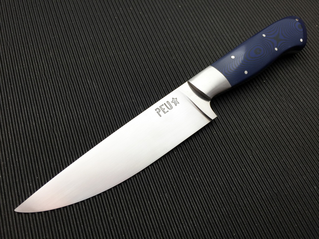

PEU: How did you secure it to the blade?(Pins?)
Daniel, I do the following:
I use 3mm 304 stainless rod for bolsters (which are also 304), having the same steel is important so they age in a similar way and your pins stay hidden.
Also have 3mm brass rods
Cut two pieces of 304
Drill one at a time clamped tightly
Once both sides are drilled I join them together with brass pins to do the front curve 36-120grit using the flat and 240 on the rubber wheel of my grinder so its smooth.
Then I do the opposite side, top and bottom are rough last as I want to finish them once the bolster is properly attached.
Using the brass pins I join the bolsters to the blade and hammer them in place so I can rough taper the bolsters
Once tappered I remove the brass pins (a PITA **) usually by drilling with as 2mm drill, then putting it on the vise and rotating, the 0.5mm walled brass cedes rapidly.
On the outer side of the tappered bolsters I oversize the holes with a larger drill just a little, so the pins have a place to expand when I hammer then in
Cut two rods of 3mm stainless with about 1.5mm excess in lenght on each side.
I have a large chunk of stainless I use as an "anvil" it has divots of different sizes so I can put the pins on one of these holes and hammer and they expand uniformly
Using a light peening hammer I deform both sides of the pins so they "seat" on the expanded portion of the holes.
Then using a 500grams hammer (1.1lb) I finish the work with a 5 minutes hammer solo :)
Then the magic happens in the belt sander, pins blend and dissapear.
Thats it.
In the past I didn't used the brass rod and the enlarged holes, but from time to time pins reappeared after a very nice finish, which is a royal PITA, and since a royal PITA beats a plain PITA (**) I decided to go this way :D
Pablo

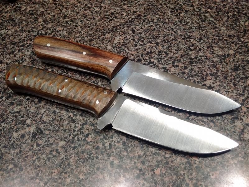

My first two completed knives. I'm not too happy with the handle on the second one (top knife - too short and needs more sanding) but each mistake is a learning experience. They are made from W2 and after doing a cutting test with the bottom one I think the steel is a pretty good performer. The grind line on the bottom one is out of wack due to a divot in the blade. The other side looks good.

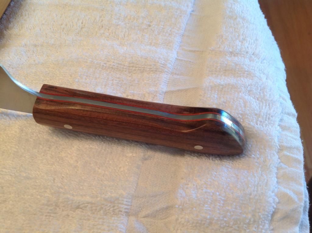

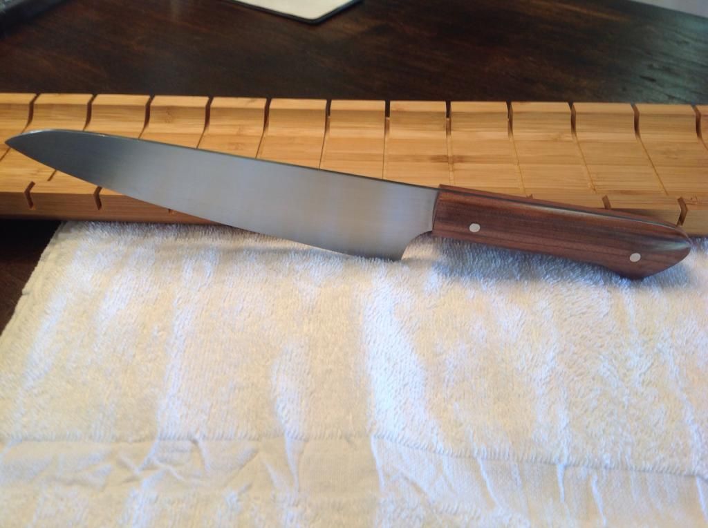

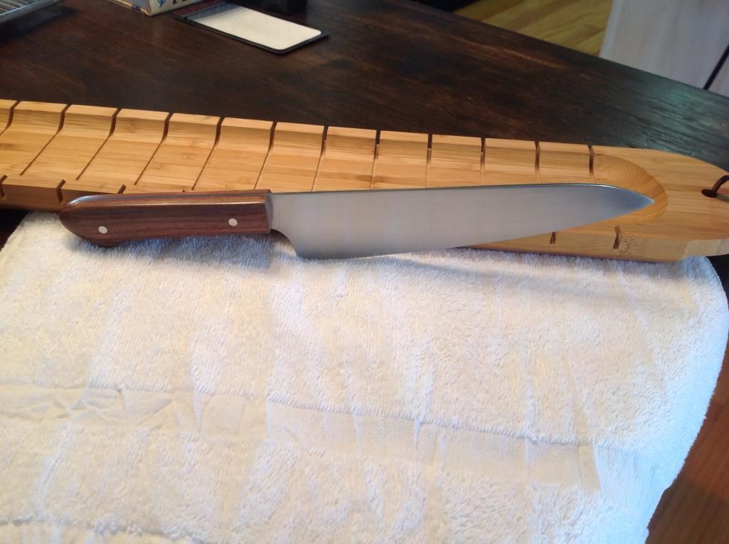

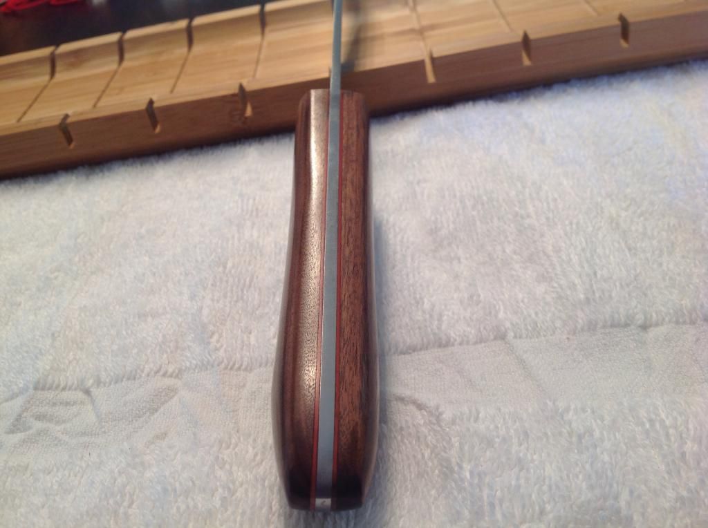

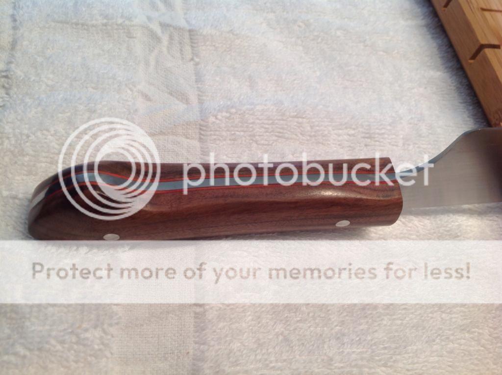

I also tried my hand at the no plunge line on a gyuto. I used Bolivian rosewood scales. I wish I could get the grain to pop. They are sanded through 1500 and buffed. This is my second gyuto and it turned out way better than my first one.

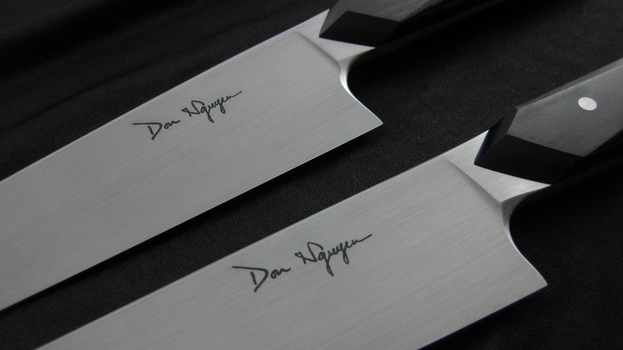

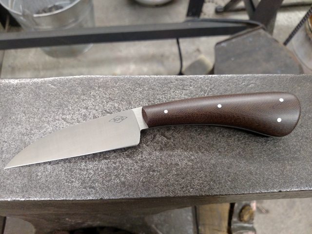

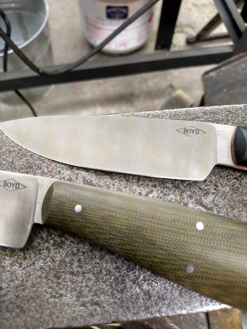

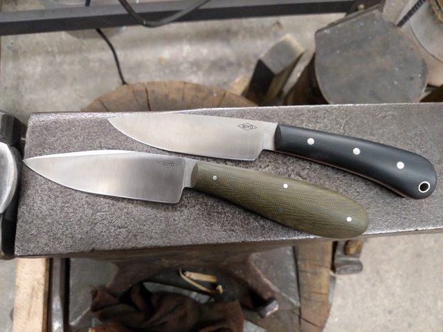

Finally got an etch stencil from Ernie and marked and finished up the first 3 to have my name on them, numbers 6,7, and 8 total. 1084, Green and brown canvas and black linen micarta.
