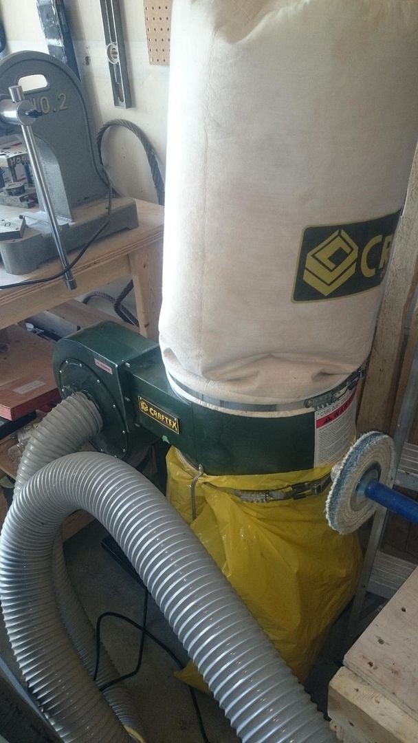

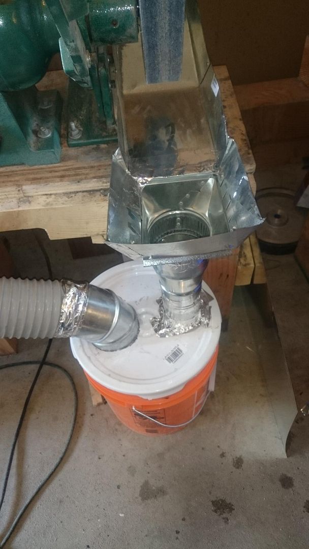

I finally added a dust collection system to my shop. I got a dust collector off of craigslist, and built the spark arrestor yesterday. It is working, but some water is getting sucked into the intake. I think I just need to add a blast gate to adjust the air flow.
Wouldn't the bucket and hoses make it hard to stand at the grinder?

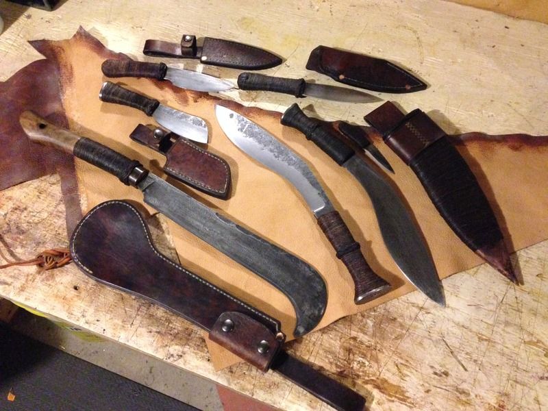

couple more down
all made in the dungeon from 1/8 in.alabama random damascus billet,full flat ground with stainless hardware

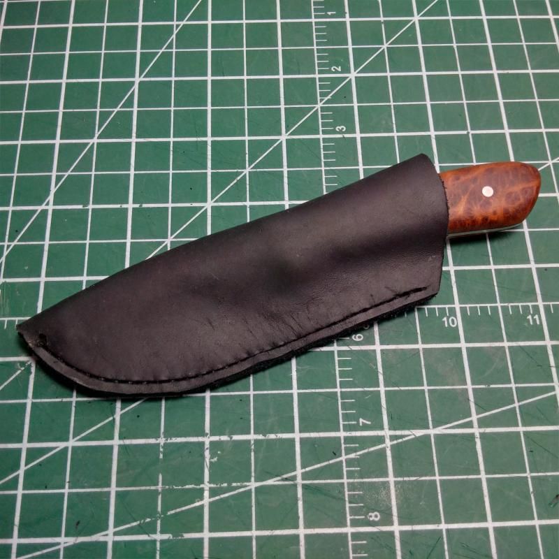

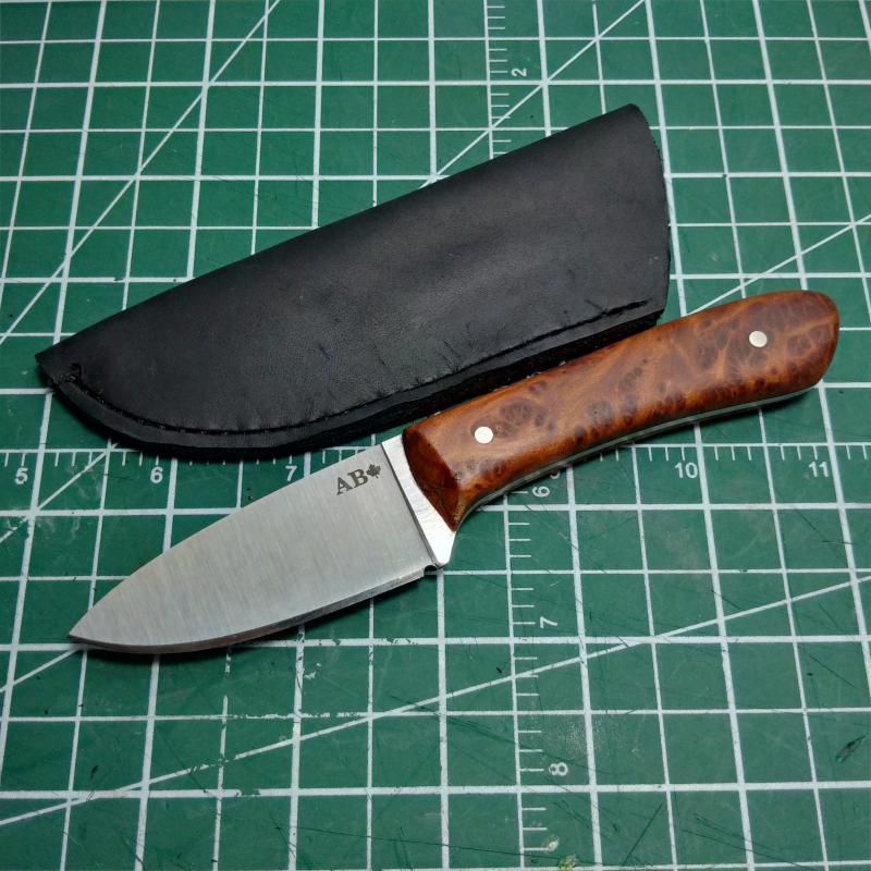

I made my first leather sheath. It's a pouch style for a small EDC I made. First time I've ever sewn anything.

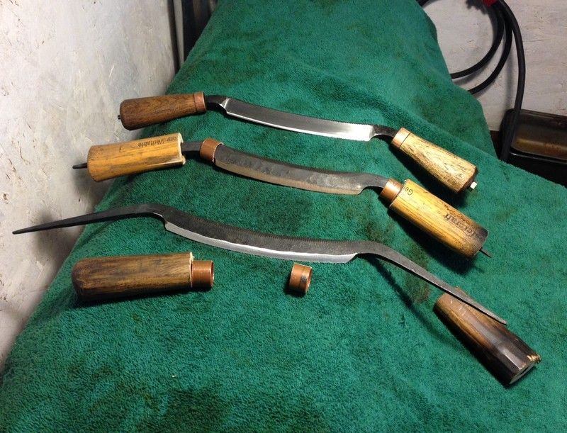

^^^ Nice work Rick!!! I like those draw knives...
EDIT: what brand of hammer is in the bottom photo?
That is rather awesome.... I love the handle contouring.

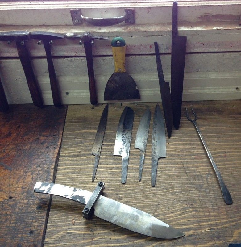

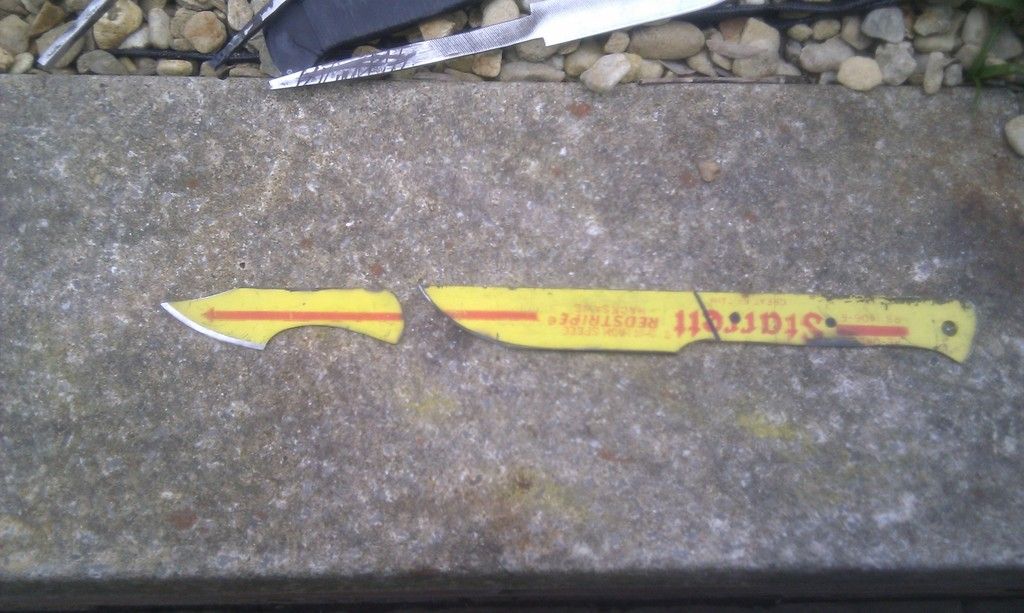

I found what looked like a murder weapon in a family members garage and thought it would make for a nice bit of steel stock to reshape.
And earlier today I chopped, ground and fiddled two blades from it. One a long handled general fixed blade and a little scrape necker.
First time I've dug the tools out for a play in a long time and it was so much fun. Much more medicinal than any crummy therapy!
Nice, Shane!

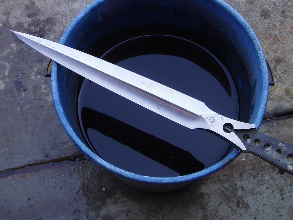

I just went and hauled home a 20" Powermatic vertical bandsaw for wood and metal... finished up my forging press finally this week, and squished some steel with it already. Just made a bigger (14") vertical welding forge to heat billets for it, too! Lots of tooling up happening around here.

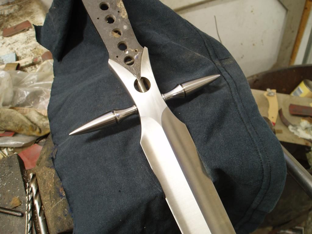

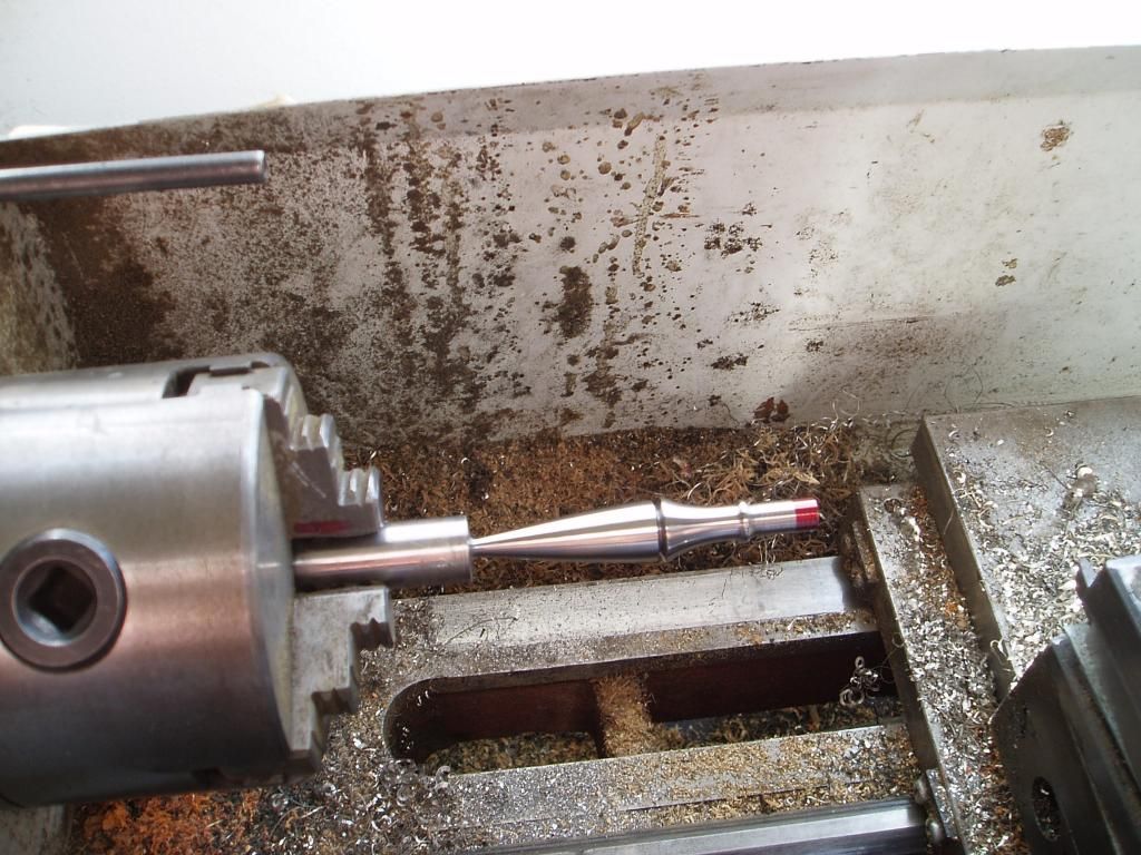

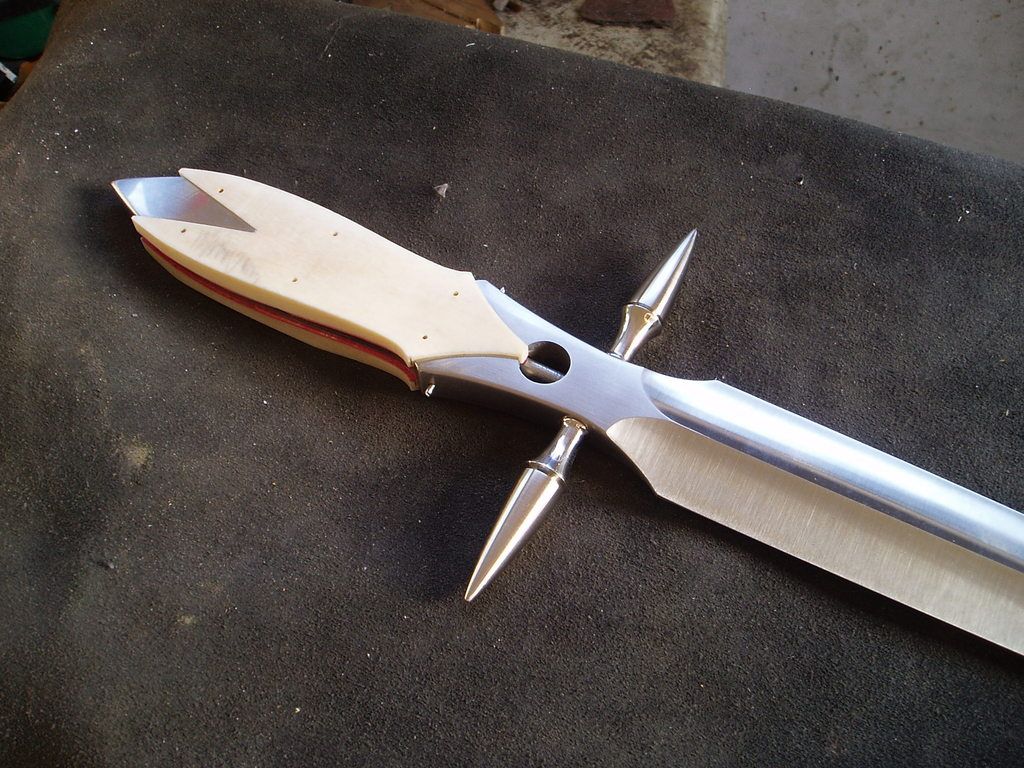

Integral dagger from 16mm thick 440C with a ATS34 tang insert. Hollow grinds are on a 4" wheel. Rear bolsters are 416SS. Quillons are 303SS. Handle scales are stabilised Giraffe bone. Got a bit of clean up to do yet then it's of for engraving, heat treat, and final fitting of the scales.
