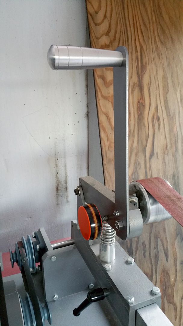

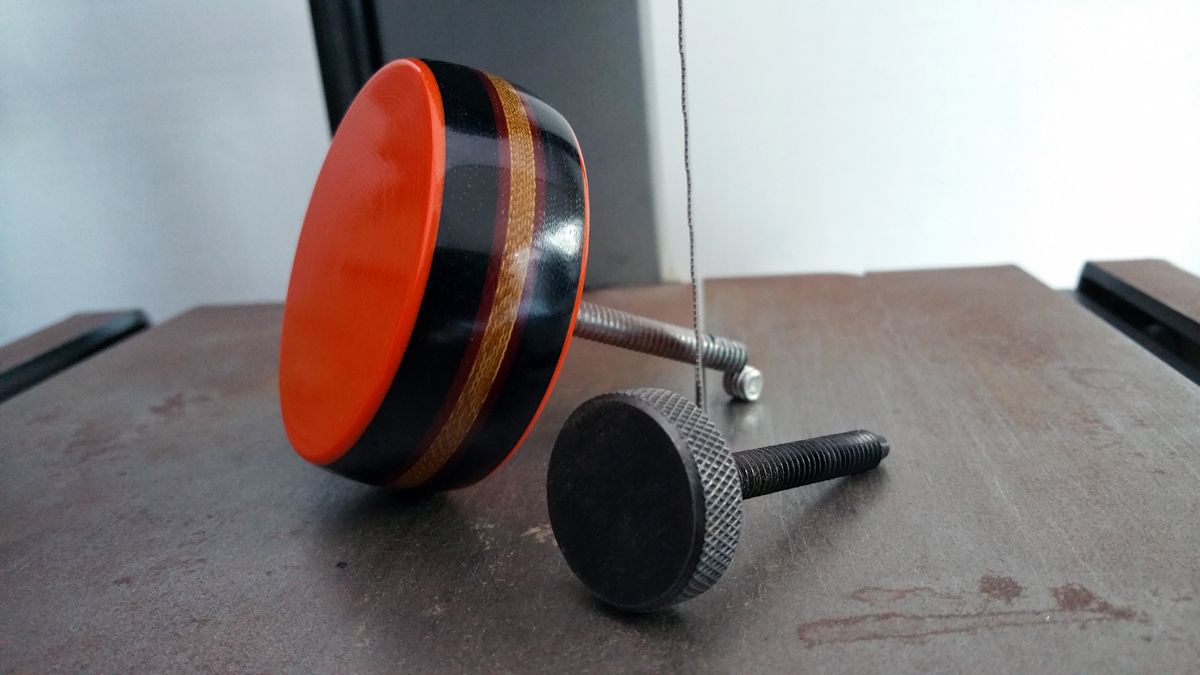

Mob, Cool tracking knob! These are good mods to make. You should now try a gas piston to replace the stock spring. You can order one from McMaster Carr . Try a 30 lb . Here is a photo of mine. It works a lot better than the stock spring in my opinion. Larry
Thanks Larry,
I thought about the gas strut, but right now the factory spring works just fine. More or less I'd probably replace it, just for the sake of modding the grinder, sure is fun making it my own. :D

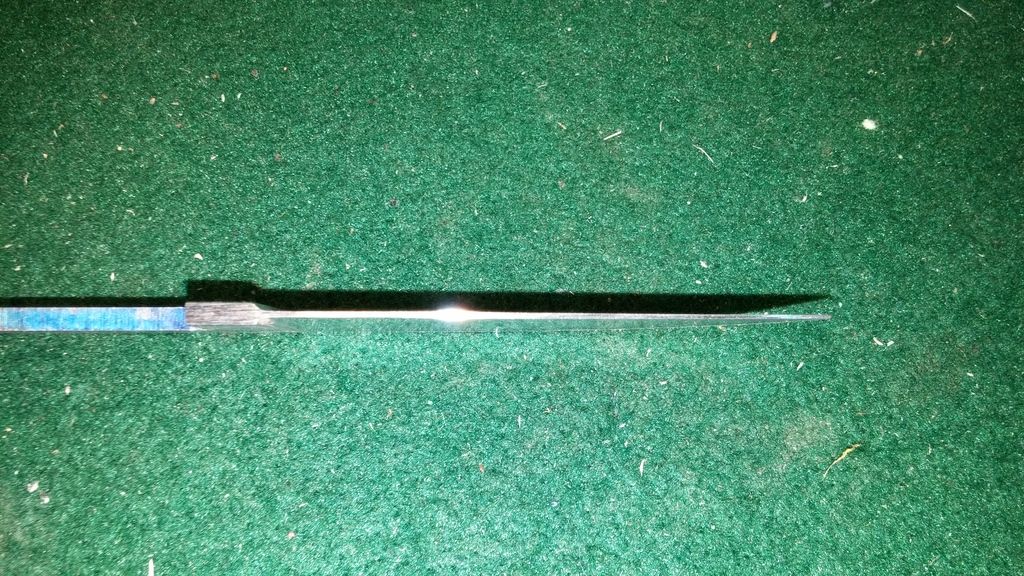

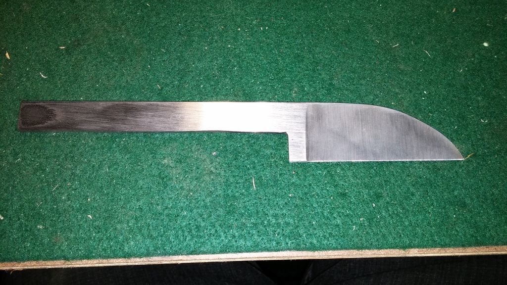

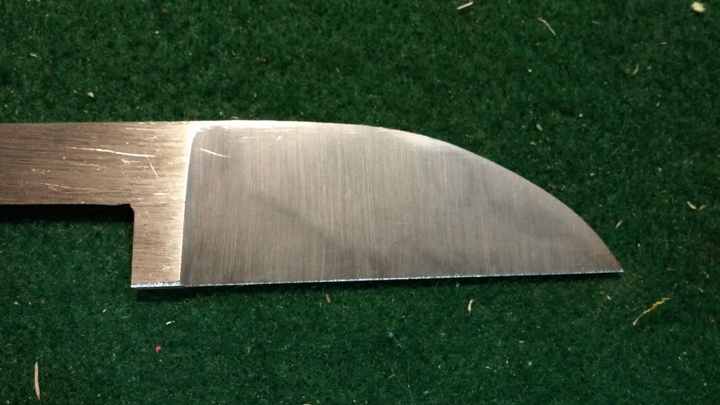

I finally got setup enough to start grinding some blades. Here is my first ever custom blade. I did the 'half full tang' to try to get a couple practice blades from my bar stock since they may just end up being trashed while I learn to grind. I think it came out OK for my first try. I left the edge area thickness at about .025-.030....I over shot my center when trying to get a uniform flat grind & ended up having to just put the edge on the grinder & make the blade narrower to get it thick enough for possible heat treat. I think I like it better this way, as it was almost the full 1.25" wide before. The tang will be shortened & I'll figure out my handle size & hole placement next. The lower portion below the tang will be filled with 1/8" G10 which matches the blade thickness.

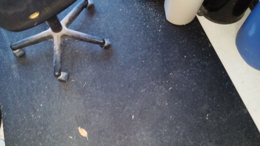

Picked up a rubber horse stall mat from my local tractor supply for $38 & like enough that I'll get one more for my work area. I have dropped a knife twice & buggered up the end, I'm hoping this will give me a little protection from drops, also, with my bad knee & flat feet, I'm hoping this will make it a little easier on my joints when i have to stand at the grinder or drill press. I'm also going to cut a strip off of one of these & see how they work for scales; I saw someone selling them but the price was high considering you can get a 4'x6' mat for around $40.
