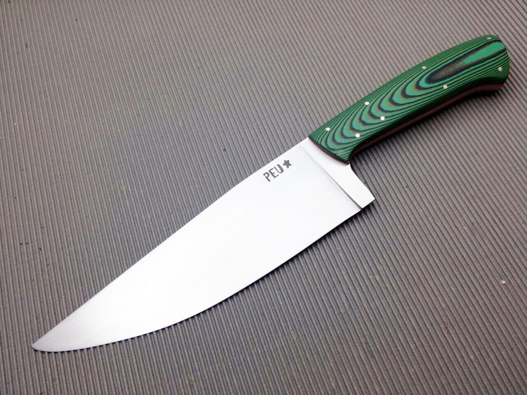

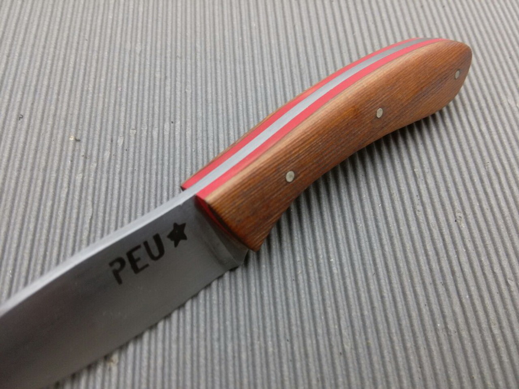

Lovely Kitchen set PEU!
My son Kevin, who is our bread maker requested a new bread knife; this is what I made.
It is forged from W2 steel. The hamon was produced using Brownells anti scale compound instead of clay. The handle is lacewood and hairy oak with copper. The OAL is 14 1/2 inches.

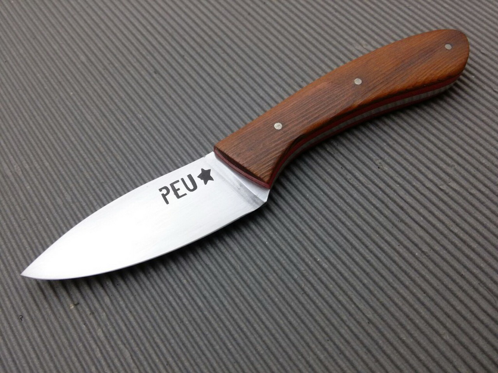

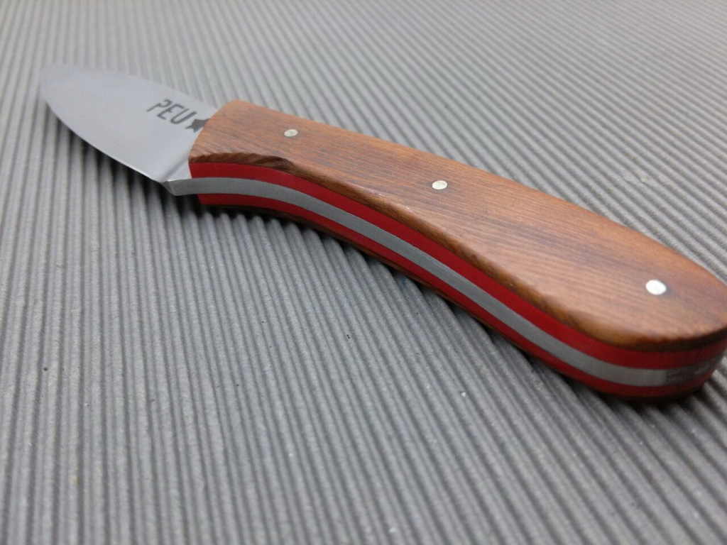

Published some micarta colors at ebay yesterday, but price with shipping is a little high IMHO...
Today I finished this necker
Pablo

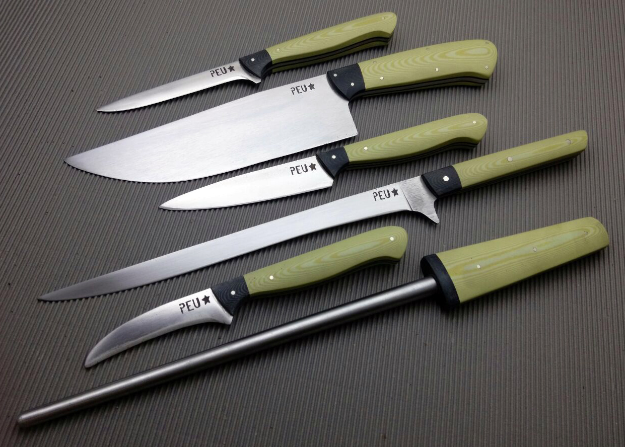

Palbo,
What type of steel did you use on the hone? I have been thinking of making some but didn't know if it needed to be hardened. Beautiful work by the way!

Beautiful! how thick is it?
That's pretty awesome Fred! That style of handle has always intrigued me, is there a good tutorial on here somewhere that explains the process?
Thank you! I forged four blades in the same run and they were all thin, really to thin before heat treat. This one is .094 at the handle/spine junction. I have a set of 3/4 x 3 x 12 inch aluminum plates mounted on a pattern makers vise which can be adjusted to fit the distal taper and align with the bevels as well. This helped to keep the blades straight after coming out of the Parks 50. I'll try to keep them closer to .125 on the next run. I made this to slice bread and being this thin made for a wonderful slicing experience. It slides through hot bread. :)
Thank you! I've always built hidden tang knives but have just started making this style knife, I'm still learning. I hope someone with more experience than I puts together a tutorial on the subject.
I do like making these because they are a knife made to be used daily and thats what knives should be made for, to work.
Fred
Palbo,
Steven, the hone can be any steel that can be hardened and tempered above 60~62RC, even an old round file with the teeth wiped out works fine. I made them out of 02 and also W1.
One trick if you want a minimum texture on them is to attach to a portable drill and run it at full speed against a running 36 grit belt, then you smooth it a bit with a 240 band.
BTW... another day another kitchen knife
