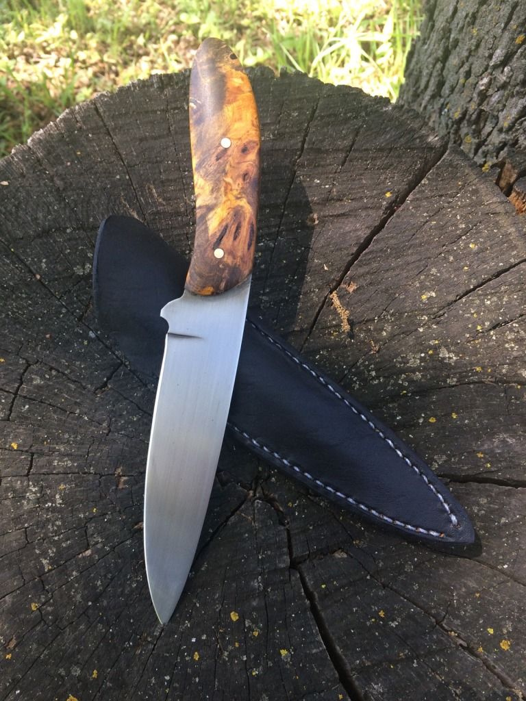

I really like those single seam sheaths Pablo :thumbup: Are you making them? We need a WIP for those!
Darcy
Thanks Guys, a friend of mine makes them, he is a professional leathersmith, will ask him if he wants to make a video next time I visit.
These micartas are betatest, none of them are in production, from this batch I like the most brown/black then dark/light grey and then light blue/white (our national flag colors)
Pablo
