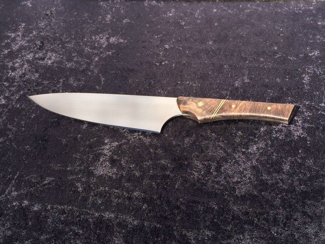

(I'm leaning toward the Claro Walnut)

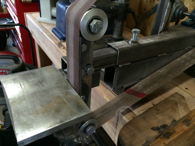

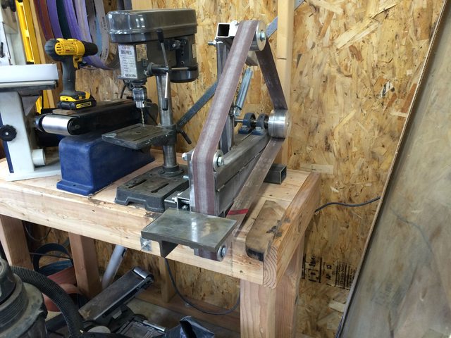

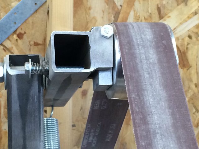

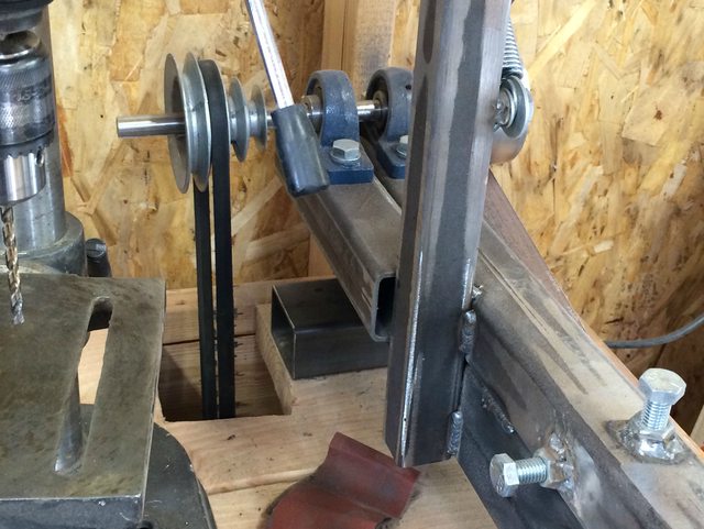

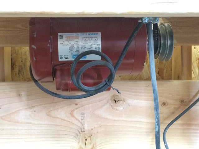

Since my grinder is not pretty enough to deserve it's own thread, I present my slapped-together, hastily designed, and perfectly functioning beauty of an ugly grinder. Made it up as I went along, made with a MIG welder and the two tools sitting next to it on the bench. Frame budget was about $100 including lots of nuts and bolts.
Plan on making a new platen soon with a good machined surface and hardened steel, it also needs to stand off from the arm more for clearance, which became obvious as soon as I used it, then looked at everyone else's. Still, I was half ready for the thing not to work at all, and it tracks, tensions, and grinds like a champ.

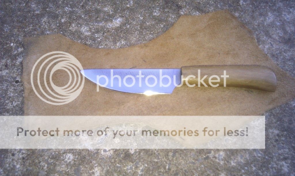

I guess I never posted finished pics of that blade I was working on a couple pages back. Here's a few:

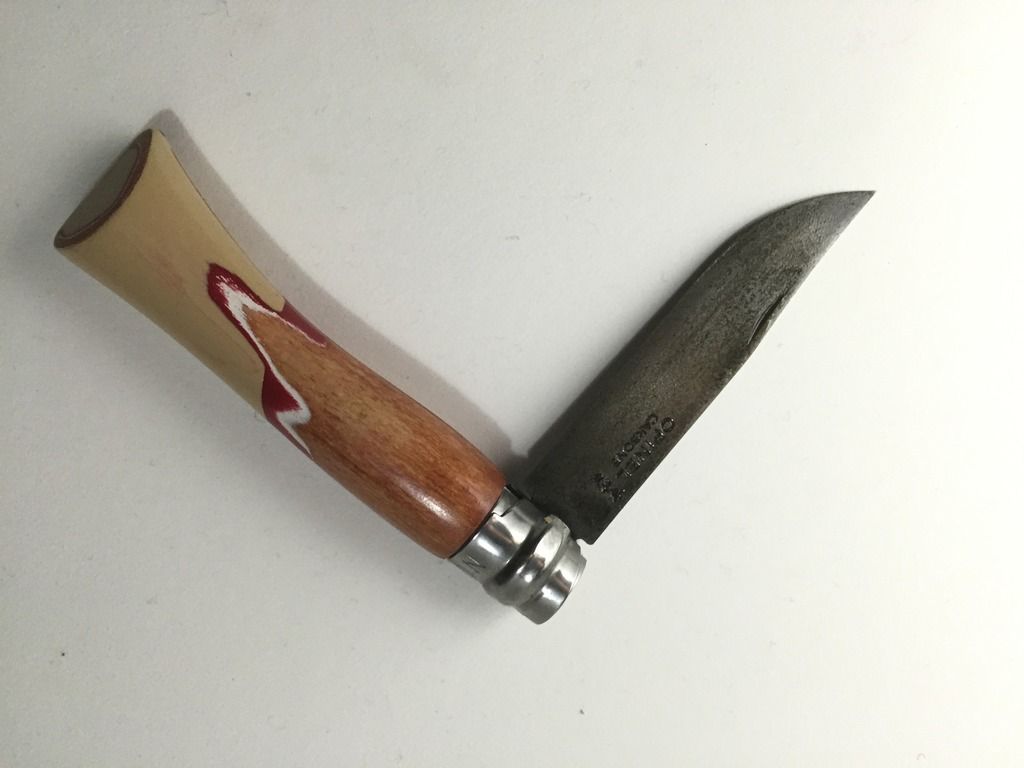

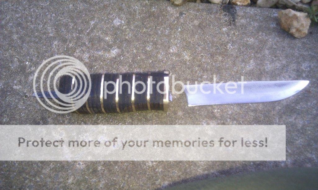

I was making a stacked leather and brass handle knife.. but it broke during handle shaping due to an overly hard blade.
So I reused the left over blade and..
Holly wood handle and mirror polished!
It's only little, something like a neck knife.
The remaining handle was turned into an awl for a relative to being leather working! :) nothing wasted.
It was clearly a file, did you tempered it? 200~250C should be OK, otherwise it will break again almost for sure.
Pablo
Pablo
I tempered it by eye with a blow torch. It passed the file test during reshaping and sharpened up easily. And as it'd so small I figure the extra hardness it may still have won't be an issue due to the practicality of abusing such a small knife.
I do have more files though, that I will turn into larger knives. All reputable brands from England. Do you advise I just temper them too? and not a total reheat treat and then temper?
Samon, when I made knives from files I always normalized the steel, shaped it and the gave it proper HT following 1095 or W2 datasheets.

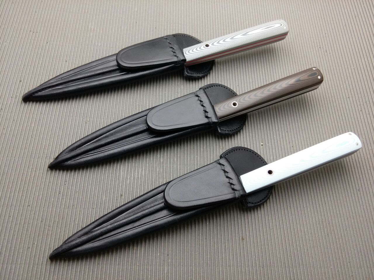

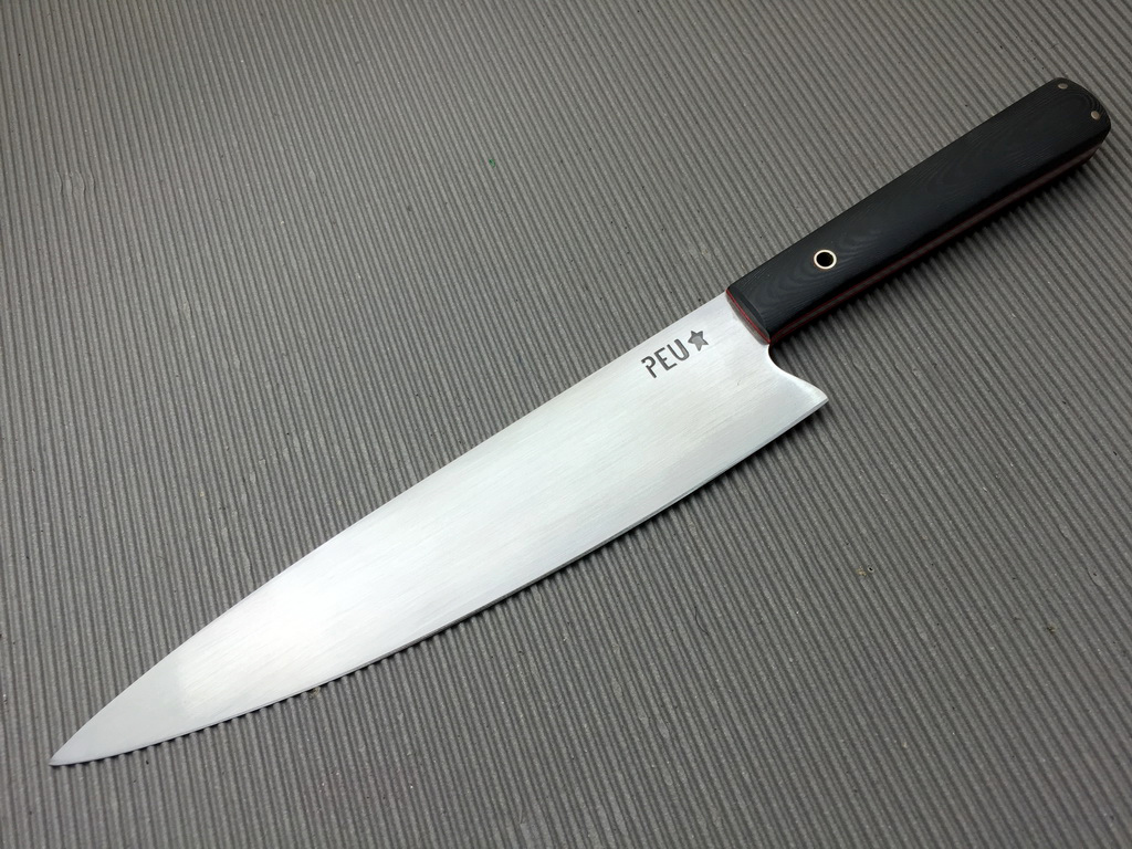

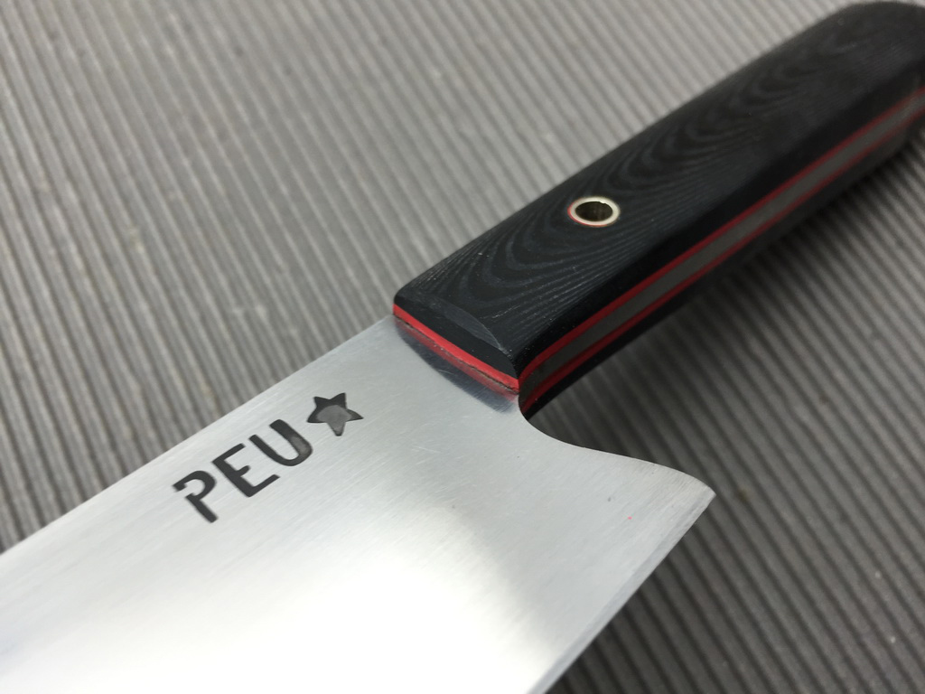

Finished this Neo Criollo today, its made of 3mm Bohler K720 (O2), blade lenght is 180mm, OAL 285mm. Handle and liner in paper micarta. More photos at the gallery

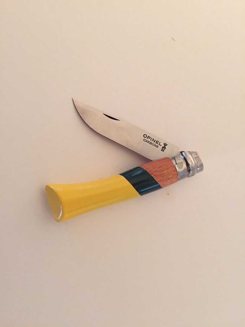

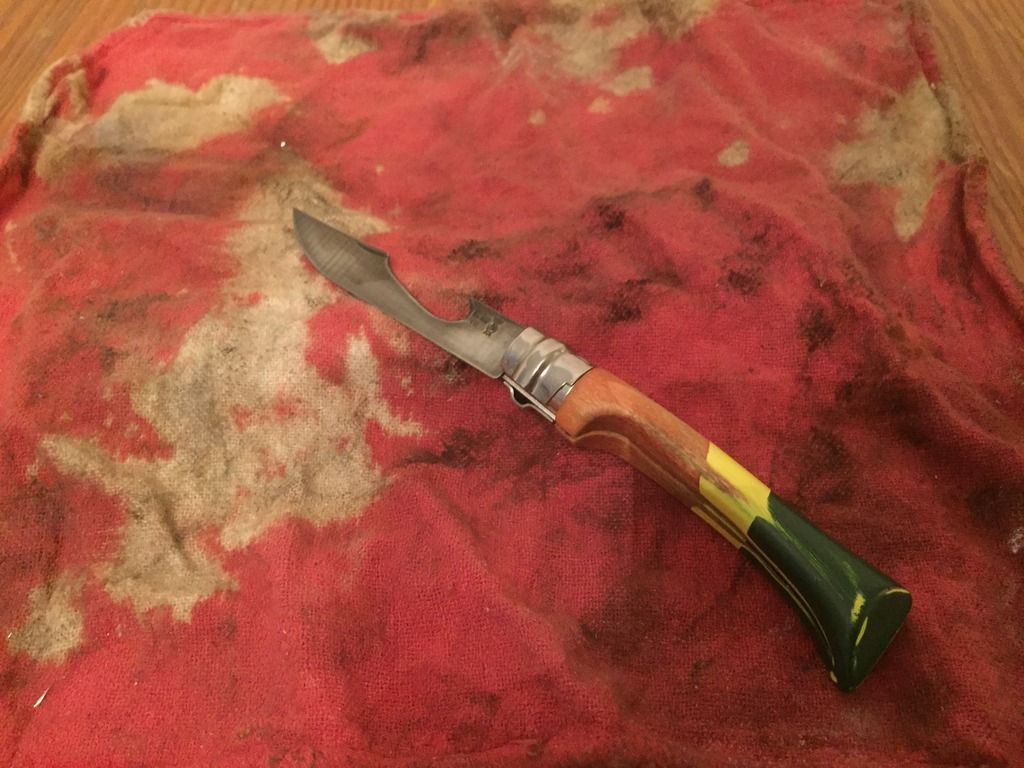

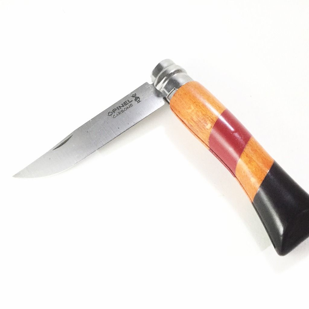

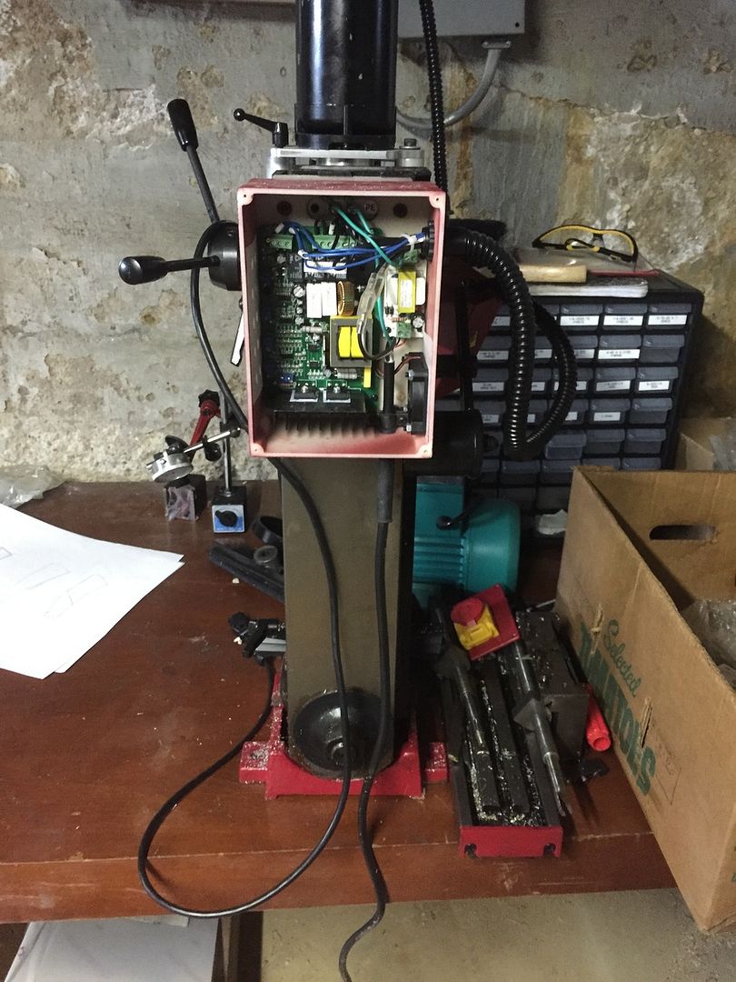

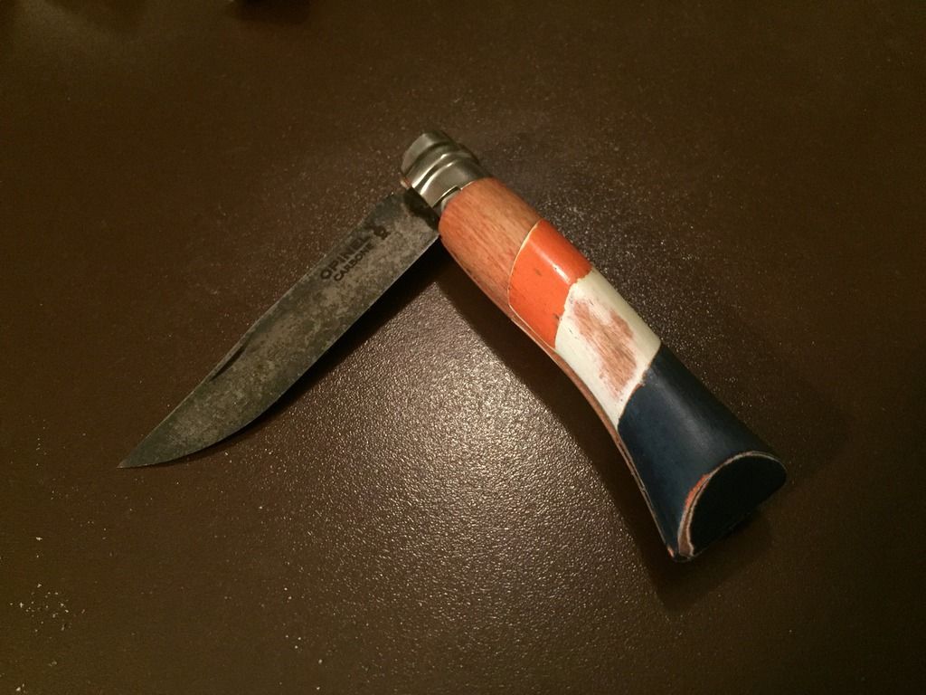

So we've moved...again. Hopefully for the last time for a while. I've been doing a bunch of small side projects until I can get the new mill and grinder up and running. In the meantime, I've been doing some axe restoration, and a lot of customized opinels. Shockingly, they've actually paid for most of the new equipment.

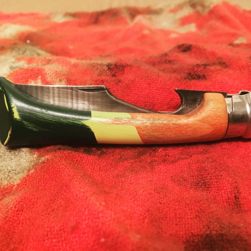

A new bottle opener variant in our Rustic line. Ranger paint scheme.

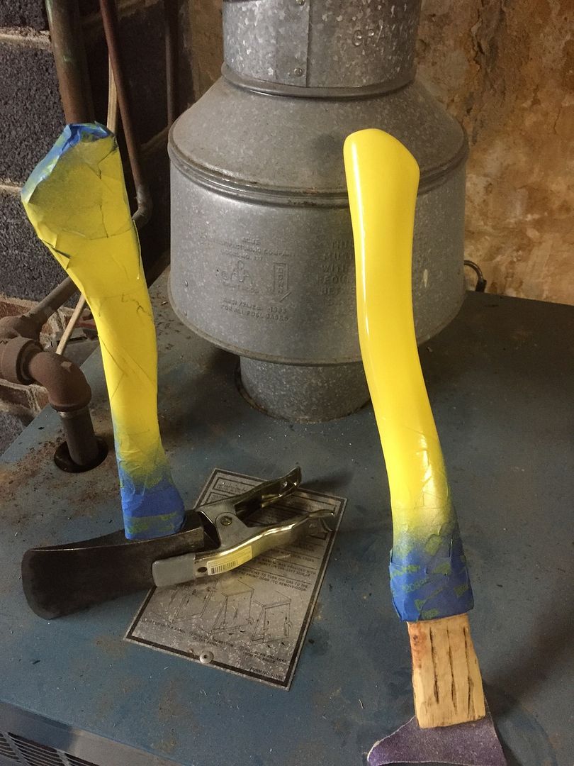

Some of the hatchet handles...
Part of the mill...

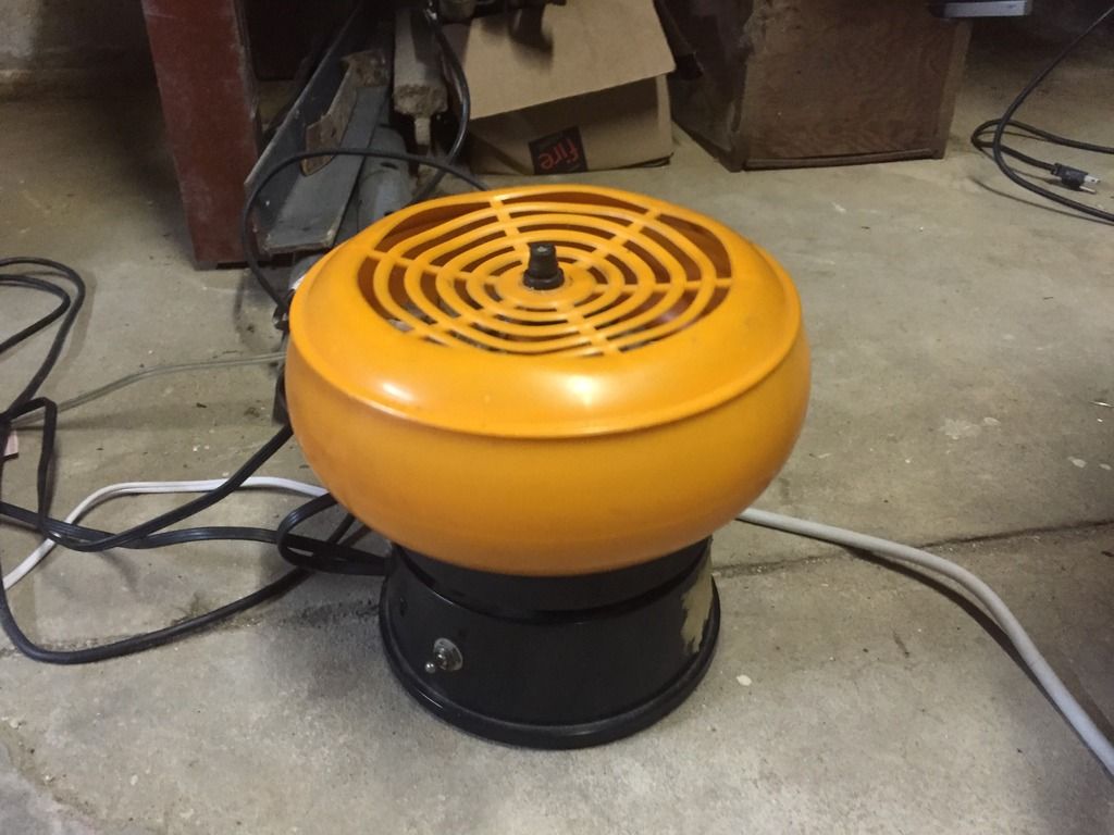

And early experiments in a stonewash finish....
Pablo, where do you find all these colors of paper micarta? I can only find a few solid colors. I like the ivory. I don't want real drastic color differences, but I do want some grain to show. Will it show in solid colors?
