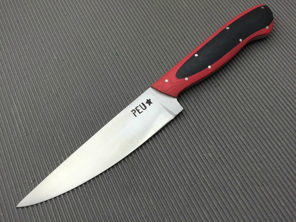

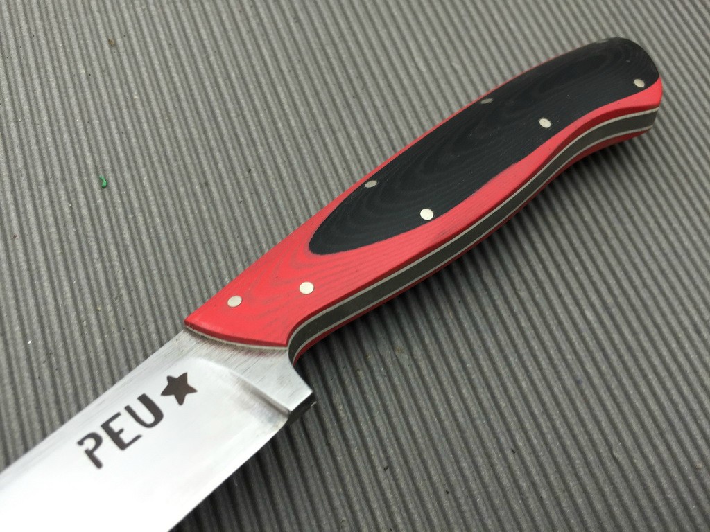

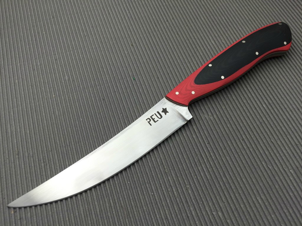

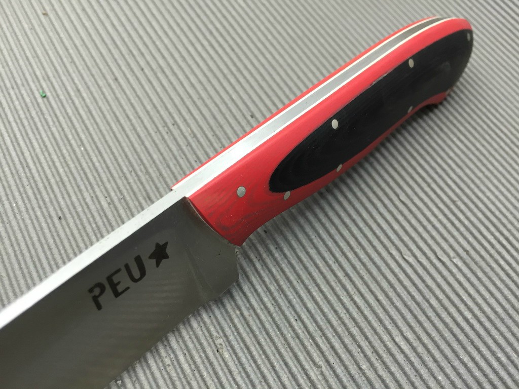

Combining micartas, yes, layers are glued.
and another model
Pablo
Lookin good Pablo. Whats the color combo on the red and the black? I guess I'm going to have to make some myself. Does anyone know of a company that will custom make colors?
and another model
Pablo
and another model
Pablo
Pablo, that looks awesome.
I'm interested in how you did that. How did you prepare the faces before gluing and what kind of glue did you use.
For a heavy contoured handle I need pretty thick micarta handle slabs that I can't get a hold of here in Europe. The largest around here are the 3/8 ones so I thought of gluing two 1/4 slabs with the same color together.
Thanks for any hints.
Andreas
Got it Matt, sadly I can't help as I don't make the micarta myself, I'm just the exclusive distributor.
Regarding glueing, I sand all the surfaces with 36 grit band and then use epoxy and clamp properly until its dry.
Pablo

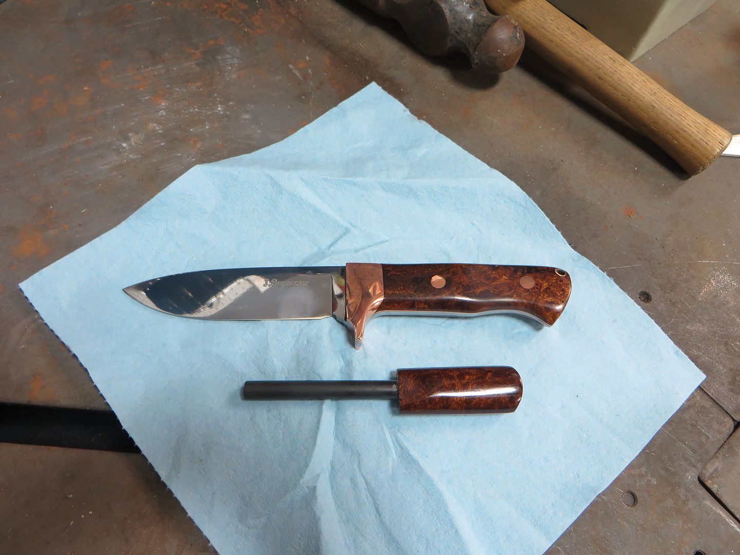

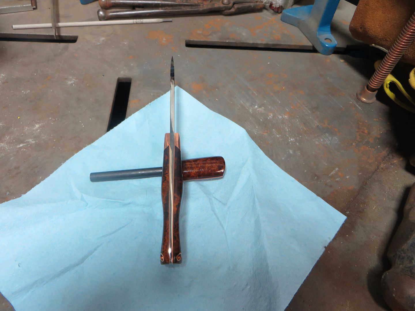

Almost finished this one for a local boy scout troop to be auctioned off. O1 steel blade. Flat ground. Tapered tang. Copper dovetailed bolsters, liners, corbys, and lanyard tubing. Ironwood burl handle with Ironwood burl ferro rod holder with a copper liner. Now I just have to get the sheath done.
Wow..
DO you have more pictures of tools you've made??
