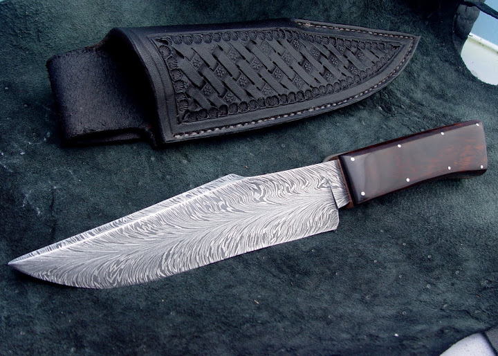

2013 was a productive year for us and a fairly healthy one as well. My son and I installed an anodizing line with twin 20 gallon acid baths. In the same building, where I used to raise beagles, we installed hot bluing tanks.
We applied for a second patent, this one is for a knife sharpener.
I did manage to finish up a couple of damascus pieces I've been working on over the last year. https://lh3.googleusercontent.com/-9iAmNxm9WuA/UpDwHBv6LII/AAAAAAAAEO8/CL3eW
c7Q3OY/s512/DSC02152.JPG.
Its been hard to find shop time at least for knife making this year.
A good thread with a lot of interesting post :)
Have a nice holiday guys, Fred
Sounds busy Fred. An anodizing line or even the blueing setup would be killer. That top knife is a beast, I like the handle on the lower one. Its not your typical style but looks useful and comfy all the same. Ive got bigger hands so the usual size and what not doesnt usually do me justice.

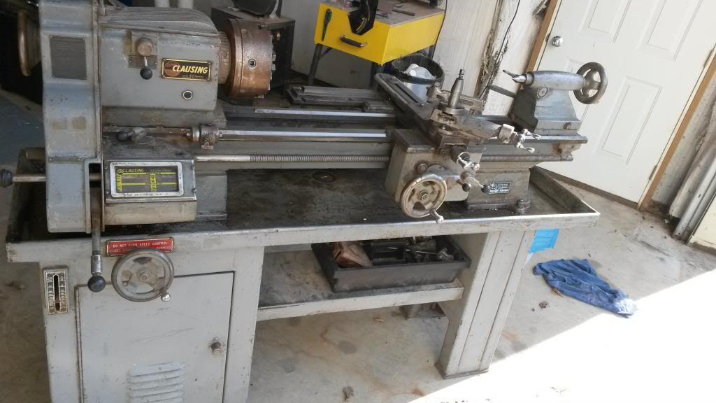

I picked up an old clausing lathe 12x36 with alot of tooling and a taper attachment a couple weeks ago. I've been so busy I haven't even had a chance to wire it up yet. Once I finish the belt conversion on my surface grinder Ill get it cleaned up and wired. I'm looking forward to making some pommels for daggers and maybe some EDC pens once I get a little more skill. Anyone have any tips for removing rust from the chuck? Also whats the best oil for the ways?
