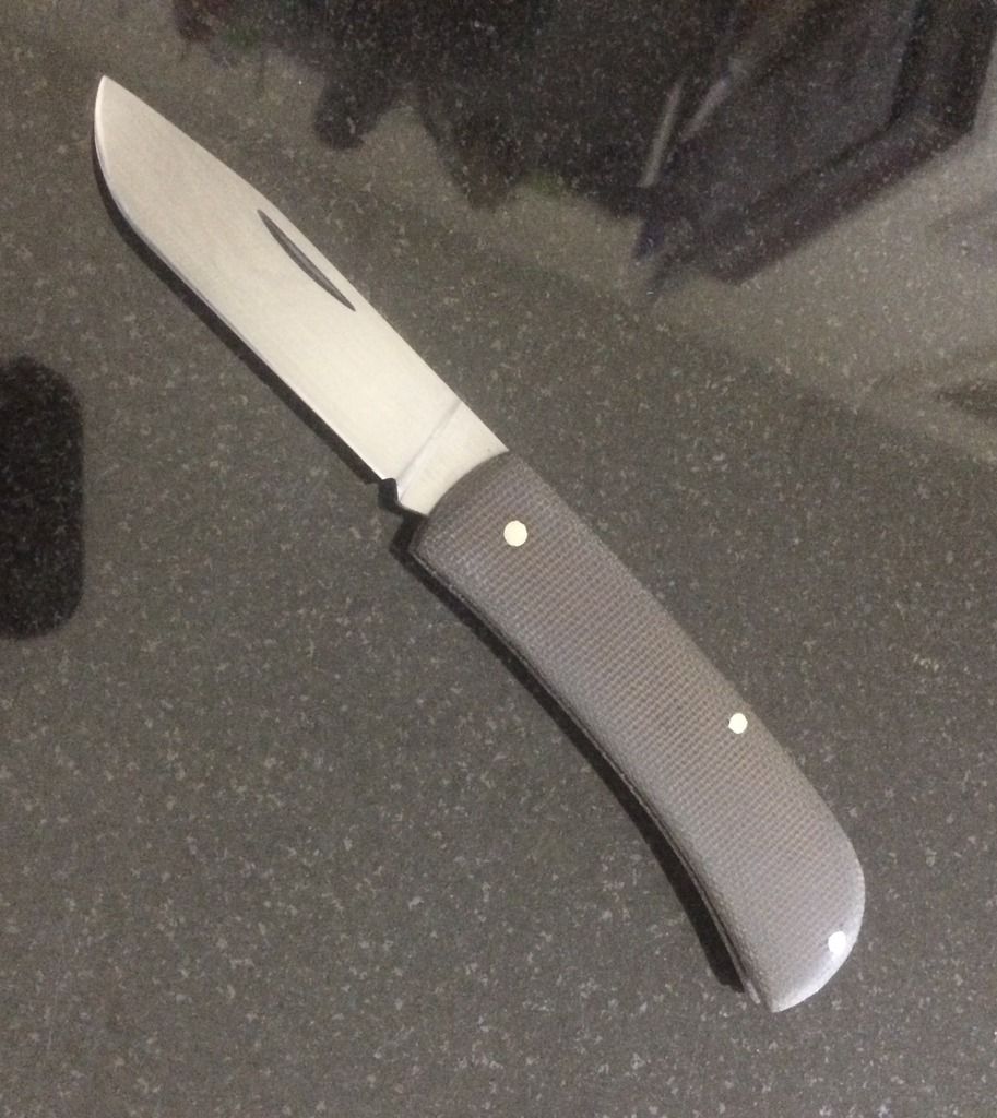

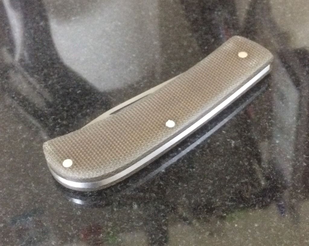

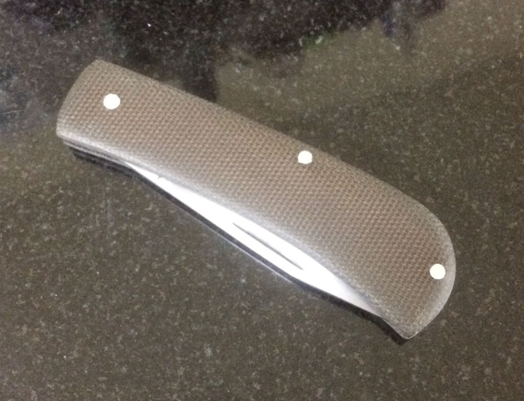

Just got this one done...
A Sodbuster Mini
It seemed the junior sodbuster was just a little to big for me to carry everyday in the pocket.
So I thought I would down size it a bit and thin it out.
Here it is next to a junior sodbuster I made last week.
This is now my forth slippy and totally addicted to them.
OAL 5 7/8"
Closed 3 5/16
Dark Green G10
3/32" 01 steel
Half stop
Flush in all positions
Relieved liners
Done on a 2x 42 craftsman
You seem to have the slippys down, I love the sod buster profile. I need to try and make one. Those are looking great.
Nice looking knife. I really like Walnut. Was the wood stabilized or how did you finish it?
Thank you! Yes I had K&G stabilize it. I finished it with Danish Oil. It finished a bit lighter than it shows in the picture. Must be my shop lighting.
