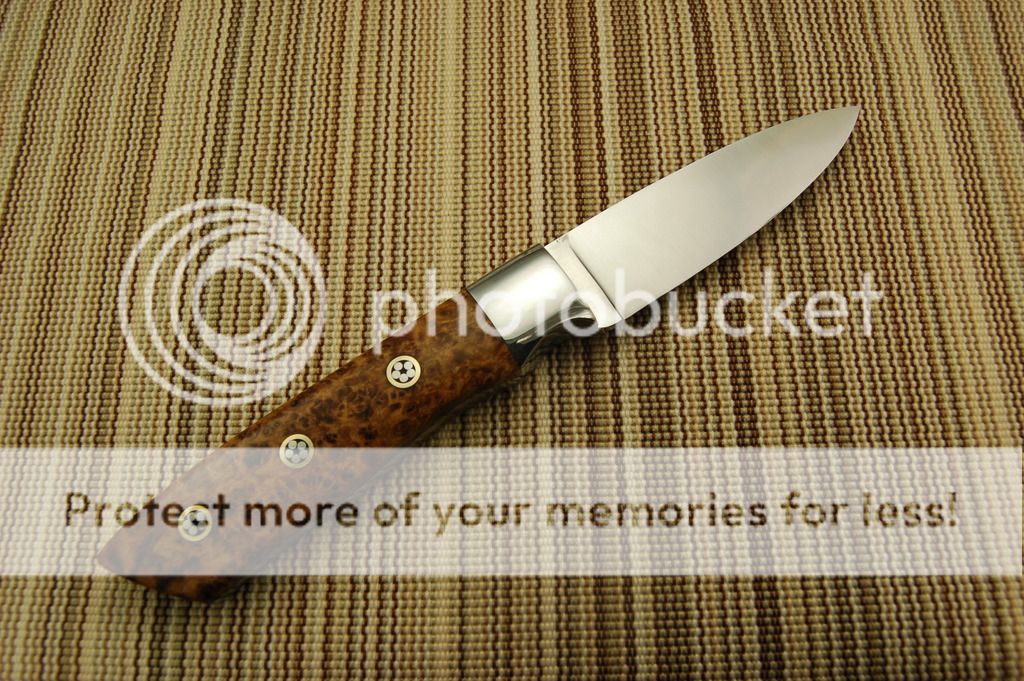

Here is the latest out of my shop. EDC in CPM-154, 416 SS pinned bolsters, mosiac pins and stabilized black ash burl. Not sharpened yet.
I like it! What did you finish the ground blade portion with. Wondering what grit or product left that scratch level. I am so hesitant to leave a rougher looking scratch pattern.
Thank you!!! I did my bevels post heat treat, I went with this progression dunking in water every pass:
60 cubitron
120 cubitron
A45 trizact
A30 trizact
Fine Scotch brite
Jay
