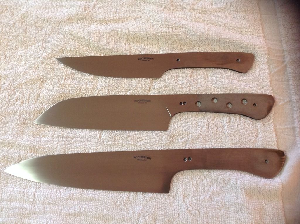

Got 3 ready for handles. Top is a petty/utility kitchen knife, middle is a 6" santoku, and the bottom is a 7" gyuto.

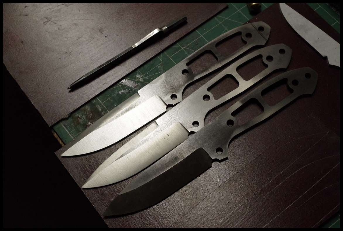

Just working on some Elmax :)
