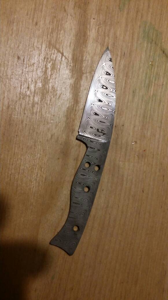

Going to try making a lock back out of a slip joint I messed up.
I think your lock notch is too far forward.
Hoss
Thanks. Going by a book I read It said to have it as far forward as possibly to increase the lock strength. I also need room to clear the washers. I agree that it looks goofy and will learn something from this build. I've only been making knives for 15 months, done two friction folders and this is my first real folding knife. I expect to screw up.

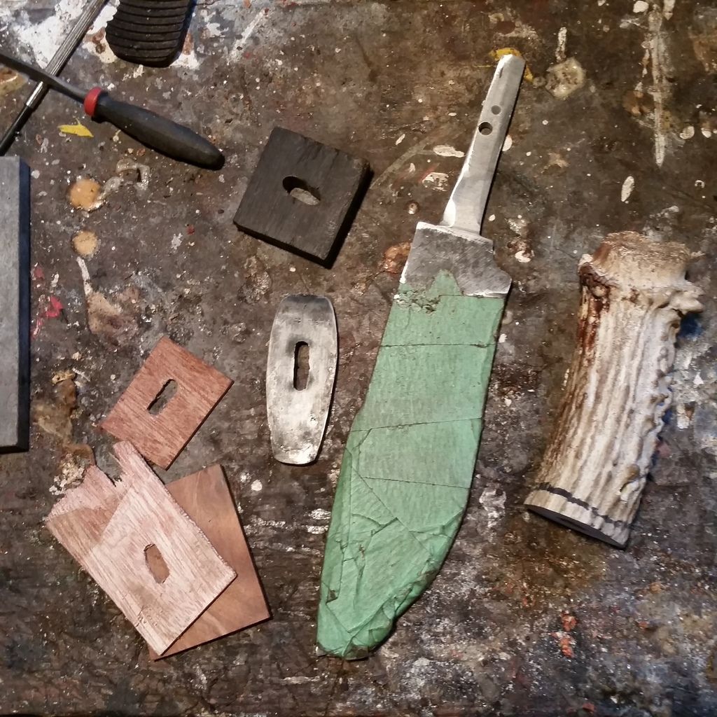

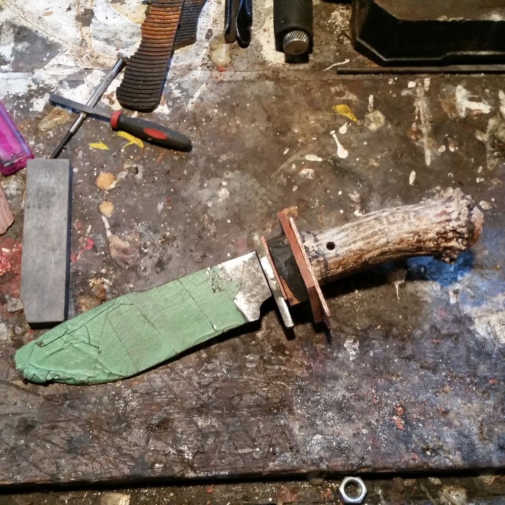

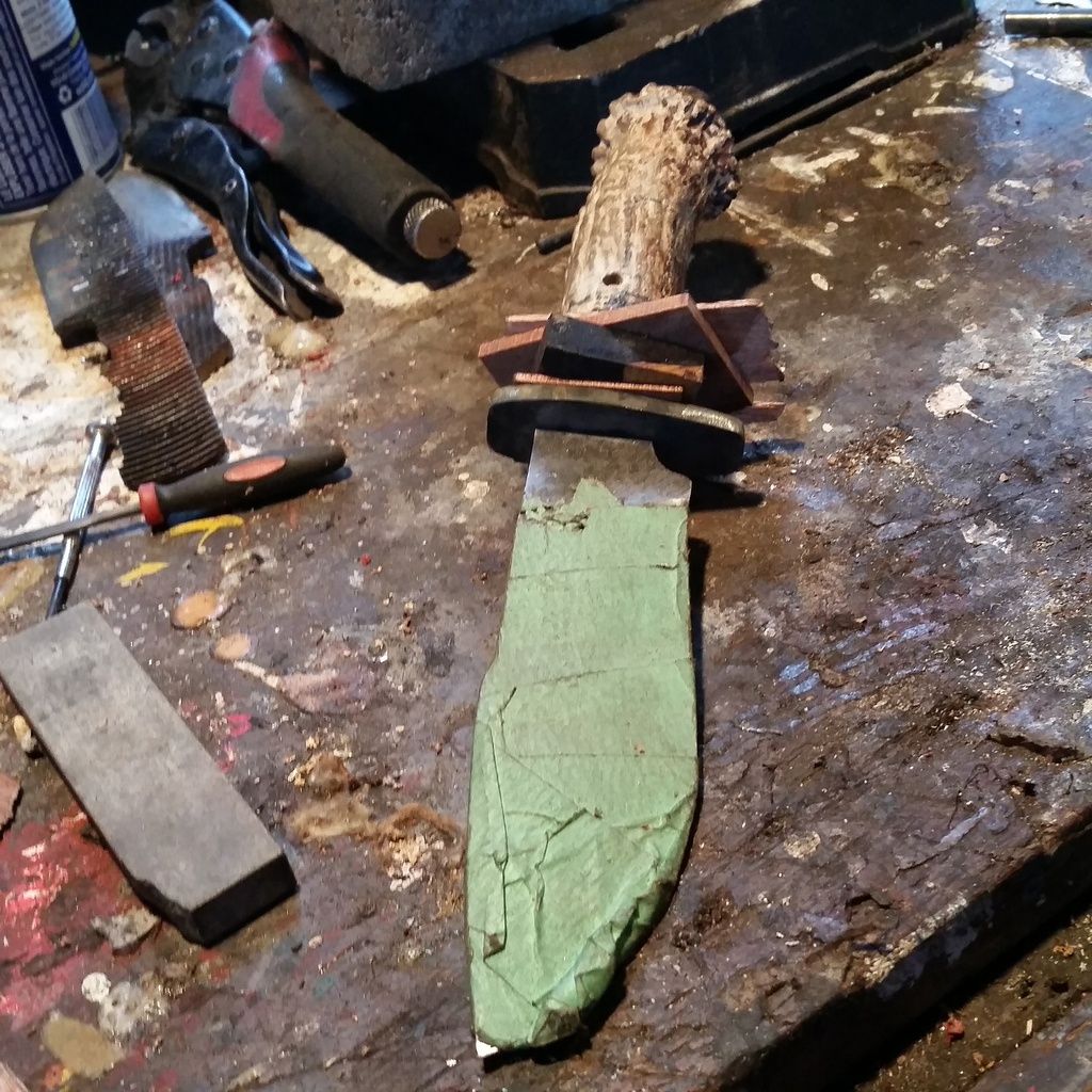

Finishing up this hunter with my second hidden tang to date. still needs some work, shoulder isn't flush with the guard yet, it's hard to make them level and even! I've been told as well to put a curve to where the tang meets the shoulder too, although i think at this point with this one it's about that 1/2 millimeter more to push the guard into place and level out the shoulders
the hanldecomponents are deer antler , african blackwood, thuya burl, and mahogany. i'm wondering the best way to go about shaping the handle, either before i glue/pin it or after. Anyone out there have a sugestion on which is the better course?

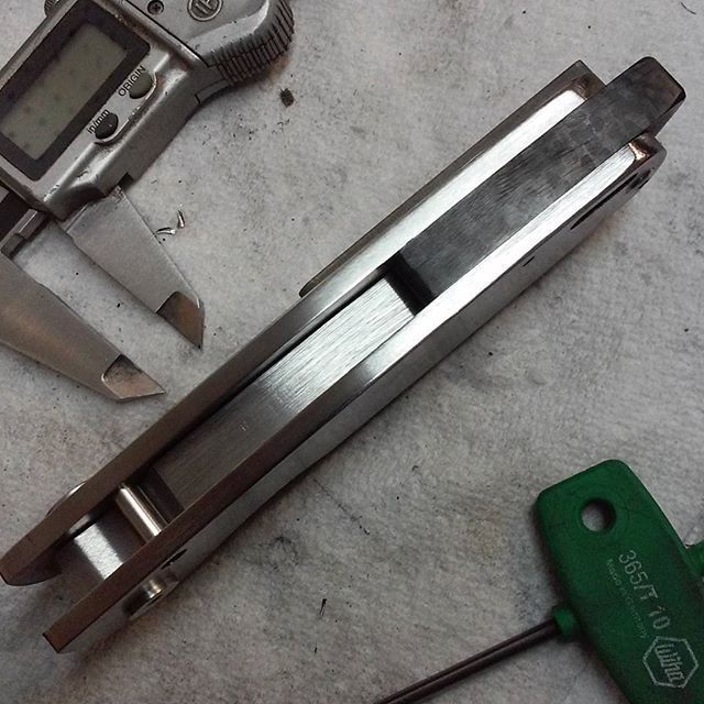

Blackwood Carbon Fiber extended backspacer ground flush. This CF is cut on the opposite bias and I think it looks great! Milling and more sanding is next.

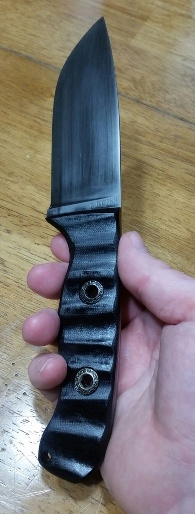

My buddy wanted all black everything.
1095 acid etched, black g10.
