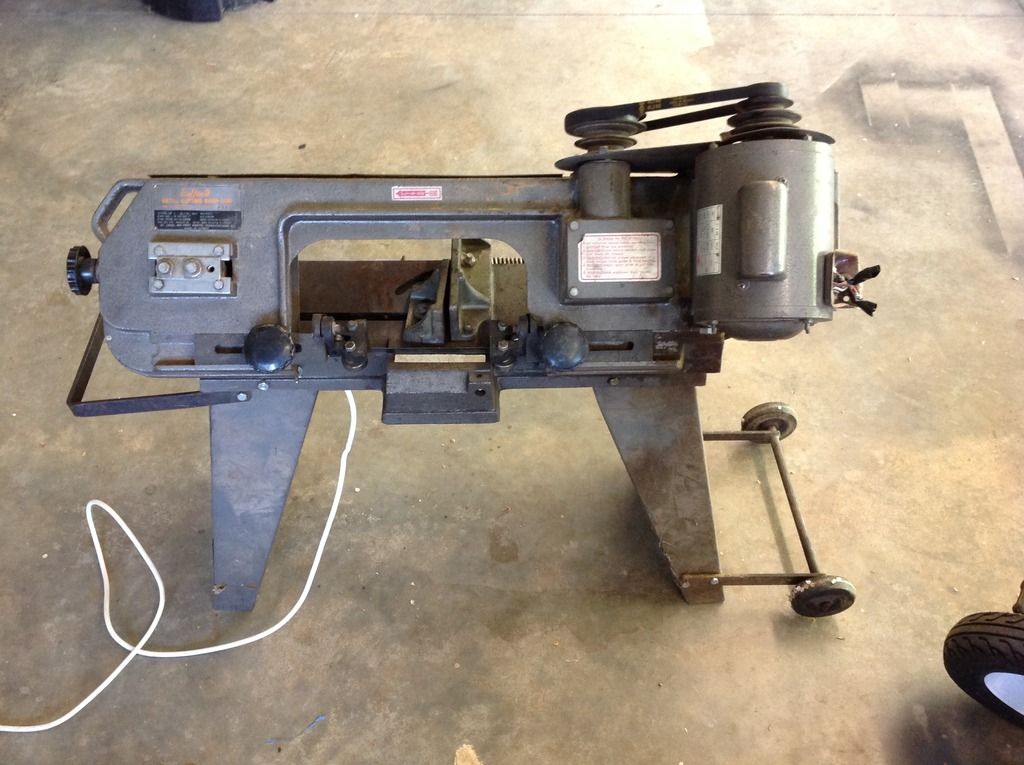

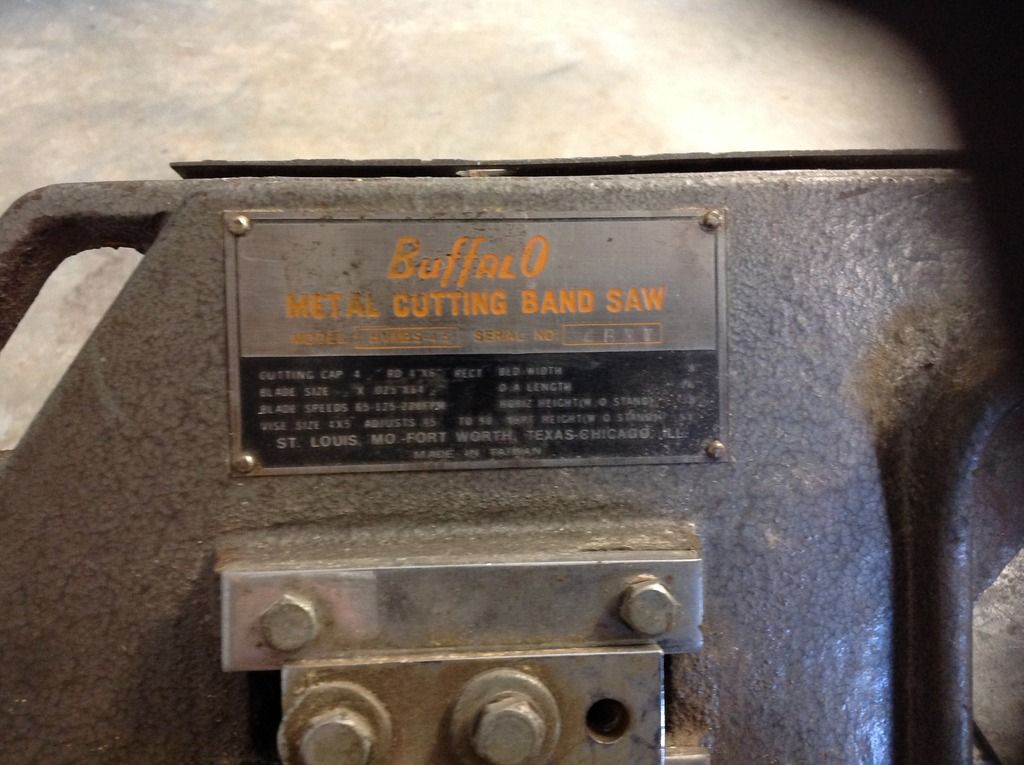

So I finally picked up a metal bandsaw and now I have everything I need(not want) in my shop to make a knife from start to finish! Another maker had it and I picked it up for $40. The legs are pretty flimsy so I will build a base for it but this sucker is a beast. It's pretty old but well built. It's also got step pulleys on it. Any recommendations on what speed to run it at?
I don't think you're supposed to exceed 200 FPM or you'll burn up the blade but I run mine as fast as it will go. It doesn't run super fast even at its fastest. Experiment a bit.
This ^^^ Possibly the middle pulley, You want fast for a wood saw and slow for a Metal. This looks is the original design that Harbor Freight copied in mainland China. 64 1/2" blade, Get Lennox Bimetal blades. 14TPI is what I like.
I use the middle pulley on mine as well though I don't plan to cut anything but wood with it. Very nice tool to have especially if you buy handle blocks instead of scales.
Thanks p the advice fellas. I already have a 14" wood saw but was having to take my bar stock to work p cut out blanks. The saw at work also takes. 10' blade that is $50. I'm sure the 64 1/2" ones will be cheaper.

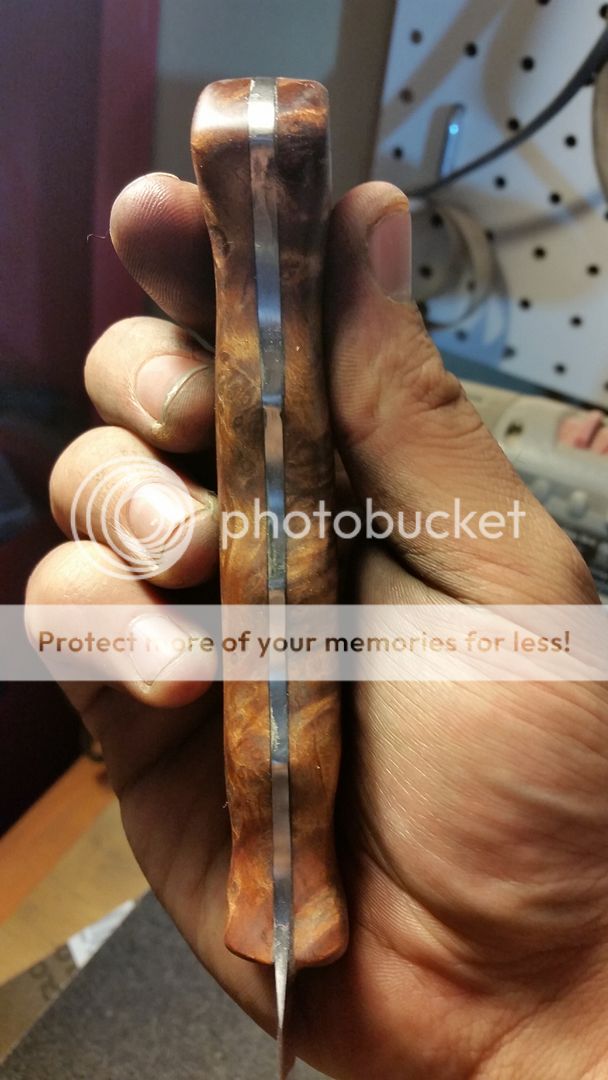

After many reworks, cussing and bleeding here she is.... I have birthed my first 100% start to finish knife and I am stoked at the outcome. Persian fighter with the 1080 blade hand sanded to a 800grit near mirror. Handle is Redwood Burl with brass pins and I must say she feels real good in the hand.
Great first knife!
