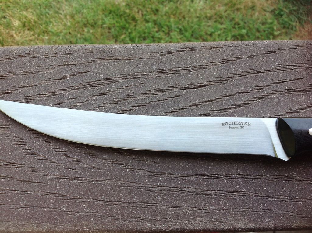

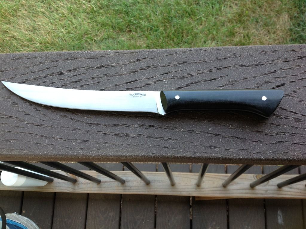

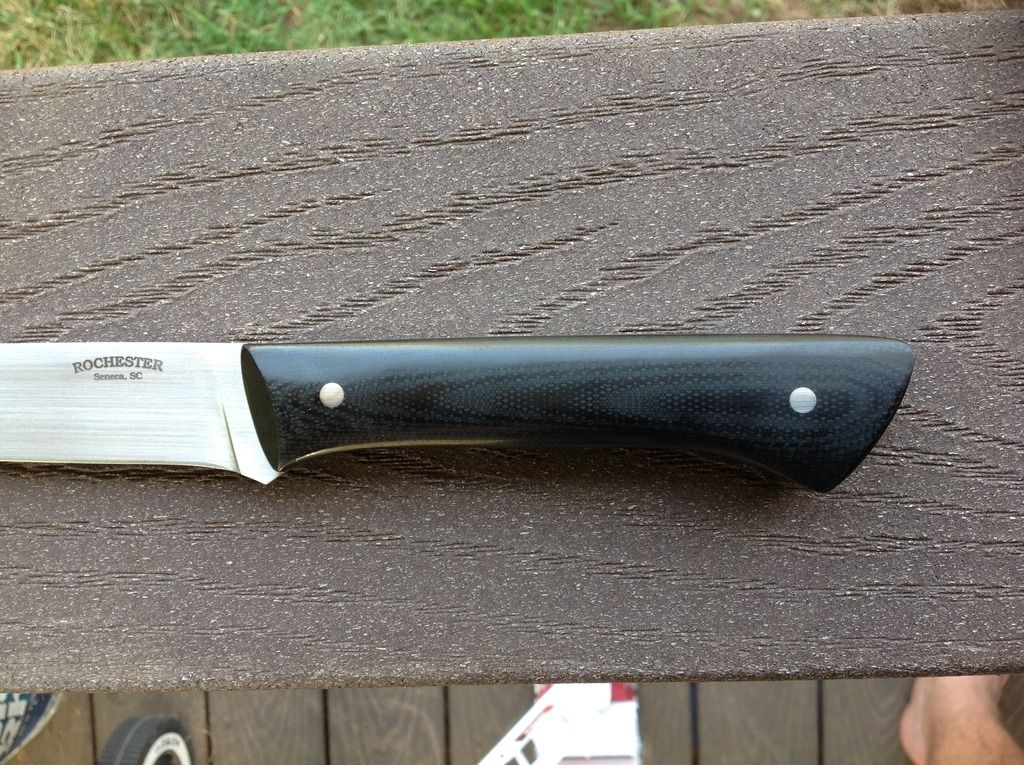

This is the first knife off my new grinder and the variable speed makes a huge difference! It's an 8" butchering knife in AEB-L at 61rc. Handle is g10 and it is wicked sharp! I really like this AEB-L stuff! Pay no attention to my foot!
Very nice work Matt! I'm hoping to be in the new grinder club soon. Here's my first attempt at a blade finish. Ferric chloride for an hour and wet tumbled in stainless media for an hour. Turned out pretty well but I was hoping the tumble would be a little more dramatic.
