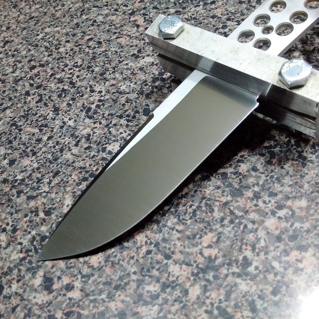

Man I'm LOVING that 29 piece
Beautiful work Josh!
Josh,
Its Basically a dyed Plywood or Laminate, The can come in many different colors and mixed.
Many places sell it I think some of the trade names are dymondwood & Pakkawood. I personally stopped using it because many knives from Pakistan have it.
Do wear a respirator, It can release formaldehyde if you get it hot when working it.
Cork belts give a nice finish, Have you used the Scotchbrite conditioning belts? I use the Scotch after the cork.

Thanks Laurence,
I bought a bunch of random supplies from a knifemaker that was retiring. He did say some of it was dymondwood. I do wear a respirator, but I could still smell an almost perfume odor when sanding this stuff.
I used the scotch-brite before this cork. Maybe I'm doing it backwards.
I bought a brown course scotch-brite which I never use anymore (seems too aggressive and washes out any crisp lines) and now only use the grey ultra fine one.
Thanks for your help and thanks for the Rhino finger skins! Those are awesome.
Thanks brotha!Beautiful work Josh!
Your grinds are perfect, I'm jealous, and I don't think I'm the only one
Sent from my ONEPLUS A3003 using Tapatalk
What's your grit progression to get that finish? You said that it's a satin finish. Do you use a scotchbrite belt at all? Possibly scotchbrite the bevel and then re-sand the flat to establish a clean grind line?
Very nice grinds, as usual
