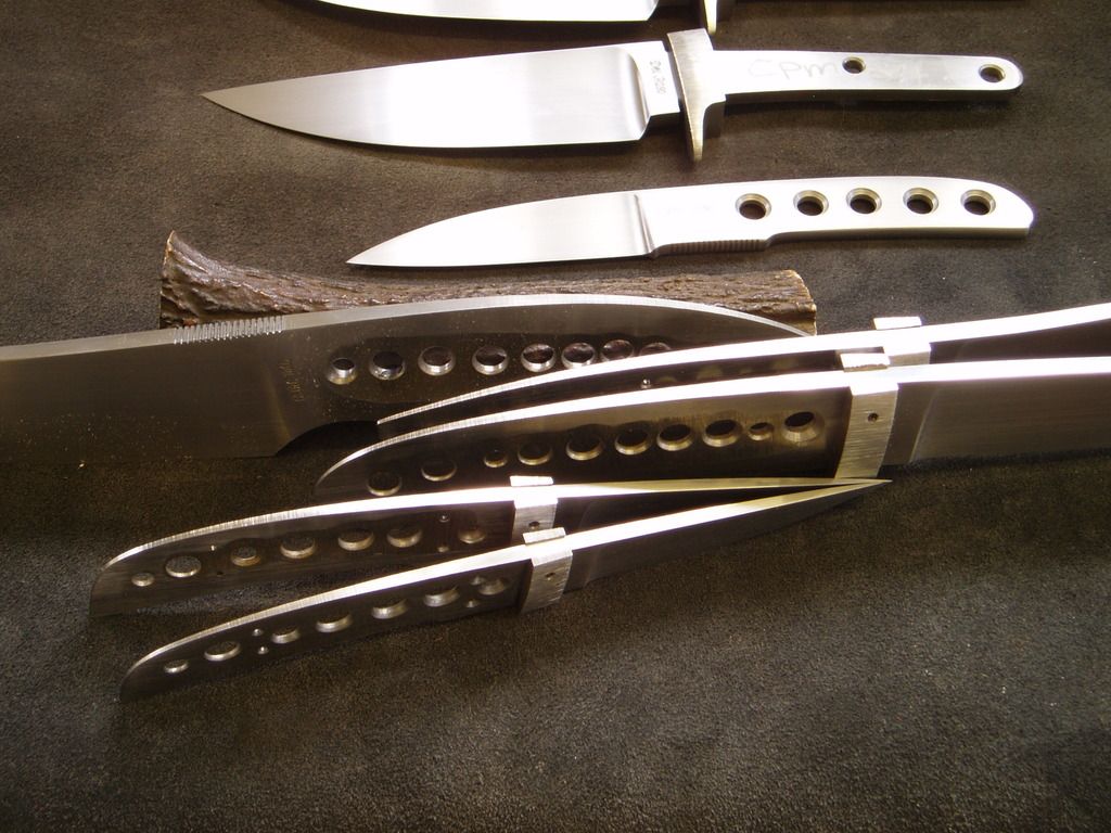

Working on a small batch of 17 right now. These are on a small four foot plastic table. I can then move them around to various places in the shop as needed. I do all my blade grinding and handle shaping outside so this table just trots along with the grinder work bench when I roll it outside. Looks like this table has seen a couple of knives glued up over the years.
Of the 17 these have bolsters and are done separately. Here the pins are drying.

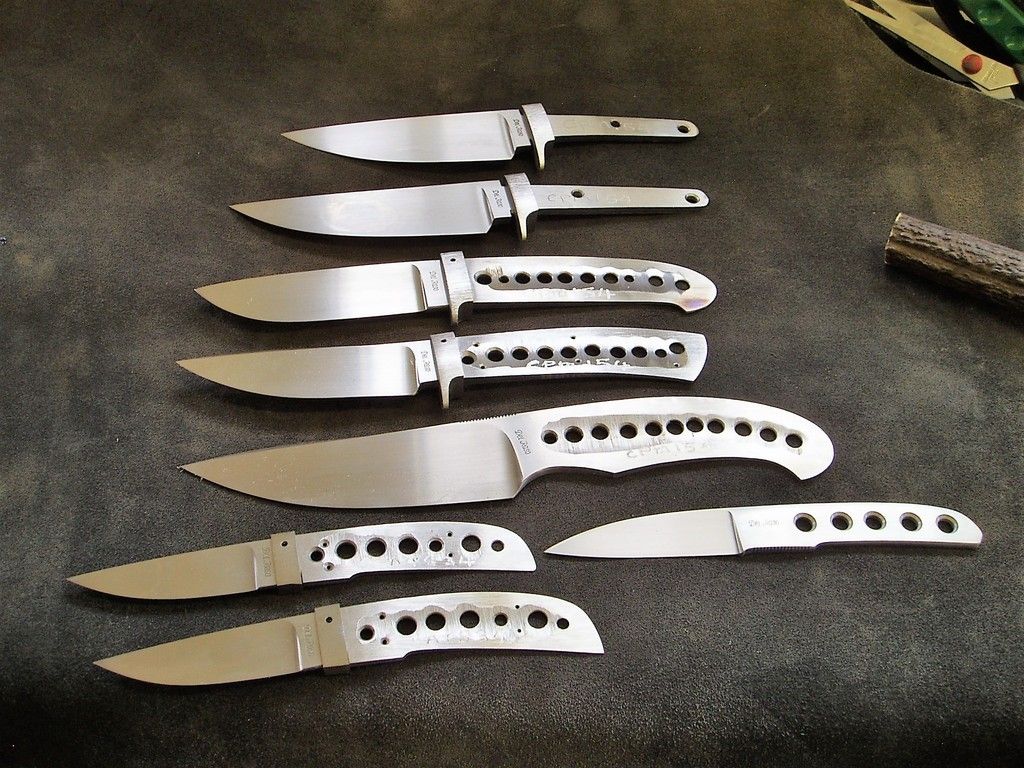

Here's the six without bolsters. While the pins were drying I took this six to this stage. They've gone through the grits from 60 to 120 to 220 all on belt. The corners of the handles were knocked off on a 60 grit spindle sander. The real dark rosewood and the two camel bone handles were also given a pretty good coat of superglue and allowed to dry overnight as they have open pores.
Now everybody is caught up. The handles have been belt sanded up to 330 grit and the tangs and spines have been finished up to 600 grit.
