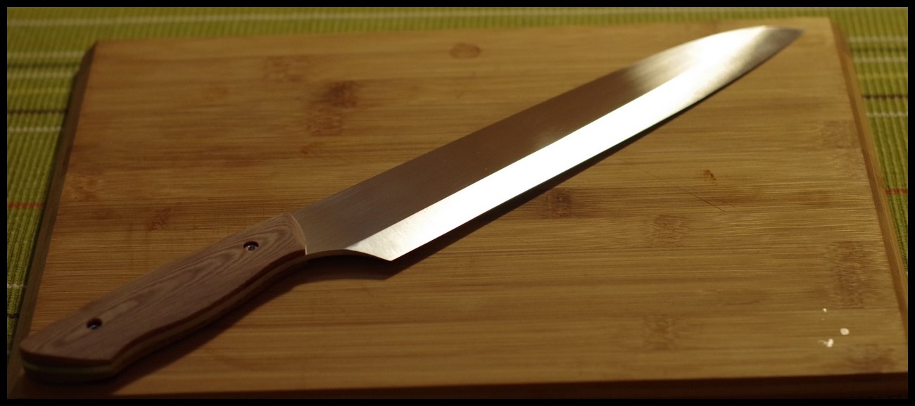

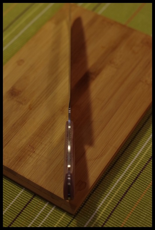

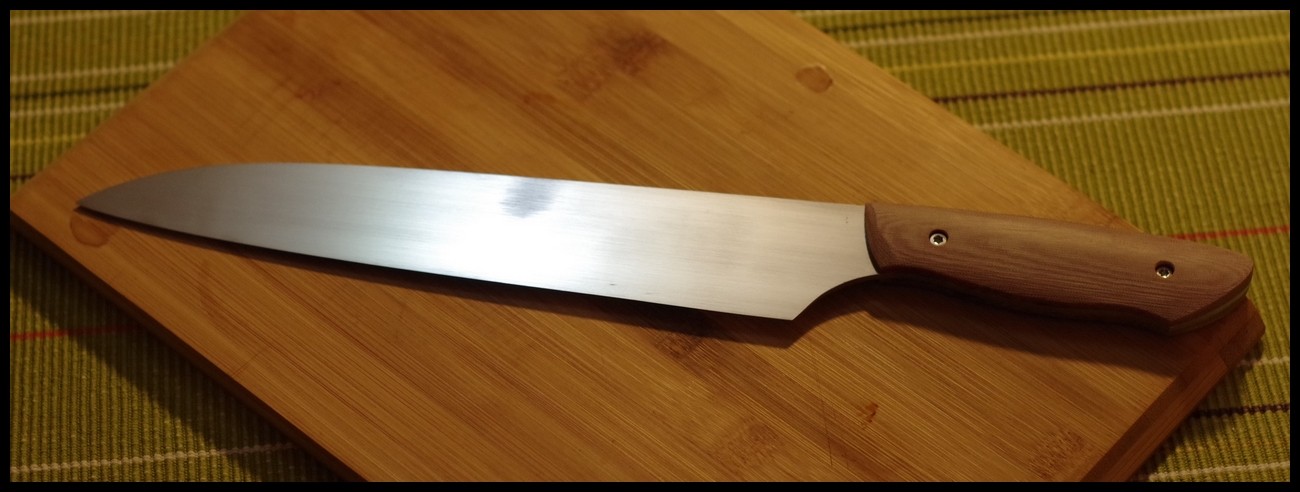

Really trying to focus on geometry on this 8" chef knife. Pretty happy with where I'm at. Edge is almost zero.
Profile shot
Spine shot
Heel shot

That looks good. Much less belly than your earlier example I commented on. There are differing perspectives on this next point, so take it with a grain of salt. I tend to let the handle follow the spine, rather than drop at the heel. This gives better knuckle clearance above the cutting board. It looked wrong to me when I started making kitchen knives, but now a drop looks wrong to me.

I appreciate any feedback I can get. Most of the time I post on here hoping somebody will point out something I can improve on. I changed this design a couple of times to improve knuckle clearance. I'm sure what you're saying would improve it even more though. Honestly I really like the ergonomics of this one and knuckle clearance for my medium/large hands is pretty good. I heat treated a few more blanks in another design. The handle drop is quite a bit less on this one. Mind if I ask your thoughts on this design? Thank you!

That would be the max drop I would use. I tend to use less belly than what you do, but that is a personal preference thing. This will be better for a push cut, and a flatter edge will work better for rocking cuts. Intended use matters.

OK I'll keep that in mind. Always trying to improve. I always considered more belly to be better for rocking but I'm probably mistaken. Thanks for replying!

In terms of rocking, too much belly means too much lift at the handle. I tried a number of curves to see where my comfort zone for lift is, and used that. It's much less belly than you imagine looking at the profile.

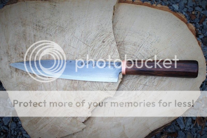

Since folks are posting kitchen knives as of late...
Just finished and shipped this one.
[video=youtube;v9zgQWM5pEw]https://www.youtube.com/watch?v=v9zgQWM5pEw[/video]
