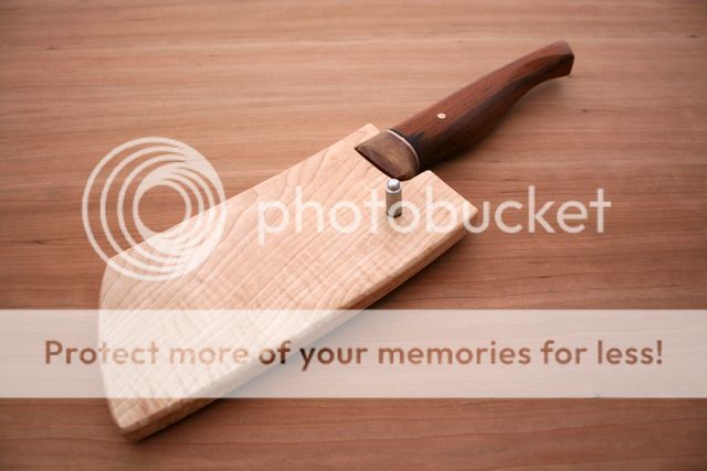

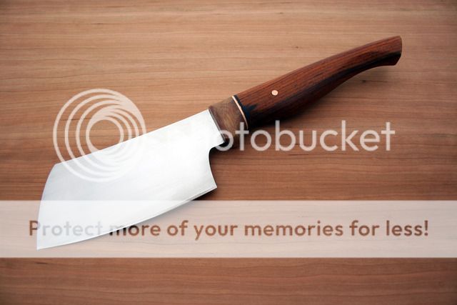

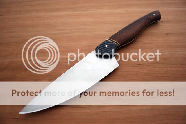

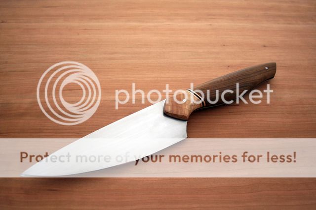

Here's a Santoku that I finished up today. The blade steel is S35vn, handle is stabilized curly maple, with mosaic pins.

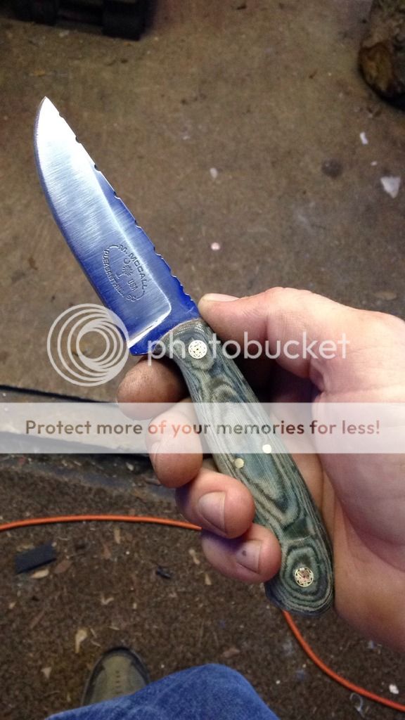

So this is knife number 6 and I can so tell I have a long way to go in all aspects. This Aldo's 1084 and handles I made from digital camo. All in all I guess I should be happy it is my best one yet maybe I'm expecting too much of myself at this point. But I do see where I need improvement. Was going to do a forced patina, but that didn't work out at all. Need to get slower glue for the scales, get better at shaping and sanding the handle and pretty much everything else. Def not as easy as it looks.

Is that dykem still on the blade?
No that's the reflection of the roof of my "shop". A blue tarp. I must say I think I have the toughest shop ever made with 2x4's and tarps. It made it through Mathew and the 150 year old oak tree 30foot away is on the ground.

AHHH ok I got ya man. It's pretty spacious though so that's nice. Your knife doesn't really look bad maybe a higher grit finnish on the handle.
CCA: those are nice I like that satin blade finish. What grit is that?

Thanks Valknut. Well I botched the glue job on the handle. Need a slower glue. Had a hard time getting the pins in once the glue was on. Forgot to tape the blade and have some scratches right at the front of the handle on the blade. Got too ambitious with some file work on the spine I don't even want to post an image of but its a gift for a friend sooo.... I need to get better a shaping handles. As far as the grit m, the handle is up to 400 cork and didn't want to go too fine as I know it will be used in the field probably quite frequently in Oregon so didn't want it like glass. It feels good in your hand when wet.

Usaknifemaker has some 30 min slow set epoxy for like 8 bucks I just grabbed some of that yesterday. Well unlike some other people at least you know where you messed up I think Thats important step in learning
Yeah, I've been using the cheap 5 min gorilla epoxy from Home Depot. Time to order some. After today I don't want to run into this again. I used up all of the handle material I made on this knife. I had already messed up one set of scaled shaping them and this was the second set. Live and learn right!!!

I see improvement over your other knives. As long as you are moving forward, that's progress. Not getting ahead of yourself is sometimes difficult to resist. Make sure the blade is COMPLETELY finished before moving on to handles. Wrap it with some manila folder or cardstock and then wrap with tape and move on to handles. I don't know if you have hobby shops near you, but I get Bob Smith slo cure (30 minute) from my local hobby shop and I have been very pleased with it. Just my 2 cents. Keep at it.

Thanks Kevin. As a matter of fact I have a Hobby Lobby near my work and they have that according to their website for $10.99, and that's a lot more epoxy for the money..
