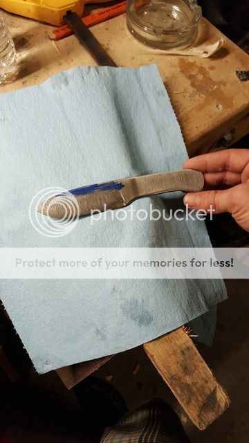

A friend wanted to make his own knife, so as he was working on that I thought, you know, that would look good 2x as long, and made myself one to test a few things. 1- 80crv2 with a very fine edge as a chopper, 2- how durable my home made Alumilite honeycomb scales are and 3- cork belt finishing and 4- Rick's "plunge grinds are over rated" :D. It cuts like a laser and so far no deforming in chopping even though the edge is backed up by maybe .015". 60 RC.
Adam, that NY sneak is awesome. Your grind looks perfect and your ergonomics look extremely comfortable.
Kuraki, those homemade honeycomb scales look exactly like the store bought version. Nice work!
