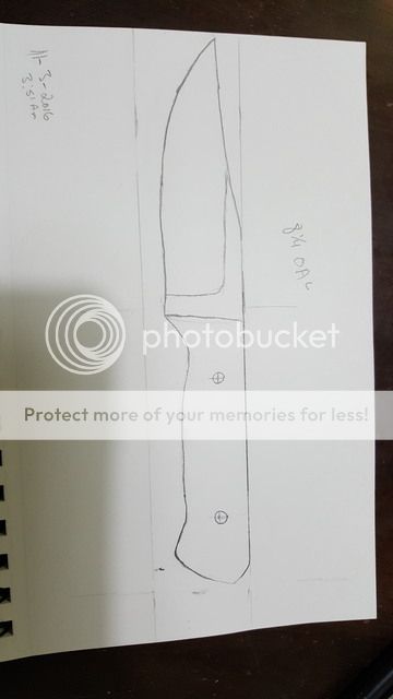

Hahaha that's a great idea! I'm having to go guy feel I don't understand how guys can look down at the knife and actually see what's going on. I took JT advice and sketched up a bigger knife

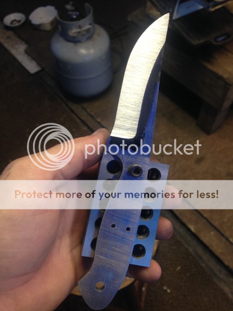

Not sure what you're using for a grinder. When I grind my bevels, I level my tool rest with a digital angle gauge to zero and tilt my platen to the angle for the bevel. I bolt the blade to a 123 block and slide it along the tool rest. This gives me a large flat surface square to the tool rest on the blade. To grind the other side all I do is bolt the 123 block to the other side of the knife. I use a pin hole to bolt it with, or drill an extra hole in the handle. Easy enough to keep square on both side as I line the plunge line up parallel with the edge of the 123 block.

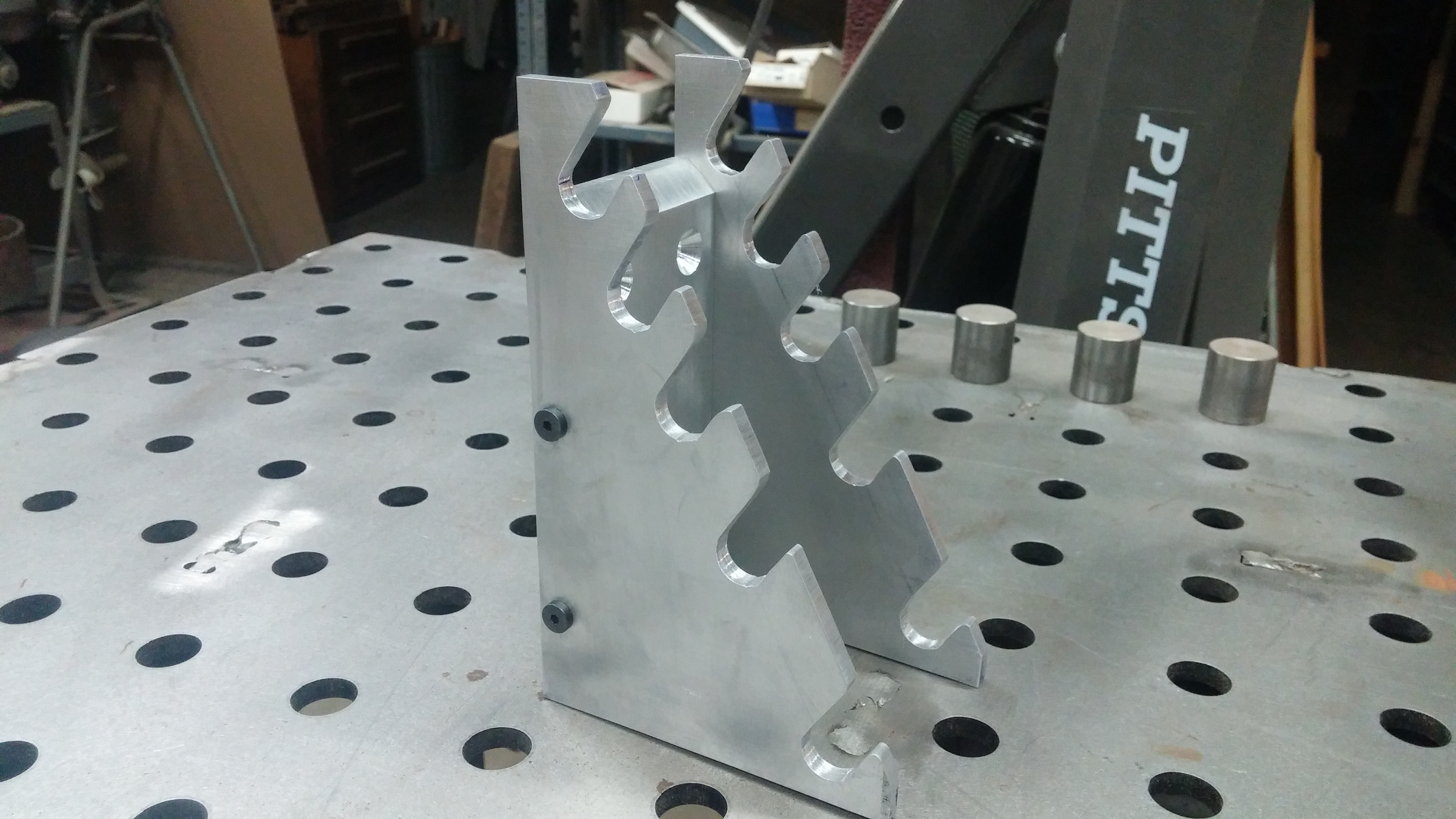

First contribution to this thread and thought I'd share the Small wheel Rack I just completed and mounted to my grinder bench.
and Mounted
