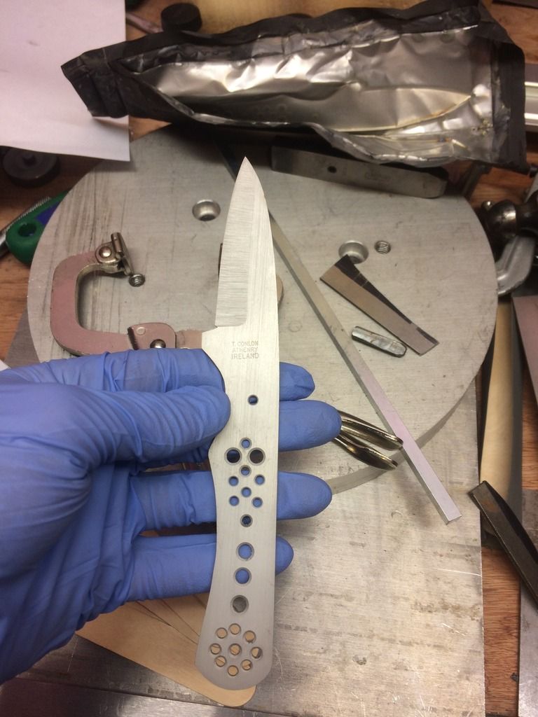

Heat treating these today.
I'm only gonna take it to 400gr that's why i stopped at 220
then take it to 400 or even 600 pre HT
Cleaning after HT with 600 and then a few moves with new, sharp and dry 400 gives a nice, clean 400 finish
Removing 220 scratches after HT is a pain in the you know where

I don't have any 600 gr. But I'll definitely take it up to 400 then.

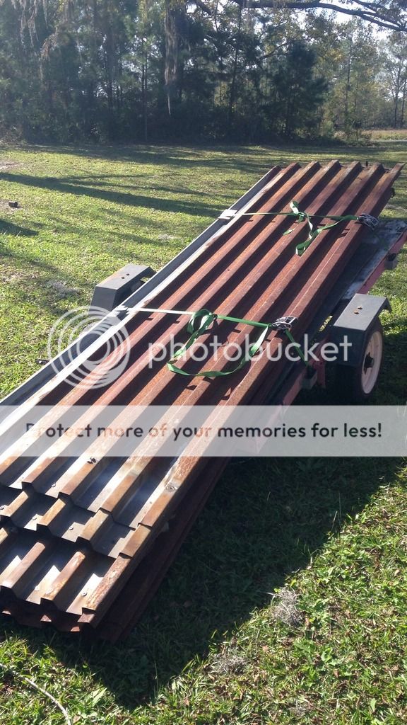

No exactly going on IN my shop, but going ON my shop. Finally getting a REAL roof instead of a tarp. A generous man down the road a piece that lost the roof on his shop during hurricane Mathew gave me enough steel to put a real roof on mine since he put all new steel on his. Supper stoked about this as I have had to replace the tarp on mine 3 times in the last year. I'll feel a lot better about calling it a "shop" now as well as protecting my tool investments.

That's awesome man you gotta post some progress pics!
Maelstrom ok thank you I will do that
