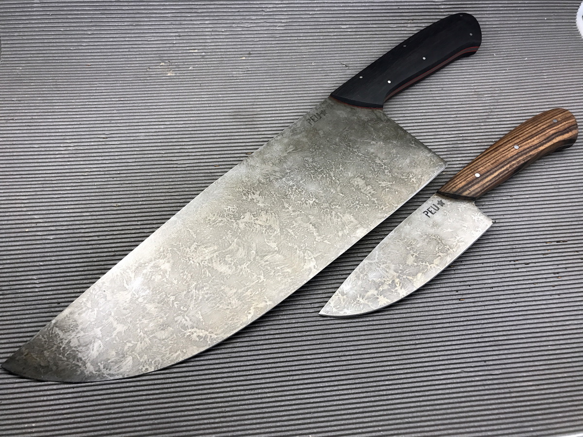

I apply carbide first then sharpen. I like to build up a burr with 120 grit then skip right to 1200 to lightly refine the edge... after that I hone the reverse burr with one light honing pass then a couple passes on the bevel. After that I like to strop with a leather belt, sometimes a scotchbrite belt or even better push through the edge of a phonebook/cardboard to just remove the burr. The knife will be extremely sharp and cut very aggressively with this edge.
You don't say no to a good customer unusual request... a monster knife... :D

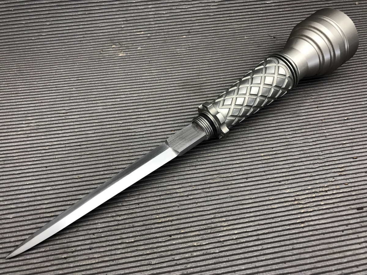

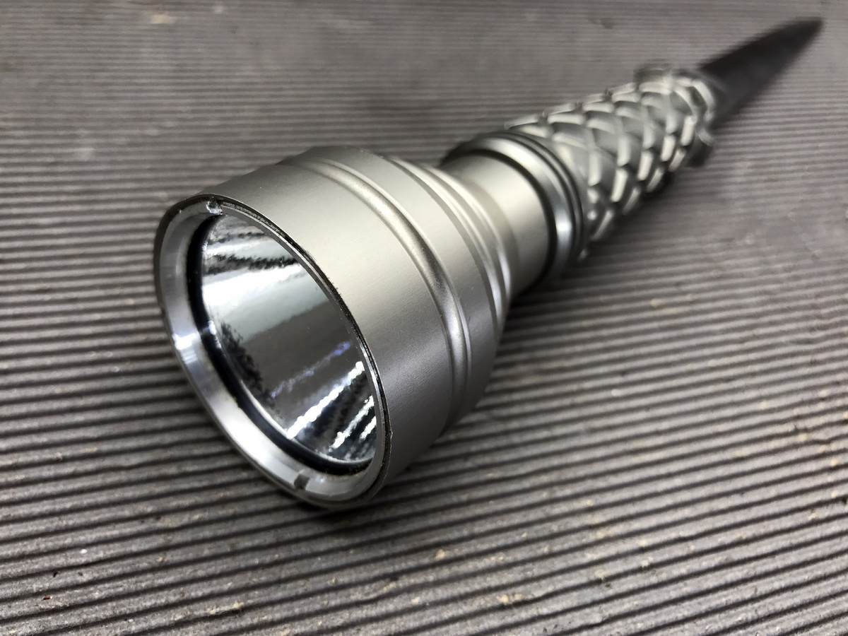

Yesterday here in Argentina was the "Dia de los Inocentes" same concept as April's Fool day there in the USA, so I presented this contraption to my social networks followers :D
The flashlight is an actual product I made about 10 years ago for flashlight collectors (@ candlepowerforums) and the dagger was made out of a file and its currently sitting unfinished at my bench, a little photoshopping and sillyputy to keep everything in place for the photos and Voila! :D

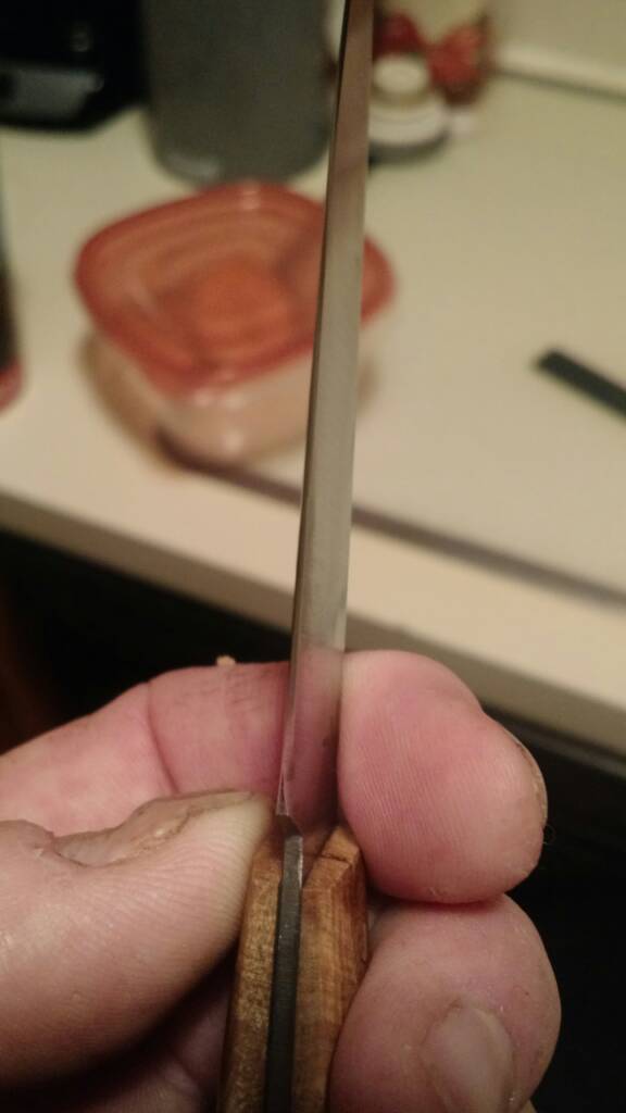

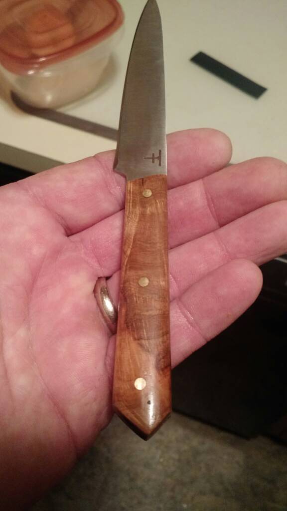

Finished those six paring knives I was working on before Christmas. I kept this one for myself since the maple scale had a small crack in it. Thanks to everyone who helped me figure this one out. I will be doing more kitchen knives in the future.
Kevin that looks great! I better not let my wife see this one or she will be after me...
