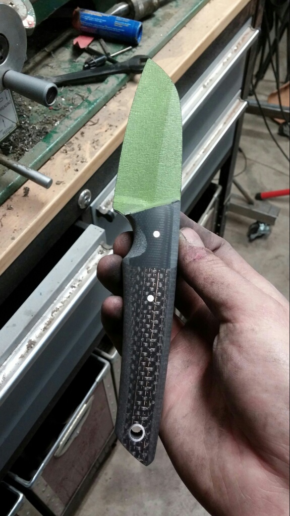

Working on a 7.5" kitchen knife for a friend. 440C with cocobolo and a carbon fiber for the handle

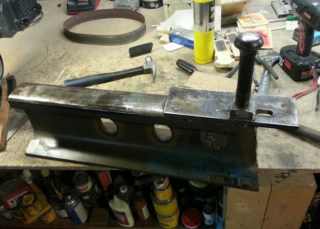

Between Pinewood Derby cars for two boys, 14 birdhouses, and making a chainsaw cut log/candleholder centerpiece thingy for cub scouts I have hardly even seen fit to say I work with steel at all these days. I do have several blades sitting in a holding pattern as is typical, but even the usual car/motorcycle work and knife/tool repair work is slacking. Sheesh. You guys are making me feel like I've dropped the ball.
But, I did have time to finally make a tool for the shop. Last year my Grandfather-in-law decided he needed his anvil back. Why? I dunno. Not like he actually uses it, but of course he won't sell it either. And I had given away my post anvil to another maker. So I was relegated to using a section of rail, flat plate and such for forging. I broke out the welder, grabbed my longer section of rail, a chunk of AR-500, and a RR bolt and nut and went to work. I used the RR bolt and nut as I have a whole 5 gallon bucket full of bolts, and can make dies with them and attach them easily.
It's odd looking, and ugly as sin (but the welds are clean... yessir...) but has surprisingly good rebound. Not quite as snappy as the anvil, but darn close.
Here she is in all her ugly glory...
The overhang is going to be angled down into a quasi-horn as soon as I can muster the nerve to grind on that AR-500...

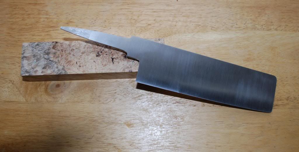

You guys have some amazing work in your shops! Here is my humble attempt at a Nakiri.
Steel: .08 AEB-L @ 61hrc
Wood in the background: Heavily burled Box Elder
I don't know what a Nakiri is, but that sure looks like it will be a monster in the kitchen! ;) :D
Eric- That's odd he took the anvil back if he won't be using it. It is what it is eh? LOL So what is your plan with the RR set-up you've got going? Do you plan to use the bolt as some type of stake anvil?
