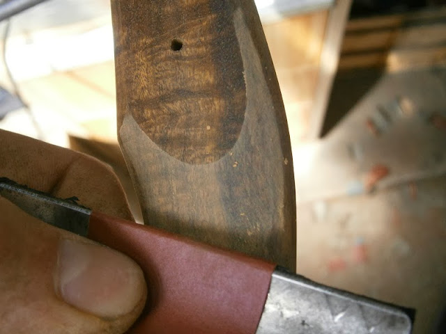

Here are some handle shaping photos I took a while ago:
Refining the shape with a narrow and shaaaarp file. I took it pretty close to the line and then switched to sandpaper for more fine tuning.

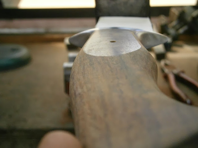

The geometry is all set. From here is was all about refining the surface finish.
Looks to be at about 600 grit.
The whole handle is at 800 grit here, ready for 0000 steel wool, and then oil.
