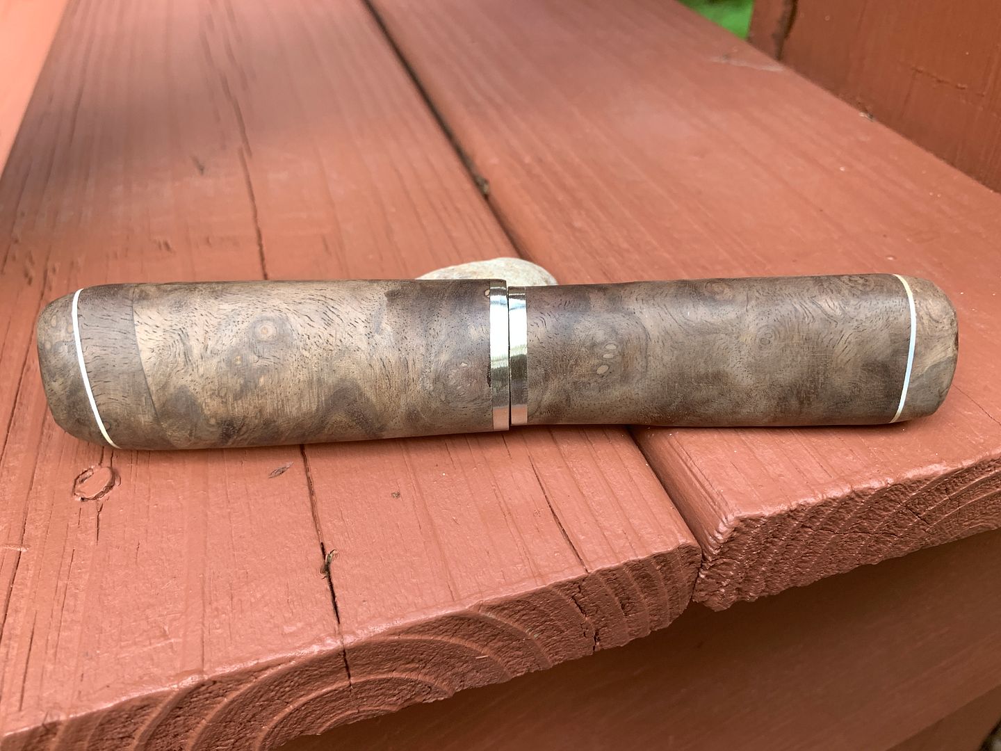

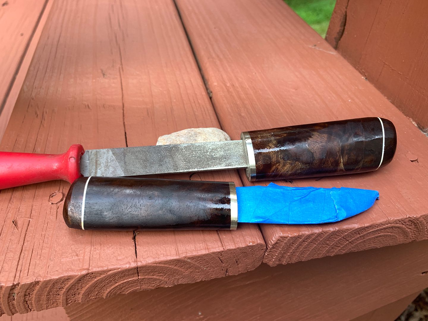

Freshly ground redwood burl. Still warm
We go from 180 to 220 to 400 in a couple minutes then slosh as much TruOil as possible as quickly as possible. Stabilized wood is worth the price but this find was a gem
Stabilizing with 50/50 TruOil Spirits baths
3 coats and its asking for more

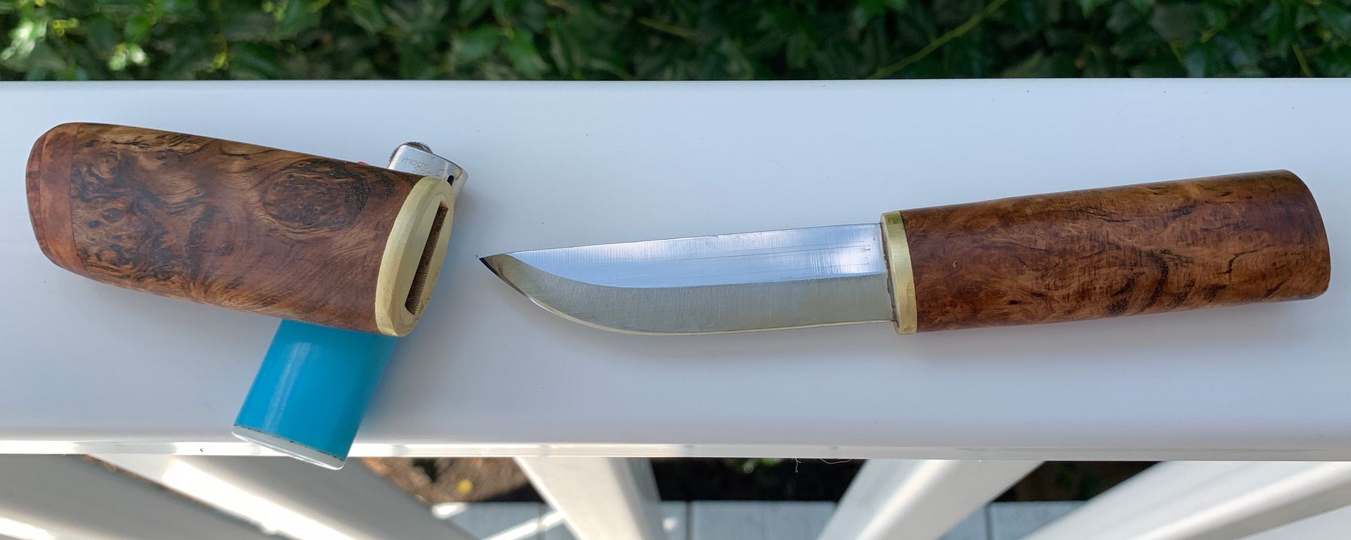

Working on a 40th birthday gift for my hunting buddy. A skinner in .14" RWL-34. Blade is a around 5 1/4". Brass guard and redwood burl scales to be fitted later on..Sanded to 400 grit so far, and I might just stop there. The blade is actually the first one I ever ground, so kind of fun to give.
